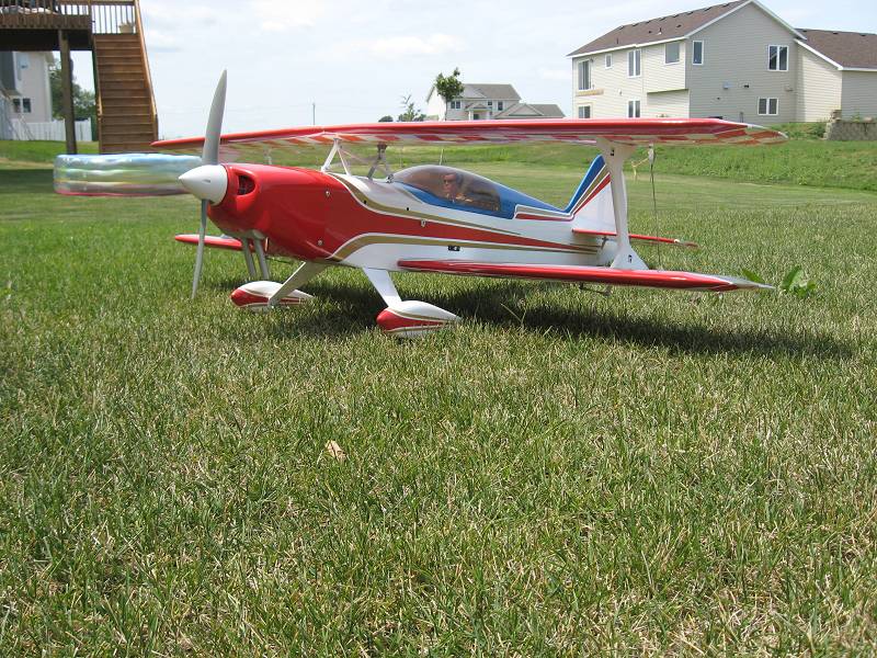

Good info on the props there. I found similar results. I ran mine in the back yard with a 14x6 APC pattern prop, and was getting 10,200rpm with it when leaned out. I am guessing 9800rpm or so running a couple of clicks rich, which is were I like to be.
Here are a coupls of pics of mine. It is ready for it's maiden Monday.

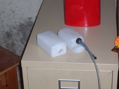

Hi again guy's well i finally got my Skybolt almost finished ,( i hate it when work[:'(] interfears with play ) any way i installed the skywriter smoke pump first try not much smoke at all that was with a O.S. FS-91SII-P with the stock muffler and stock nipple location which is a little far from the engine so i guess it's loosing the heat needed .So i went and got some of the small copper 1/8" diameter tubeing and wraped it around the muffler about 6 or 7 wraps and used fiberglass tape like the kind used on wood burner doors and wraped the copper tube then wraped the insulation with coper doorbell wire and then covered that with the metal duct tape like they use on a furnace now she is smoking pretty good i have yet to maiden the plane because i just couldnt bring myself to fly it without the SMOKE i am going to try and fly it thursday i will try to get some video of the maiden flight.
P.S. : I used two of the DoBro fueler valves one for the fuel and one for the smoke tank filling .
after running the plane a little it would shut off and run eratic !!! Brand new motor then i found the problem is the fueler valve letting AIR to be sucked into the fuel line as long as i put my finger over the fueler valve it ran fine as soon as i removed the finger i could see the AIR BUBBLES start to come and the engine would start to run rough again.
Is it best to just use a pluged fueling line or can this problem be fixed and How do i do it ??
#221
Get rid of those fuelers. I've had nothing but trouble with them. Want some more?
The rings wear and become lodged in the lines, etc.
Use a T connector and fuel dot instead. Much safer.

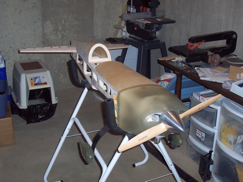

I am building a Super Skybolt ARF. I mix it up with my Midwest Extra kit. The Extra gets priority. I am in no hurry. It is so pleasant this way. Here are the specs on my Skybolt: Saito 91, Futaba 9001's all around except throttle which is a Hitec 81. Battery - Fromeco 2600 mAh LiPo regulated to 6.0V with a MAXX products miracle switch. The first two pictures show the Extra which is slowly but surely coming together. Back to the Skybolt - I plan on fitting a DuBro tank instead of the one that came with the Skybolt. It is almost the same size, and I prefer having a cap which surrounds the opening at the front of the tank. I am nervous of the ARF tank splitting over time. If you look carefully at the wing joiner, there is an 1/8" dowel near the tip. There is one at the other end too. This held the two pieces in alignment as I laminated them together with epoxy. No worries about sliding out of alignment. One more thing - I will mount the engine inverted and use an Electrodynamics on-board glow system with a 3400 mAh single NiMh cell. I'll run a flexible exhaust header.
