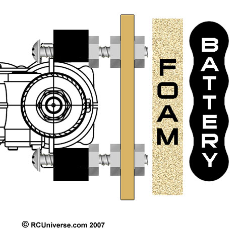

Another way to fit the battery in the engine compartment is to bolt your engine in place with long screws, then add a plywood platform to the back sides of the screws. Clip off any excess threads, add a foam block, and strap the battery to the platform

thanks guys for thebattery mounting tip. I just maidened my new Skybolt! I have an OS .91 2 stroke with JR electronics. I added the Sig tail wheel and I am using 2 elevator servos instead of one. I needed 1/2 lb of nose weight with the battery in the middle of the plane. I am looking forward to moving the battery forward and getting rid of the lead. What prop are you guys spinning with my engine setup? I flew with a 15-8 tonight. The book for the motor doesn't list a 2 bladed prop smaller than 15". The write up on Towers site lists about 10 props all the way down to 12 or 13 ". They recommended a 13-8.. Any comments?

On the kit version, the battery has to go as far forward as possible. It's sheeted balsa all over the plane with no lite-ning holes. No wonder it's a heavier plane than the ARF. MM
