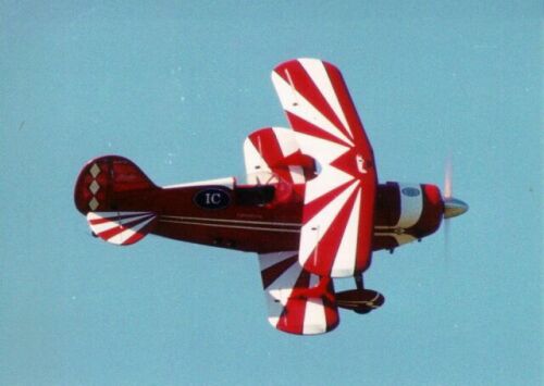

PITTS is going pretty good. Been taking it to a lot of fly ins, flying off of concrete, pants are surfering a little.
About 100 flights or so.
It has been fun to push the sticks all around and see what happens.
Here is a pic from the St Charles Festival of Giants in July.
Know the feeling about going bigger, trying to keep the bipe and go bigger too, but might have to sell her.
Thinking of asking around $1000 w/o RX
What about yours?
