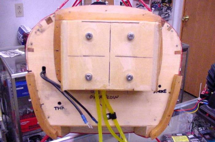

#111
Posts: 1,346
From: Hampton Cove, AL
Goldwing - Unless I misunderstood what you are talking about when you refer to wing mods, G.P. did the wing mods in later runs of the model so you shouldn't have to do any mods to the wings. There are tech notices from G.P. describing what needs to be done if your model does not have 'UPDATED' stamped in red on the wing half end where you apply epoxy to join the wings together. I just checked mine and fortunately I have this stamped on one of the wing halves. G.P. added hardwood for the interplane and cabbane mounts to help solve the problem of screws possibly pulling out of the mounts as a result of using a larger than recommended gas engine.
I would also pay attention to pinning the firewall and then also adding tristock and fiberglass to the firewall and mounting box. G.P. mentions pinning the firewall, but nothing about adding tristock and fiberglass. It's really easy to do this if you haven't done it before.
On my new Pitts II that I am assembling I could actually see daylight between the fuse and the firewall in areas around where they should have a tight snug fit. Not good. IMHO this wouldn't hold a stock recommended 160 let alone a gas engine. I used plenty of epoxy and tristock to reinforce and close the gaps.
The tech notice states that in future runs of the model G.P. will pin the firewall as SOP in mgf. the model. Mine did not come with the firewall pinned, but I have already taken care of this. I think we can do it better than they can anyways.
Good luck and assemble for strength. Use socket heads for the Interplane and Cabbane struts and throw those Phillip heads away. The heads will strip out so easily, especially if you follow the directions and use CA on the thread holes.

Roro , thanks for adding the pictures of your firewall mods. I know your input sure helped me when I was first assembling. Sure got my attention with the idea of beefing up the firewall and making sure all the nuts and bolts are tight. Assemble for strength.
Here is a picture of my firewall after completing the pins, which are the dark spots on the mounting box, and added fiberglass cloth. Also added tristock inside the mounting box forward and aft on the inside of the box. Used Finish epoxy for Resin. Adds a nice fuel proof finish. I brushed it lightly over all exposed wood, including the firewall and the mounting box. Second time around was much easier and actually had fun doing it when I felt confident in what I was doing.

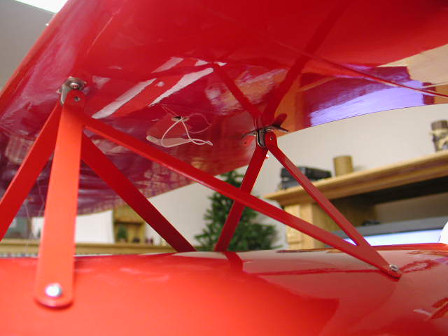

Thanks for the help with the updates. I have and updated kit so much of it does not matter but I will glass & Pin the firewall.
I have a question and I've read the manual and am not getting the picture. On the top wing the 90 brackets "D" say they must be together and they are but the other two Brackets "C" (ones in the back) are not together. I used the predrilled holes and still have a 1/16" gap between them. The Bold face important note only address the "D" brackets. Should the "C" brackets be together? Also my cabane struts don't really line up that well. I can put the bolt through but I can tell it is stressing the wood screws a bit. I think the right side of the fuselage screws are just a bit forward of the left ones. (Maybe a 1/32" or so) See the attached picture.
Thanks for your help
Sheldon

As far as the cabane struts I had the same problem but it did not affect anything. On the brackets not touching each other, that would definately cause a problem. It will either pull the screws loose from the wing when you tighten the bolt through the cabane strut or it will put sufficient stress on the bracket to cause them to break. If it were me I would put some washers between the brackets & solder or glue in place so as not to put any stress on the brackets when tightening the wing to the caban strut.
Hope this helps

I responded to your email just a few minutes ago. I agree with RCISMYLIFE if the gap is significant. I had a gap with the aft brackets, but honestly never had any problem with them holding. Might want to hear from others on this as well.
