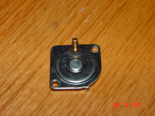

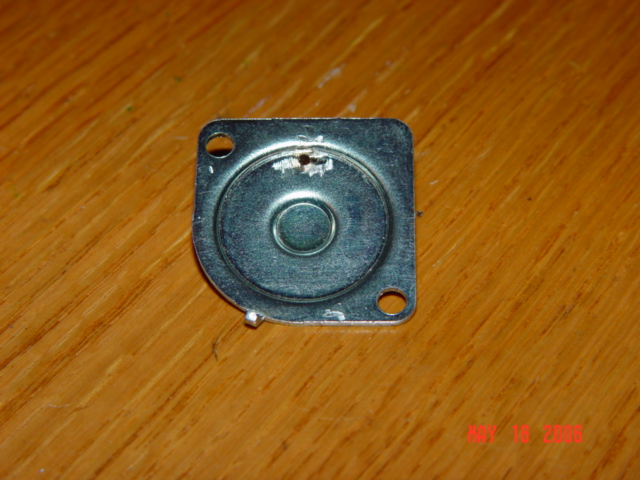

I purchased a Brillelli 25 gt mag afew weeks ago. I had problems with the fuel mixture while in the air popping and bubbling. It
runs good on the ground. After about 12 flights I thought the tweeting was enough. I called Scott from Brillelli and he said it was a problem with the staic hole in the carb causing it to go rich. He said the air current while in the air blowing in the static hole was doing this. Scott said that if I would tap a pressure tap at the static hole and run a hole inside the fuselage it would correct the problem.
I modified my last night and will test today. I hope it solves my problem.

Do you still need the plate I was going to send? Also were you sure to grind the tap flush on the inside? If it isn't it will hit the diaphram and may tear it, or at the least stop it from working propperly. If anyone else is having the same problem with it running good on the ground and going to crap in the air, let me know. I will provide a plate with a tap in it. Many engines do it in certain planes. BME is known for it. They actually sell a plate for $25 to replace it. We are going to install taps on all of them from now on so people do not need to do it. Just hook a hose up if needed.
Scott
