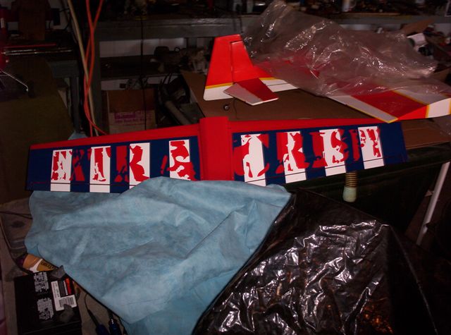

Question, has anyone else had a problem with the vacuum formed parts washing out and shrinking in the sun? My bellypan, fuselage top, and canopy all have shrunk.

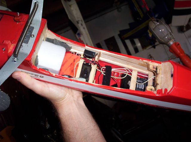

I *just* finished mine. Finished it last night... have yet to fly it in fact. I used HS-81's in mine all around... 5 servos. 2 HS-81's will squeeze in just barely in the wing servo mount hole...which will let you do flaperons on it. Hoping this will help slow it down for landing. I should be flying it tomorrow morning or maybe sunday, not sure which just yet.
I will say one thing.... throw out the stock pushrods. They are complete crap...especially the throttle linkage, it goes through a couple of twists and is very stiff, I doubt a servo would last long pushing the stock pushrods through it. I used a cable in the throttle linkage, just soldered the ends about 2-3 inches on each side to keep the cable from flexing after exiting the guide tube. Works great now. The rudder and elevator pushrods are pretty straight runs, but were also pretty hard to slide the pushrods in, I replaced the factory inner part with a sullivan pushrod of the same size and they work great now too. No complaints with building it, goes together pretty good. Took me maybe 20 hours or so to finish. I put an OS .25 fx in mine, balanced nicely with the batter and receiver just under where the pilot is.
