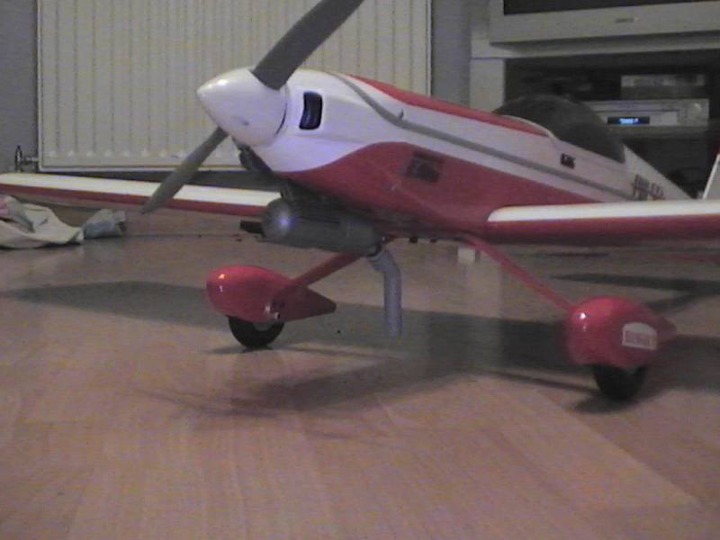

i have picked up a nearly new Pulse XT for £70, inc servos.
it was used for electric, and i'm going to put my SC .46 engine in it from my trainer, but before i mount the engine and hack the cowling about has any one mounted the engine on its side with the exhaust going underneth ?
in the pics ive seem with it mounted upright it looks to protude out of the top quite a bit, especially the exhaust muffler.
should this be possible, has anyone got pics of it done ?

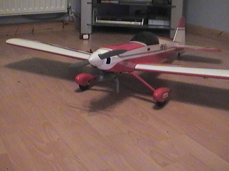

looks like no one has pics of a Pulse XT with the engine turned, so i fitted mine with the exhaust at the bottom and heres a few pics.
excuse the quality i only have use of camera function on the camcorder, must get a new camera.
i think it looks loads better than mounted upright, and glad it took the plunge and turned it, hopefully i should get to fly it tomorrow

Hey- that looks terrific!
I'm almost inspired to take a look into a second cowl and remount my Evo.
Report back on your maiden.
cheers

That really does look like a great idea. I'm mounting my OS 70 Surpass II 4 Stroke, inverted so the lines of the plane will look similar.

managed to get to the field this afternoon, got five flights in before the light faded too much.
what a great plane, not that I've had much to compare it too, but i found it very stable and easy to get used to.
having only flown a trainer before (and shocky) i let one of the guys take it up for the first flight and he was impressed with it, said i shouldn't have any troubles.
A quick refuel and i went off for my first flight with it. it pulls off to the left a bit on take off but is manageable, soon got comfortable with it and was soon doing loops and rolls. it rolls really well on low rates, i didnt even try high rates out. also the engine seems to run better in the plane, pulls quite well going vertical.
i would recommend this as a second plane to any one, i found it to be an easy step to a low wing tail dragger.

I've been flying my Pulse with the OS 70 Surpass II (4 Stroke) with an APC 14-7 prop on it, since about end of September now...I LOVE this plane and engine combo.
Inverted mount, so the top of the cylinder head pokes out the bottom, and it looks awesome. The integrity of the cowl on the top of the plane keeps the lines clean and the head out the bottom keeps alot of airflow across the head.
