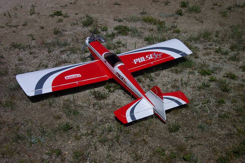

Well i managed to get out to the field this morning and maiden the Pulse.I must say this plane looks to be a great alternative to a 4-star.I have yet to do the lateral balancing and left the wheel pants off until i get more free time,but i must say it flys and tracks very well.The covering scheme is easy to see and she went together without any problems,another plus is the two piece wing.I powered it with a Evolution .46 nt and an APC 11-6 prop.Attached are a couple of pics from the field.

Glad to hear you like it. I've got one in the box that I will build. How does it do in knife-edge flight? I think I'll put a four stroker in mine.

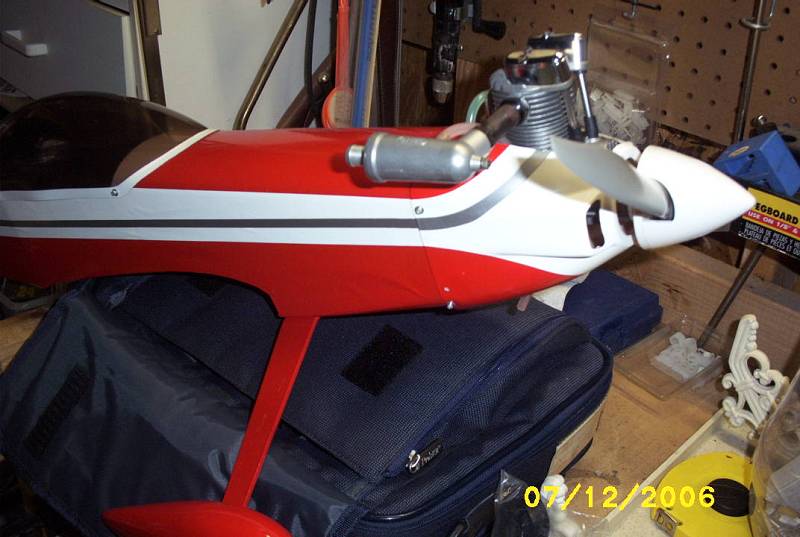

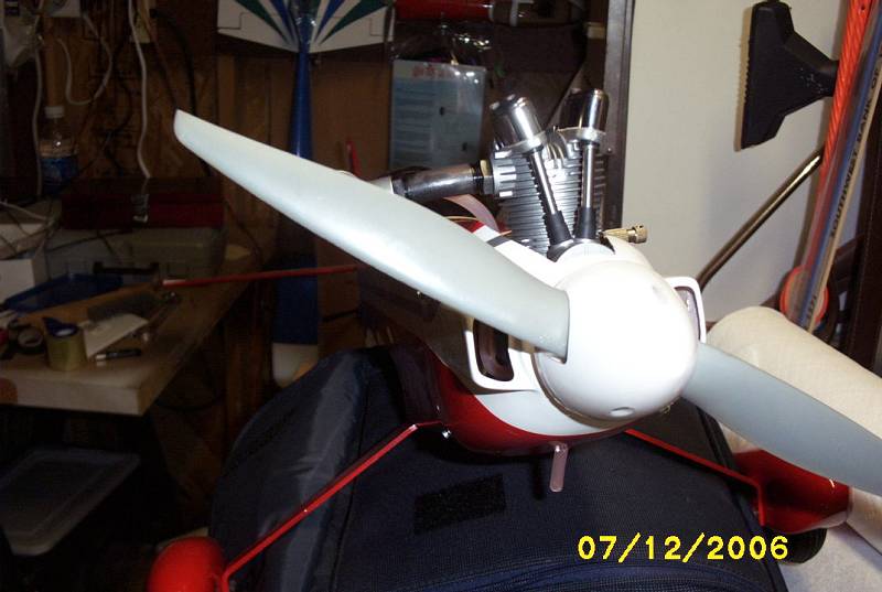

I purchased the Pulse XT for a fun fly plane and because I had a Saito 72 without a home. I was pretty well please with everything up to the point of installing the engine. If anyone has installed a 72 or 82 without some major mods to the engine mount or firewall, I would appreciate your advice.

Thanks, N70R. The Saito 72 and 82 share the same case, so if one will fit, both will. I have e-mailed Horizon to see what their solution is. I'm thinking they pushed their imagination a little bit in saying an 82 will fit. We'll see.

I put a Saito 72 on my pulse and how I did it was to first turn the Carb around so the throttle lever was to the right side of the fuse and then rotate the lever 180 degrees so it points up. After that I took the dremel and cut a small notch in the firewall in line with the throttle linkage and install Sullivan Golden Rod between the Throttle servo and the Throttle. I also rotated the servo output arm 180 degrees and the rod passes nicely above the tank and up to the engine. make sure you use the clips that come with the metal clevices.

Thanks, HughBrown, for your reply. Wish I could see a picture of your install. Using the supplied engine mount will require some modification to get the engine back to the 4" required for the cowl. Configuring my 72 with the throttle lever on the right side and pointing up, the lever is above the fuselage.

Well, guess what, Horizon didn't reply within the 72 hours that their automated initial reply said. Truth is IMOH, this plane was never intended to take the Saito 82. It will be a fine plane for electric or a 46 2 cycle. The fire wall measures only 3 3/4" square which should be an early clue. Oh yes, I'm putting an OS 46AX on mine.

Here are some pics of my pulse with the Saito 72. She flies great and has a great sound.

Good Job, My hangup first of all was trying to obtain the 4" spacing between the firewall and the front of the prop washer. From your pictures, you mounted your 72 as far back as possible and went on from there. Secondly, you have the throttle arm facing down. thanks...
