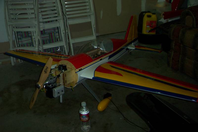

Hello, I also have one of these Yak's from Willhobby.com. It was a challenge to build. The manual is good for starting a fire, that’s about it. I am having a hell of a time with getting the CG set. I am running a SPE 40cc gasser and am going to have to add a ton of weight still. I even put my batteries and receiver up front. Overall, the airplane looks great, hardware sucks, and cowl is very brittle. My cowl was damaged in shipping and Jerry at Will Hobby agreed to send me another one. Haven’t flown her yet, but looking forward to it. Does anyone else have this plane? If so, what did you set your CG too? Thanks

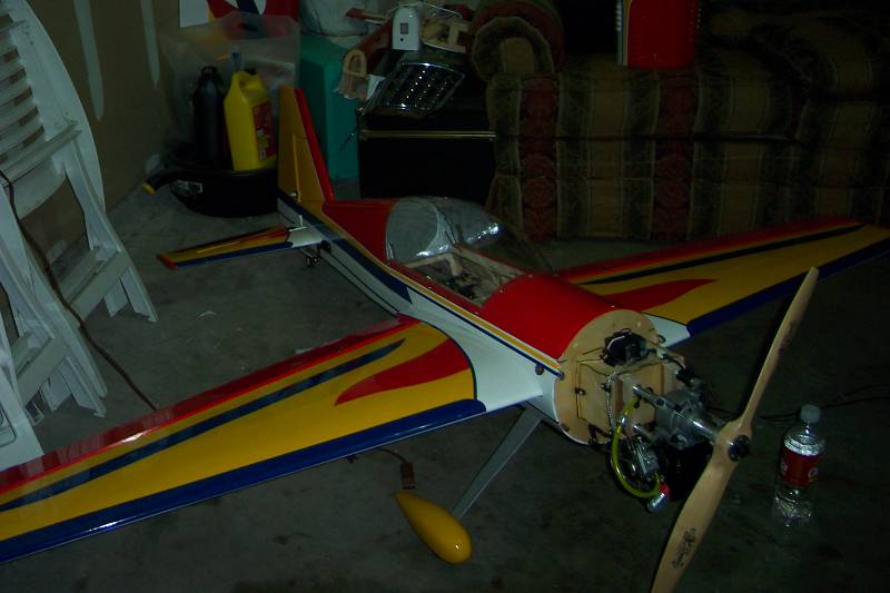

Old 11-15-2006 | 10:27 PM
Joined: Jan 2006
Posts: 319
From: San Antonio, TX
Default RE: WillHobby Yak 54 ARF Question
My camera is not very good, there a little dark..........I will try to get better ones of the engine. What do you think about putting batteries in the cowl with the engine?

Joined: Jan 2006
Posts: 319
Well, I crashed mine a while back due to an aileron coming unhinged. Make sure you don’t use the CA hinges that come with the plane, they are the wrong material. Use some steel pin hinges or something strong. I do however remember that the CG in the instructions was a little off. I ended up putting my ignition and both batteries in the cowl along with the 40cc SPE gas engine to get her to fly straight and level. This plane is great for the price, but would recommend not using any of the hardware that came with it. This plane just fell apart on me in flight during some simple 3D aerobatics. When I received the plane the cowl was cracked and looked horrible. Contacted Will hobby and they blew me off as long as they could. Once I left negative feedback for them on EBay, the cowl showed up. You get what you pay for. Good Luck, hope this helps.

Old 04-02-2007 | 11:32 AM
Joined: Apr 2005
Posts: 119
From: , FL
Having heck of a time with cg at manufacturers setting. I have built a platform out over the engine and mounted two of the heaviest batteries I have right over the engine and this sucker is still tail heavy, to the extent I am afraid to fly it. If this plane was designed to fly with a 120 nitro engine I don't see how one would ever balance it, short of a brick in the nose. Would like some info on cg for this plane, from experience.

Old 04-02-2007 | 03:46 PM
Joined: Jan 2006
Posts: 319
Mine was the same. I had the SPE 40cc gasser up front and two huge "C" size 4.8 batteries and it was still tail heavy according to the manual. The manual is wrong. When I first took off it flew dead straight and I was no were near the correct CG. I don’t have the correct CG setting but if you put everything up front, you’re real close. Hope this helps.
