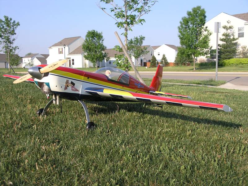

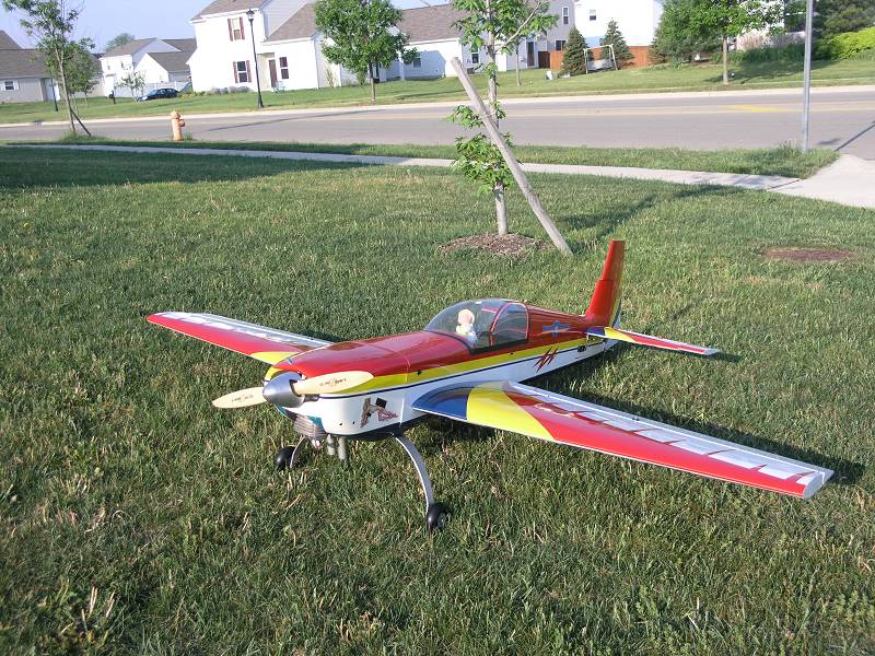

Well I just bought a Yak ( same exact specs ) but am not sure if it is a WillHobby yak.
Everything I can see, tells me it is a WillHobby, except for the color skeem.
I have a OS Max 1.20AX I was going to put in it, but after reading the weight issues you guys are having, maybe I will put my Brillelli 36GT gasser in it. The only thing is the wife just bought me a Great Planes Super Stearman that the Brillelli was for. Well I guess the OS will just go in the Stearman.
Here are some pictures of the Yak, see if you guys can tell me if it is a WillHobby one.
WillHobby Yak calls for a 1.06-1.08 2C or a 1.20 1.40 4C

Well, my plane came today and it is a WillHobby Yak 54. It has in the instructions for a pull pull rudder, CG is 130mm from leading edge at fuse which is right on top of the wing tube, a awsome new color sceem , and the landing gear seems plenty stong enough. So they must have made some changes. On the bad side, just throw the instructions and the hardware packsge in the trash. I did change the colors on the tail/rudder from the blue and white checkers to the picture below. Started building tonight and am going to use a OS Max 1.20AX. as I build I am going to keep as much as I can as far forward to keep up on the CG issues that I have read in this thread.
#42
Joined: Aug 2006
Posts: 760
From: Egg Harbor City,
NJ
Well, there is no way to get a 1.20AX to even come close to balance. I put my Brillelli 36GT gasser in her. This will make her balance without adding any extra / dead weight. RTF dry weight is at 12lb. 14oz. could drop a little weight going with a wood prop, plastic spinner, one RX/servo battery instead of two and still get balanced by moving the batteries. I used Robart pin hinges and CA'ed every joint I could get to. Changed up to all 4-40 hardware and a Pull pull rudder. I am now putting on some color. I changed the tail ( did away with the blue and white checkers ) and made it blend with the plane more. Added some color to the bottom and am cutting from monokote some Yak 54 logos for on top of the wings.
OH, by the way, the wife just loves it when I lean the plane on the china cabinet.

It flew great. No aileron, or rudder trim, and three clicks of up elevator.
I have the controls set at the manual specs of 20 degress each surface. ( except the rudder, I always go with max rudder ).
Ailerons could be set more, but the 20 degrees is good and is a perfect starting point for anyone to customize.
I was alittle worried about the weight at 14 lb. 3 oz. tank empty ( 22 oz. tank ), but it flew and glided great.
Landings are slow and smooth, it will flare for a super smooth 3 point landing.
One issue that I am having is the landing gear / pivot point.
I have the CG set at perfect ballance ( tank empty ). I do all my planes at perfect balance, I never start out alittle nose heavy.
Well, I can't really taxi without it nosing over.
As soon as I touch any gas the tail lifts up and it want to nose over. Even with elevator on high rate at max deflection.
I am looking at having some custom made gear that will be taller, wider, and swept forward.
I am going taller because I need more prop.
The Brillelli 36GT ran A+++++.
The largest prop that I can run with the stock landing gear is 18"
I am running a APC 18 X 6W @ 8250 rpm.
Verticle was unlmited, but not fast and powerful.
I want to run a Xoar 19 X 8 and the verticle and punch out of a hoover should be much better.
No coupling on either left of right knife edge and just a touch of down for inverted flight.
Once I get the landing gear sorted out, I would say this is a great buy.
Wish it was lighter, but you don't notice the weight in the performance.
Definately a 35cc - 40cc gasoline plane though. There is no way I can see this fly with a 1.08 - 1.20 two stroke glow like they call for.
More forward swept and taller landing gear. 1 - 1 1/2 pounds lighter and this would go from a great, to a awsome plane.
