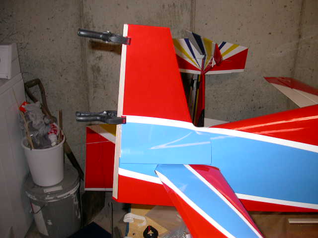

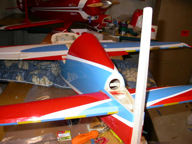

From: fairfield, OH
Default Vertical Stab ??
Guys,
I just got to putting the Vertical Stab on my 1.20 Edge. This piece is all fiberglass with no structure inside. The TE is a piece of heavy balsa, but nothing inside of the stab.
My question is ... Is this OK? It seems way to soft and has no support. I have never had a model with a fiberglass stab before. I have seen them with glass on the fuse, but that was supported with a wooden frame.
Eric

Old 01-16-2003 | 11:48 PM
  #30
garygee's Avatar
Posts: 148
From: cranston , RI
Default join the club!
hey eric i just also finished my vert. stab an i have the same question.i have the 60 -540 and its the same way i have never seen this before. i hope this isn't a problem because yellow will hear about it.

Old 01-17-2003 | 01:51 AM
  #33
Posts: 53
From: fairfield, OH
Default Yellow Aircraft
1.20 Edge 540 Pic 1
Old 01-17-2003 | 01:52 AM
  #34
Posts: 53
From: fairfield, OH
1.20 Edge 540 Pic 2

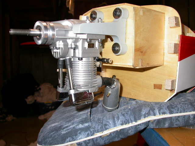

Old 01-17-2003 | 01:54 AM
  #37
Posts: 53
From: fairfield, OH
1.20 Edge 540 Pic 4

  #38
Posts: 76
From: Ramona, CA
Hey nice pic's I've seen this method before and never heard of any problems with doing the vertical stab like that

Old 01-17-2003 | 02:00 AM
  #41
Posts: 76
From: Ramona, CA
Hey ebackscheider quick question. Why did you mount the saito inverted? Will it fit better that way? looking good
Old 01-17-2003 | 02:07 AM
  #42
Posts: 53
From: fairfield, OH
Only things I have changed so far are..
The way the Cowl is mounted. I used hardwood and mounted blocks on the firewall and then mounted the cowl to those.
And the Engine I installed inverted instead of sideways.
I am thinking of using 2 servos in the fuse for the elevator and putting the throttle out by the engine. I don't like the push rods with the Y in the end. I would put them in the back but the sides of the fuse just don't seem strong enough to support it.
I will post more as I get further.
Also, I have the Saito 1.80 in it. The OS 1.60 is very powerful and would fly the hell out of this plane, but I am a 4-stroke or Gas only person. This is just a preference thing I like the sound.
Eric
[email protected]
Old 01-17-2003 | 02:11 AM
  #43
Posts: 53
From: fairfield, OH
I put it inverted for 2 reasons.
1. I did not want to cut up the cowl.
2. This is what I have done on my larger planes and how I am used to doing things.
I had the H9 Edge with the engine mounted on the side and it sucked slicing up the cowl. Wing folded on the 5th flight so I guess it did not matter in the end.
Eric
[email protected]

Old 01-17-2003 | 02:33 AM
  #45
Posts: 821
From: Cincinnati, OH
Eric,
Beautiful plane. What is that fin brace made of?
Allan

Default Started my 60 edge 540 Saito 100 won't fit
I started building mine. Looks great and well built. Only problem is my Saito 100 wont fit. The length of the motor is about 6 mm to long to fit into the cowl properly. I researched and found the YS 91 is too long also, OS 91fs will fit but Iwill probably just put an OS 61 fx in it with a pitts muffler. Any Suggestions?????
Old 01-17-2003 | 04:36 AM
  #49
Posts: 76
From: Ramona, CA
Use the 91 fx. The 61 will any give basic sport performance. the 91 is the same size. I would use a perry pump on that motor.
