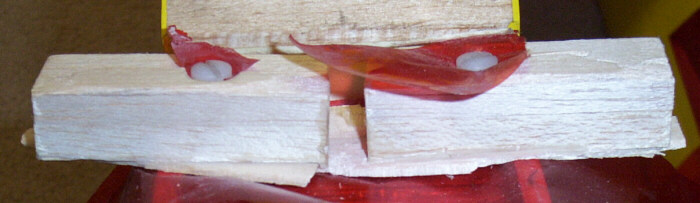

Here is a close up view of the wing reinforcement block. You can see there is no evidence of any glue. Also if there had been glue you would have seen some tearing of the wood, but you dont because no glue was applied to this structure component at all.

I have many more photos available but I think these show the lack of glue and the that I built the plane according to the plans.
If I was building another, and I hope Esprit will replace the plane so I can, I would remove the sheeting on the bottom of the wing where the wingbolts go thru, sqiurt some thin CA in, and replace with lite ply.
If I was flying one that was already built, I would remove the sheeting from the top of the wing and get some glue in there asap.
