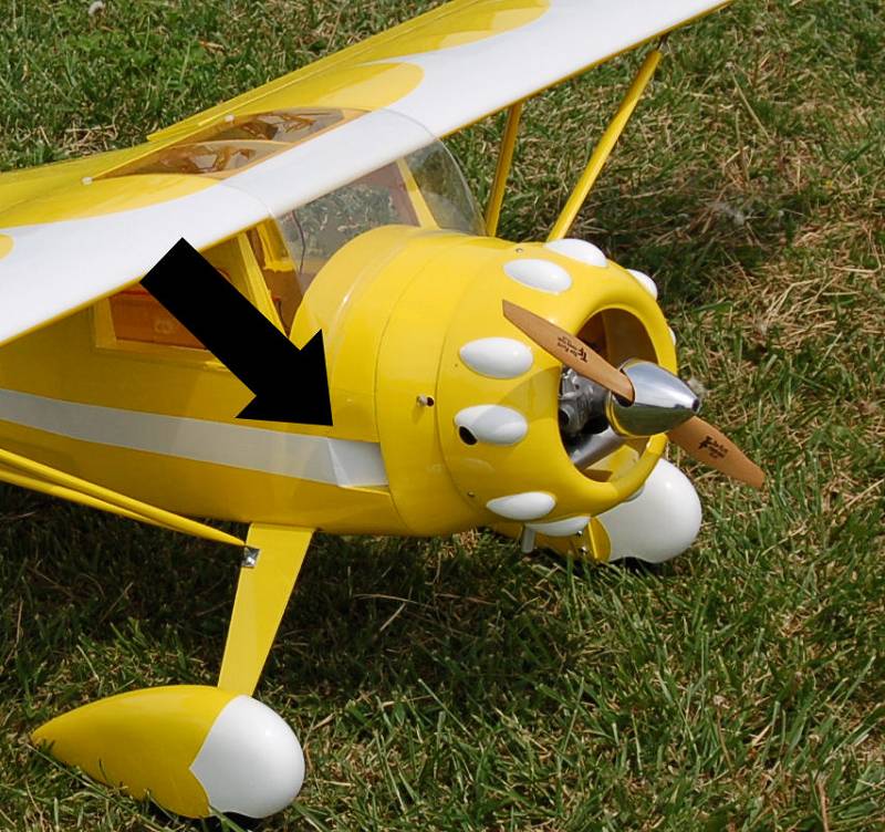

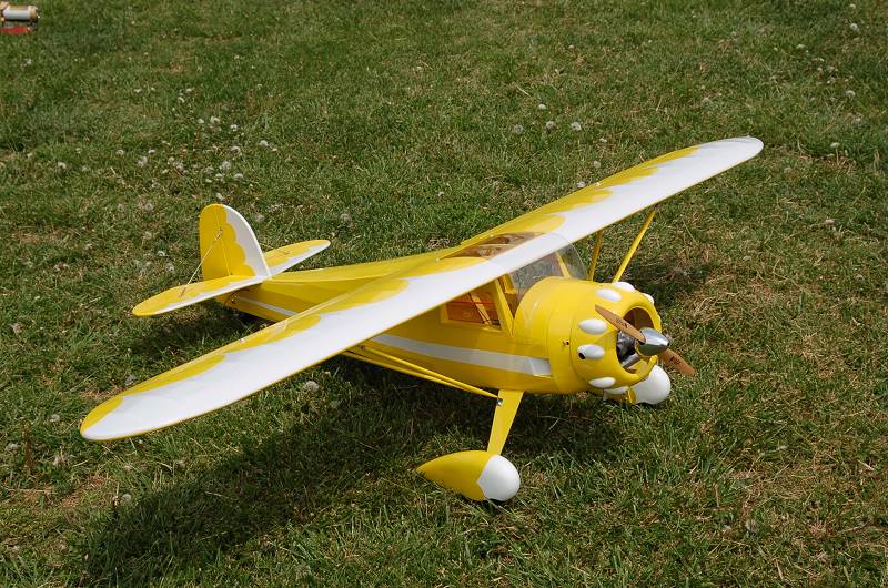

Old 07-30-2007 | 02:47 PM
  #32
Joined: Oct 2005
Posts: 11,517
From: Near Pfafftown NC
Default RE: Kangke Monocoupe
BTW, the cowl design looked to me like it wouldn't work very well to cool the engine, so I did a little modification.
If you look at where the arrow is pointing, you'll see a heat exhaust vent. All it took was two saw cuts and some scrap wood. Since it was into the firewall, when I glued it up, I used epoxy and some glass cloth. Since the firewall was only two layers of liteply, I wasn't worried about making it overly strong as the firewall certainly wasn't.
