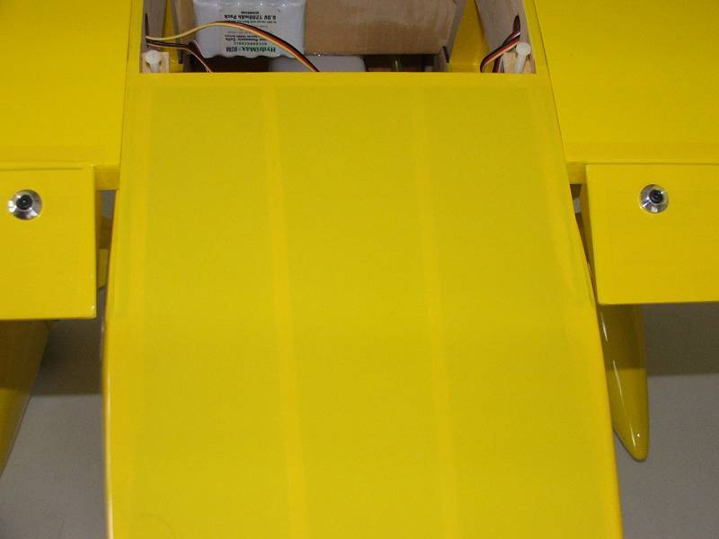

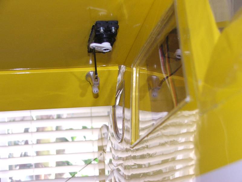

Just another note:
I had to remove about 3/16" more from the root edge of both flaps to clear the window lip when the flaps were fully extended. Mine now has a 3/8" gap between the wing root and the flap inner edge... just clears with this gap.

Thanks for the information, I would of had the same problem with the flaps being too close to the windows, A couple other things I run into were;
1.) my supplied motor mount was not long enough.
2.) I put in a mag. 91 4stroke inverted and had to cut the cowl at the bottom, the head was touching the cowl. (I thought I read that the Mag 91 fit inside the cowl) Not a big deal but trying to see if anybody else did the same.

Roger on the gap between Fuse & Flaps. This is very desireable for good control when using the Flaps, as air can now flow there. If the plans did not indicate a proper space there, they should have.............Cheers!......Rich
