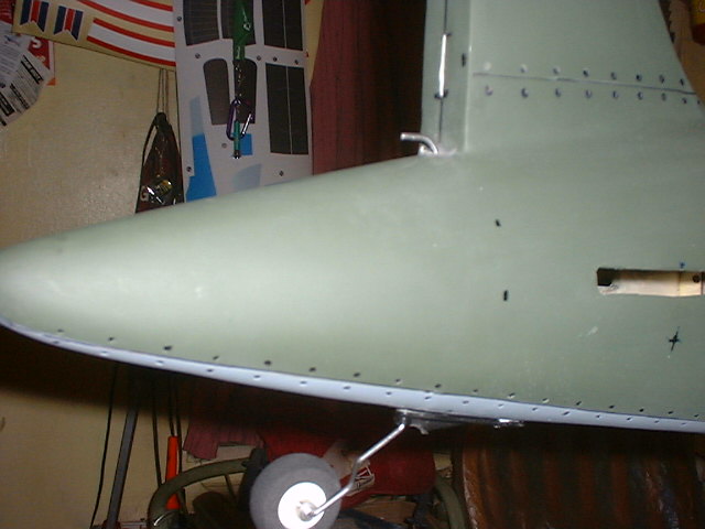

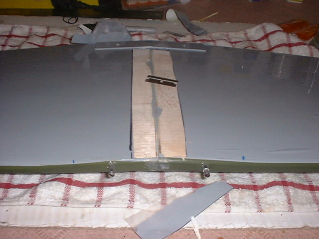

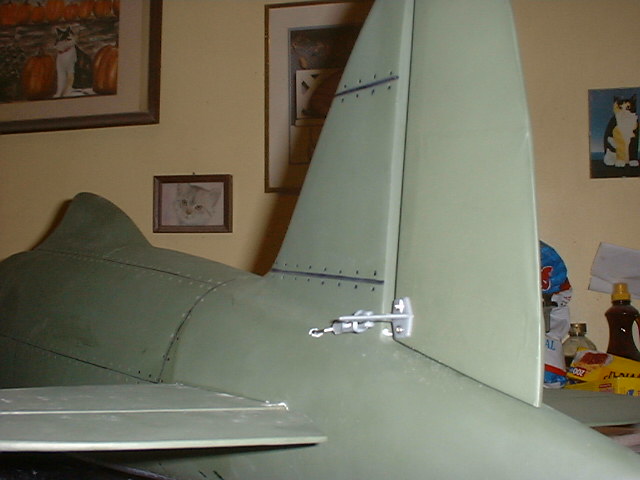

I purchased this same model from Fly-boys and it came bright yellow. I removed the paint from the fuselage and the covering from the wing. I added retracts and split flaps to the wing with minimal amount of effort. The spacing of the ribs lends itself to place the landing gear in the near correct spot. The flaps to were very easy to install, as long as you don't mind cutting the trailing edge off.[img][/img]

Cliff, I am still trying to figure out how to use this forum so bear with me. My Macchi flew for the first time on Monday the 8-21-06. The plane has been modified so it has retractable main landing gear and working split flaps. The final weight of the plane was 10 1/2 lbs. It took 1 1/2 lbs of lead in the nose to balance it on the main spar. I used a .91 magnum 2 stroke for power, making about 10 lbs. of thrust. The plane flew very nice with only a small trim adjustment. The flaps did not cause any up or down pitch problems. The retracts are the great planes .60 size mechanical type with 3/16 wire struts. They handled the weight of the plane with no problem and looks good in the air....Bob

The macchi you ordered was it from Nitro Models? The model I got was from a company called Flyboys and the kit was called Airkil. The fuselage that I got was in good shape but the panel lines need a little more work. The wing is a open bay type build up wing but was covered with a plastic type covering. When you build your plane I would suggest you add more fiberglass between the firewall and the first bulkhead. The plane needs a lot of nose weight to balance so don't be to concerned about the added weight. My plane had a engine failure on the 4th flight and that area felt a little soft afterwards. I repaired it with fiberglass and its nice an rigid again. The retracts really add to the appearance of the plane when it flys by and the Great Planes retracts are very inexpencive. The flaps are a big help when landing since this plane as a very narrow wing and a lot of weight to hold up. The plane as a very nice look on the ground and in the air. Good luck on your new project...Bob

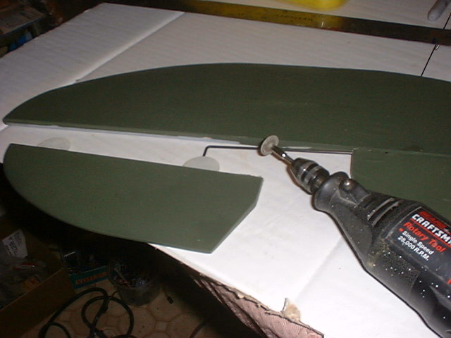

I buy also a " Airkill 90 " in Germany and do have some changes at the kit.

the Wings will be new with Polytex and a retract for the Macchi

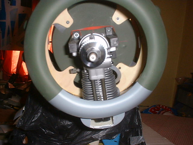

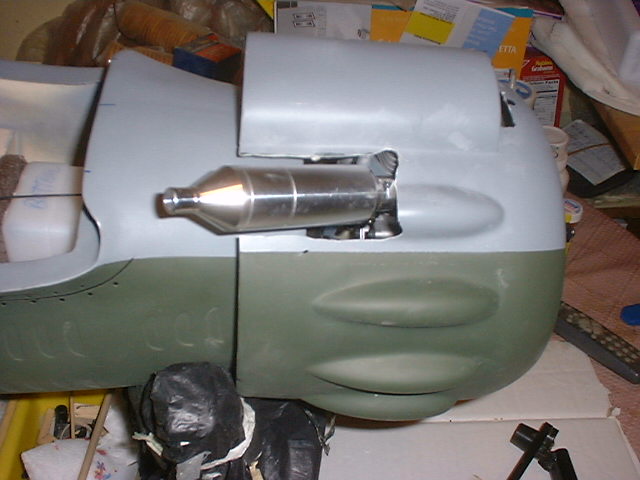

Now it's waiting for the first flight.
powered by ASP 80 4-stroke,
The manual Instructions don't show the C.G. - does anyone know the point ?
