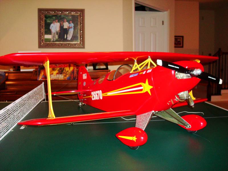

I bought this pitts from a guy and he said it was made from a royal kit. I am looking at selling but wondering how much to ask for it. any ideas?
It has an OS 91 4 stroke. It looks like it is covered with fabric and dope. Everything works great but was told it might be a little bit much of a plane for me.

Nice looking plane. Hardly anything looks better than a Pitts in the air, IMO.
However, a Pitts can be a challenge on the ground due it's short wheel base and fuselage length (moments) but flys well once you get her airborne, if it isn't too heavy. Royal kits could get a little heavy depending on the builder and his willingness to carve away excess balsa, among other things. You may very well be getting some good advice, and it would be a shame to damage her as repair would take some additional skill due to her construction. I can't tell for sure, but it looks like it may only have two ailerons as well, not good IMO for a Pitts.
If it is RTF, with a good engine and other components, you may start at $500-$600. You can always come down. I recently sold a smaller 40 size Ultimate for $500 but it was all new including engine, plane, servos, and other components. The only thing not new was the RX and TX.
Hope it all works out for you.

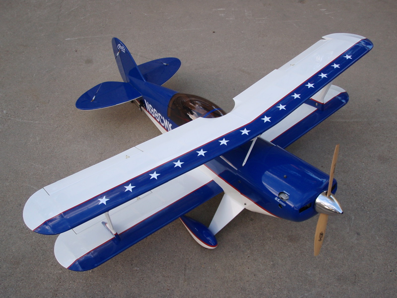

  #113
Joined: May 2006
Posts: 496
From: CAMDEN, TN
Default RE: Cermark Pitts Build/Assembly
I have not had that problem and I have ruddered mine alot. I assume that you have verified that no weird mixing is going on now. I mean when you rudder on the ground there is no elevator deflection.
It sounds like an incidence issue. Did you check the wing incidence and maybe double check the ailerons to verify that they are all centered with the wings.

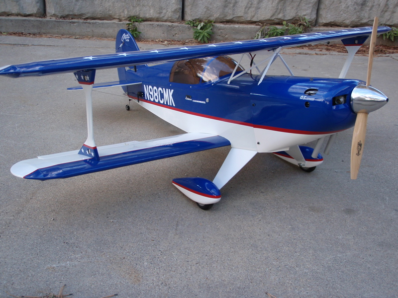

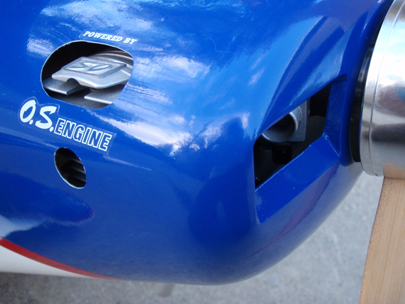

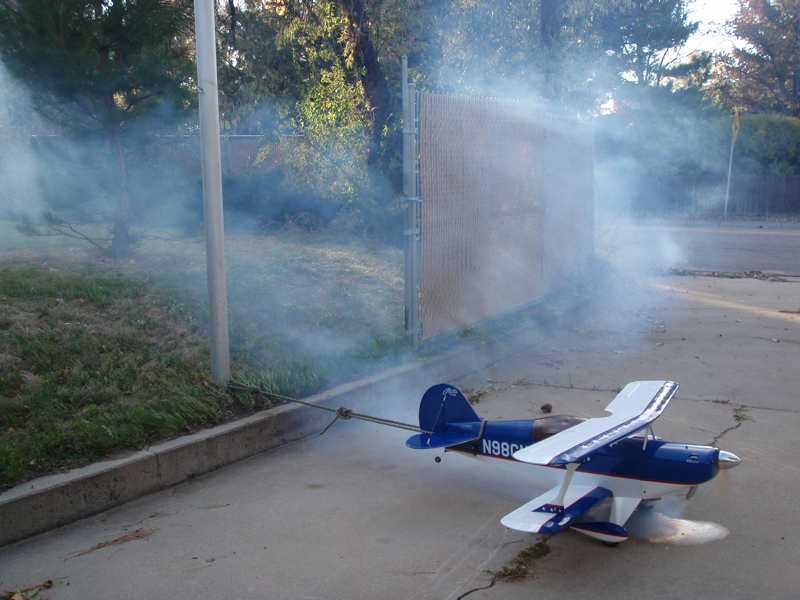

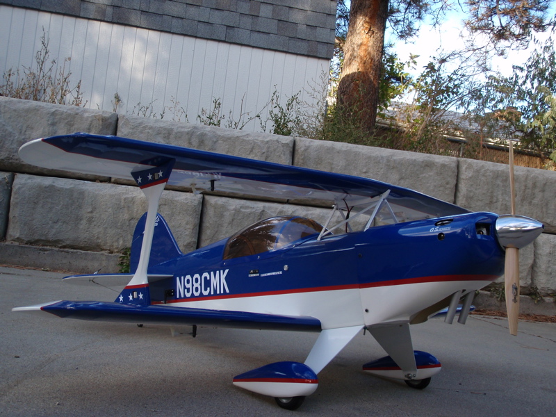

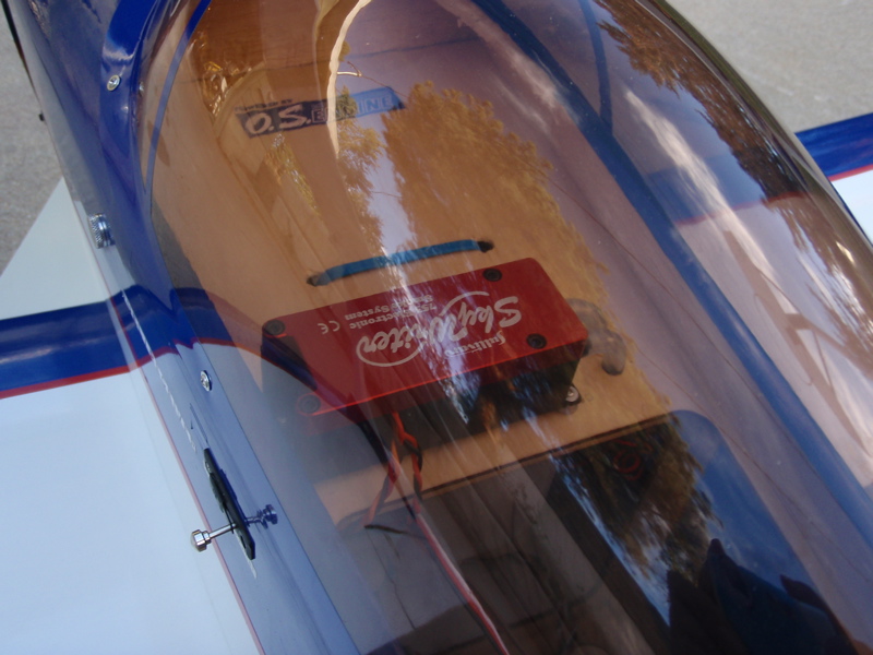

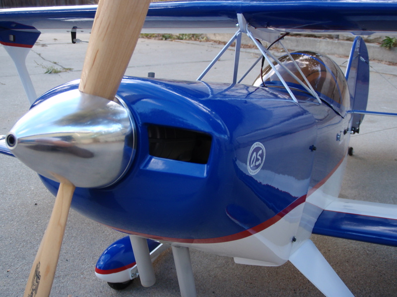

Looks good Free Bird! I like what you've done with the aileron linkage. I've just completed my Cermark S2B with an O.S 1.60 and smoke. I'm over one mile above sea level, so there's no replacement for displacement! Hope to maiden this weekend and will account any rudder issues. I'll take some photos soon.

It's been a few months since the maiden but I never posted... Bad me. Maiden was great!!! The OS 160 screamed (although tuned a little rich for break in) and the 18/10 prop seamed to be appropriate. The aircraft only took a few clicks of right rudder and everything else was dead on using the factory suggested CG. It seamed that everyone at the club was warning me on how challenging these are to fly and especially land. I feel it's the contrary! Like any bipe, throttle and rudder control must be on the top of your mind but I thought it was very easy and predictable to control even in high rates. It seemed to land a little like a fast trainer that was happy with a lot flair. And in the air, that thing will tumble! I have 6 successful flights and the season's gone. Am waiting for spring for weather and more daring flights... Until then, it's indoor season!
Overall, I'm very happy with this bipe- It looks like the only thing I'll be improving is the tail wheel at this point.
