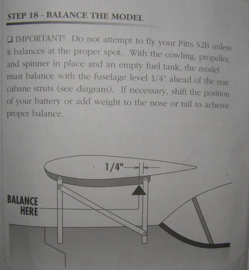

Howdy all.
I just picked up a perfect shape blue version at our club swap meet.
Can someone give me the forward and aft balance limits?
Thanks!
Old 02-03-2008 | 08:24 PM
  #82
Mr67Stang's Avatar
Joined: Apr 2006
Posts: 3,822
From: Raeford, NC
Default RE: Cermark Pitts Build/Assembly
Okay I lust looked at my instructions to see what it says. It says to balance it 1/4 inch in front of the rear cabane strut. There is a nice picture in the manual that shows this. I do not want to assume you don't know but because I would not know without the picture I will explain better. The Strut/frame work that bolts to the center of the upper wing is the cabane strut securing the wing with 2 bolts. The rear most bolt goes though this rear strut. At the leading edge of that rear strut measur 1/4 inch forward and balance there.

Mr67Stang,
thanks. I also saw on another post that 1/4 inch in front to the lower wing. I need to go look at hot the rear cabane lines up with leafing edge of lower wing at the fuse side.
As far as the OS160 and Pitts muffler, the guy I picked up my Pitts from started with one in his and needed 12 oz of lead in the tail to get it to balance.

ORIGINAL: jsenicka
Mr67Stang,
I think You misunderstood me so I took a picture of the balance procedure.

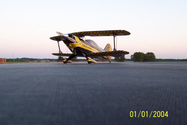

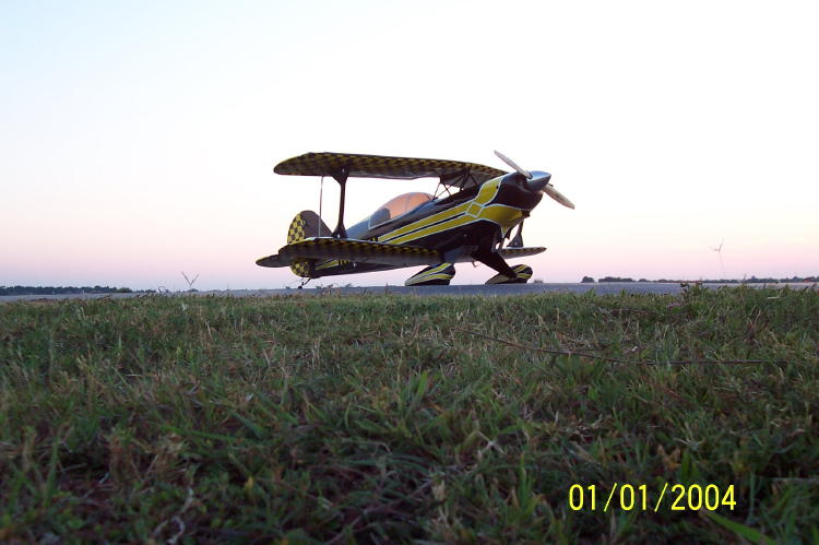

I have an OS 1.6 and Bisson muffler .. Never had any issues with landing gear or really anything.. I don't think I have had the bottom wing off of it in almost 3 years(I guess I should really take a look in there huh)...
Rick
