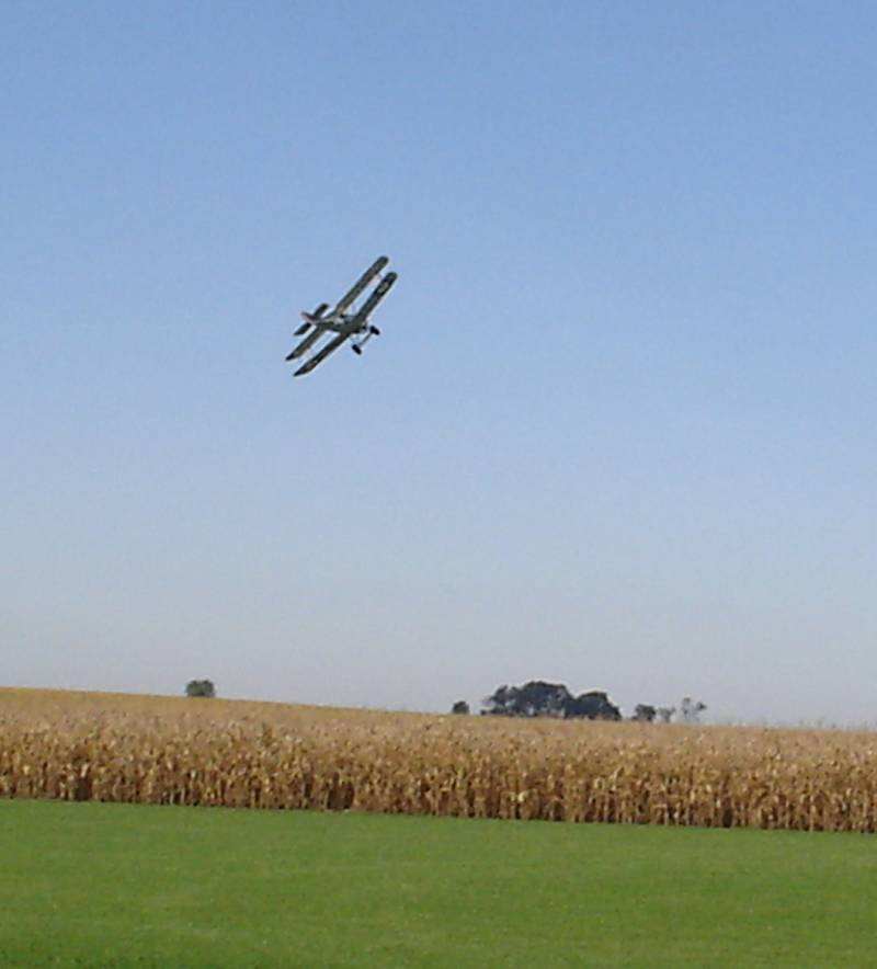

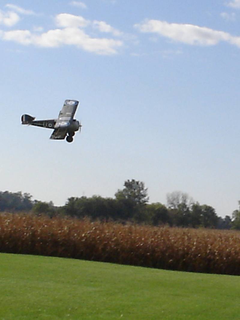

I flew mine again today, much better after I put the extra 6oz of lead right in the cowel. Mine also didnot have the tail grommets and Horizon sent me a new wire kit and it was missing the grommets in it also, so I cut the ones attached to the wire already sence I had two sets.

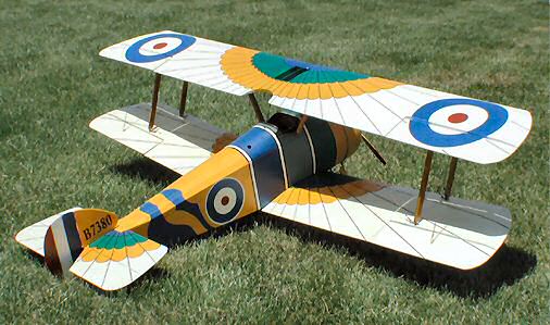

As regards Camel colour schemes, the most colourful Camel was the 1000th off the Rushton assembly line in Lincoln in 1918.
Here is a pic of a beautiful model of that particular bird.

Madame Butterfly I presume...... If I were building a cmpetition scale kit, that would be a scheme I would consider.....beautiful...
