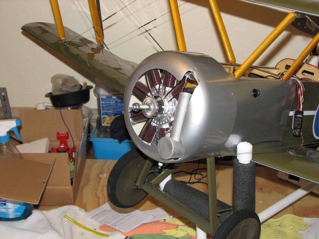

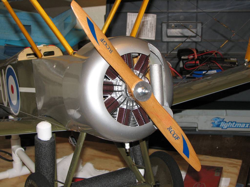

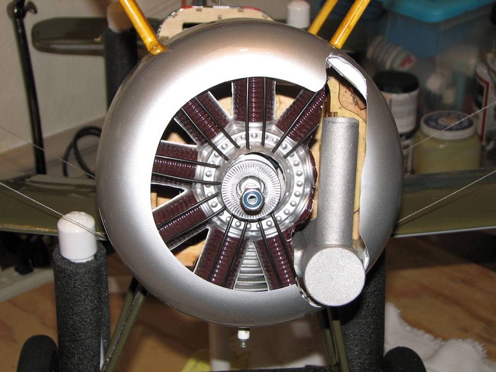

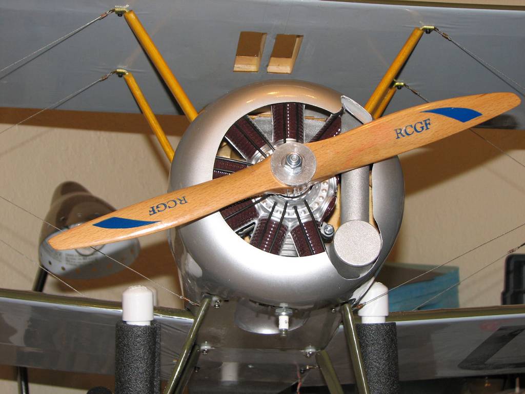

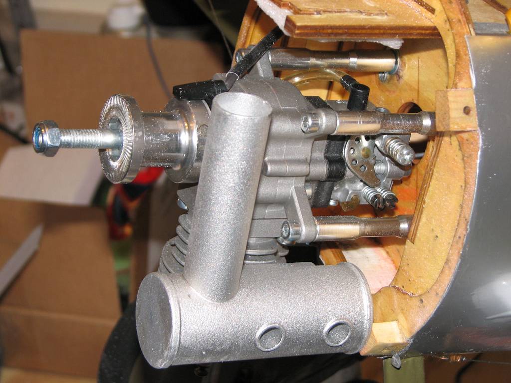

Here's my progress on the gas engine installation. The engine arrived yesterday and came with the correct length standoffs, bolts, prop washer, and prop nut. It also came with a huge muffler. As you can see by the photos, the muffler would not fit inverted (too long) so, until Ifind a drop down flex pipe that will fit this engine I've mounted it as in the picture. I intend to fix an exhaust deflector to the top of the exhaust pipe to run it completely out of the cowl. It looks bad but, it fits well and will work until Ican find what Ineed. Isearched the web last night to find a 90 deg. drop manifold that would fit a 30mm bolt pattern but, no luck. I'll keep searching but, Imay have to fabricate something.
Fortunately, Horizon has parts left for this bird and Iwas able to buy a new cowl and fake engine so that when I do correct the exhaust mount I'll have a cowling to install that's not all chopped up.
I chose to use the same method Minnflyer used to mount the EI but, mine will mount under the platform as it will interfere with the cowl if I mount it on top.
I'm not happy with the appearance but, it's better than not flying it at all. Ineed to plumb the fuel tank for gas and get the electronics hooked up. Then we'll see how much, if any, weight Ineed to add up front.

Everything is installed and she's ready for an engine run. I hope to get to that tomorrow after I run the errands my wife wants me to do (never ending it seems.
) I'm hoping the LHSis open has an exhaust diverter that will fit by 7/8" pipe.
Thanks for the link.
Merry Christmas and happy new year.
RJ

Got the little 15cc started today and she runs like a top. Total run time was probably 30 min. off and on. This little baby litterally sips fuel with an eye-dropper. I'll run it in a bit more before she flies. It's idling a bit fast but, that will improve with break-in. The transition and top end are very good.
My LHSdidn't have an exhaust deflector in the size Ineed but, there's other shops in town and I can always order one if Ican't find it locally. I hope to have her ready to fly on 1 Jan. for our club's annual "Black-eyed Pea" event. So I've got about a week to get her ship-shape. Ineed to install another switch for the ignition too. Shouldn't take but, a couple of hours providing Ican find the parts Ineed.
Garry
I'll probably end up fabricating one myself or having one custom made. I'll contact them later this week and find out if they can help. Ihate to put an expensive exhaust on a $150 engine.
Garry

I contacted Jtech and a fella named Al is helping with the exhaust issue. Isent pictures and dimensions. He's looking at the issue and will get back to me soon, I'm sure. Hope he can find something for me.
In the meantime, I found a piece of thin wall metal tubing in my garage that will work as an exhaust extension. Icut it to length and mounted it over the exhaust pipe to ensure the exhaust exits the cowl. So, she's ready to fly once I get the 2nd switch installed for the CDI.
RJ
RJ
