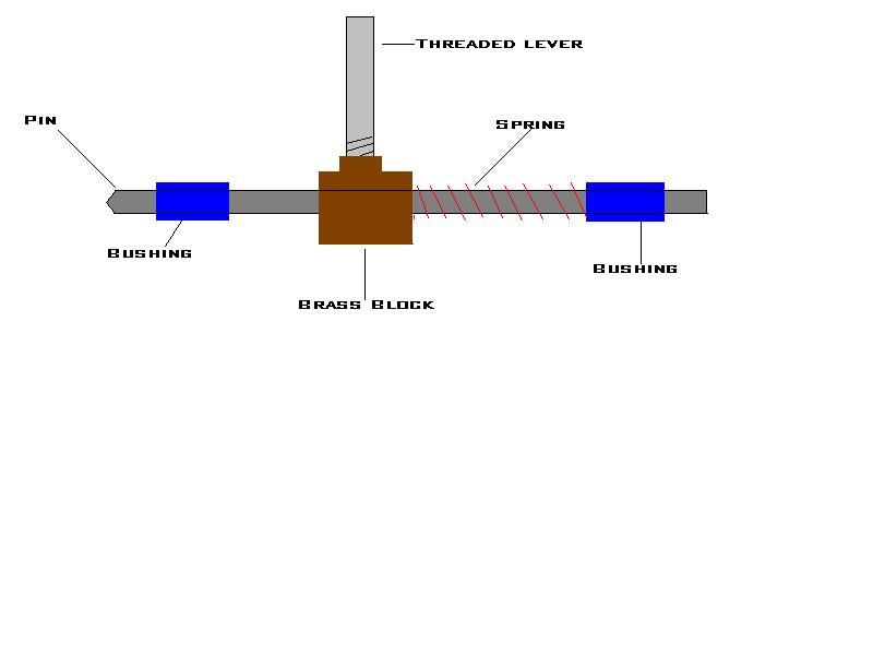

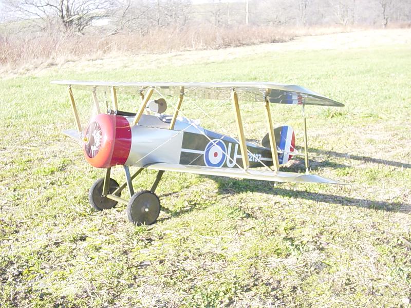

Guys I hope you don't mind an intrusion from an electric flyer, but a couple of tips you can use.
#1 the missing tabs for the tail, there is a tech bulletin on Horizon's site about them being not packed, just call them and they'll send em to you.
#2 if you run into a problem with the latching mechanisim for the cockpit, I did a little digging on mine. Actually used a magnifying glass and a mag light. What a cool set up.
It's adjustable. The pin sits in 2 bushings and a brass(?) block, the lever is actually a threaded rod that screws into the top of the block and pinches the pin in place. You can loosen the lever by unscrewing it to adjust how far the pin protrudes, then tighten the lever back down. There is a spring between the block and the rear bushing to give the spring action. I drew it out for ya.
Oh and a pic of mine. 8 pounds ready to fly, and with electric you throw away the weight box and lead weight.
He He He, even has the correct pilot.

GG,
What is your electric motor/battery/prop setup? I am doing electric too.
Old 12-31-2006 | 07:48 AM
  #122
Glacier Girl's Avatar
Joined: Jul 2004
Posts: 7,906
From: Lakeland, FL
Default RE: Hangar-9 Sopwith Camel Build Thread
E-Flite 60, 16x8 prop, 2 3S3700 20 C packs in series, CC60, and a 5 cell rx pack.
I cut out the fuel tank mount and installed the packs in an upside down V position, right behind the firewall. The rx pack sits right on the hump under the lipos. Rx pack is held by velcro, the lipos actually wedge in between the floor and top of the fuselage, I use a piece of foam behind them to keep em from moving. Like I said mine came out dead nuts on CG wise, so I tossed the weight and box in the junk box of left over parts I have.
The 60's over kill but sure is nice. 1/2 throttle and she's light on her feet and off the ground.
