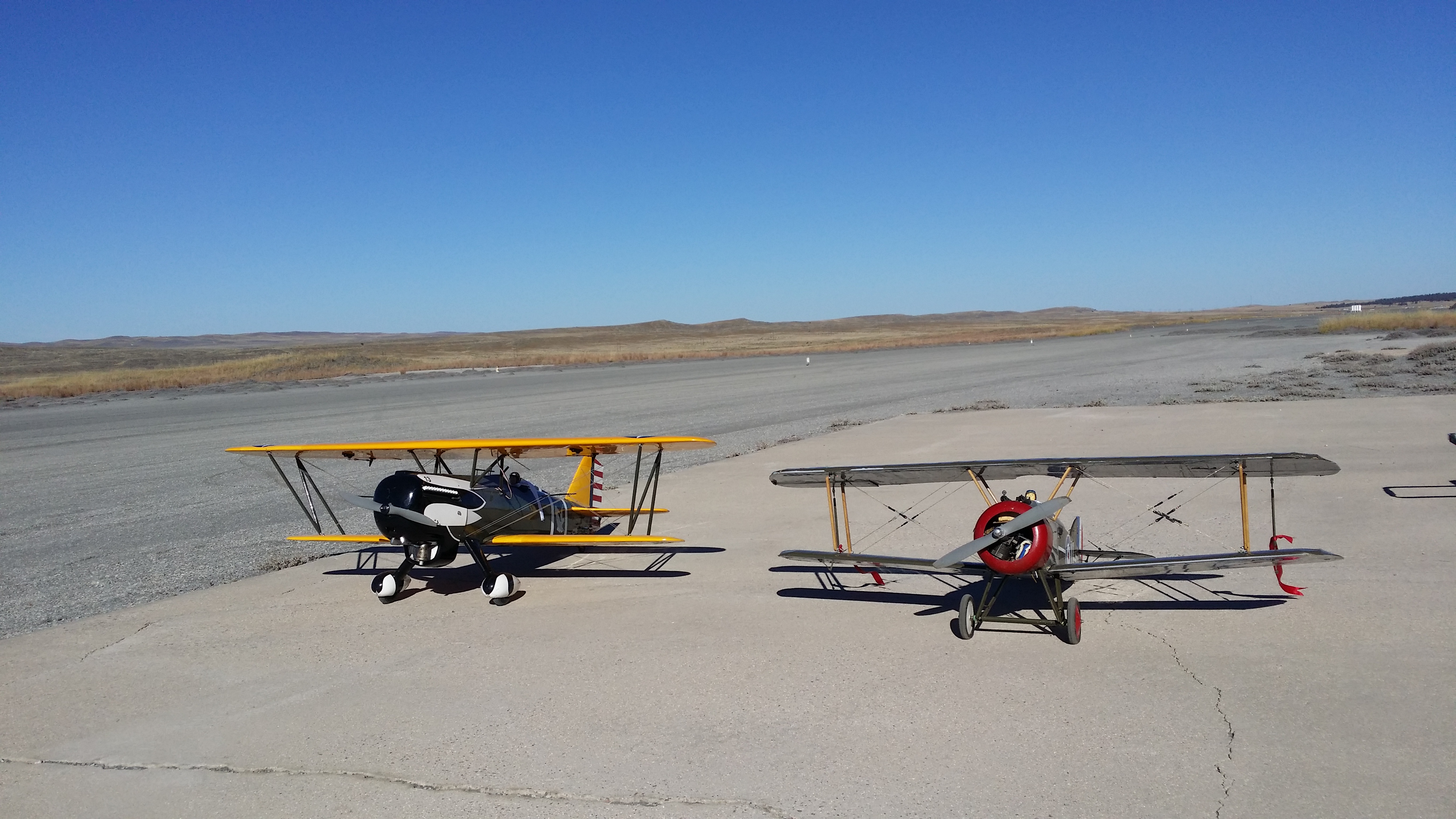

Great summer of flying...The weather here has been quite nice as well and we have been out to enjoy it a few times. Here's a shot of my Camel with his stable-mate which I got in January, The Great Planes P6E (original with Saito 150, not the new 'castrated' electric version). The Hawk lands similar to the Camel, but is WAY easier to fly all around. I'm glad I learned about bi-planes with the Camel. I think it's kind of like learning to ride a dirt bike before your kiddie bike...ha.

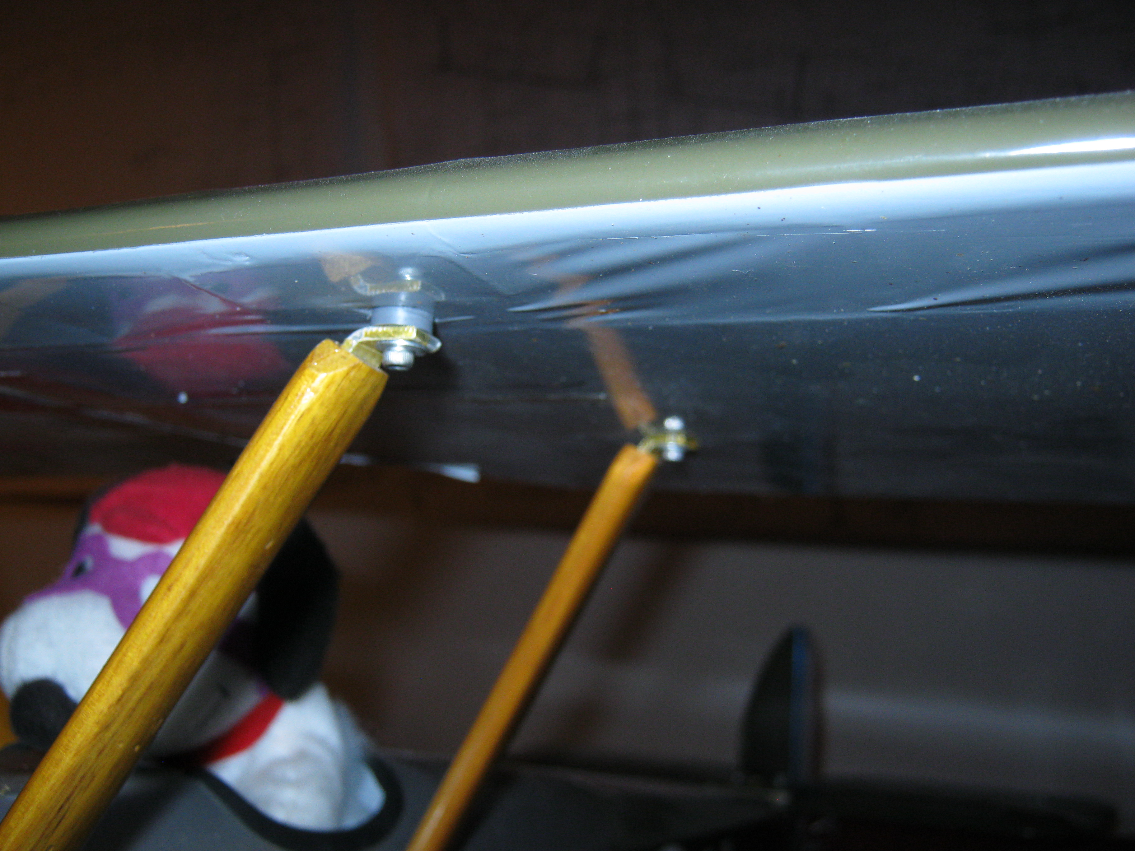

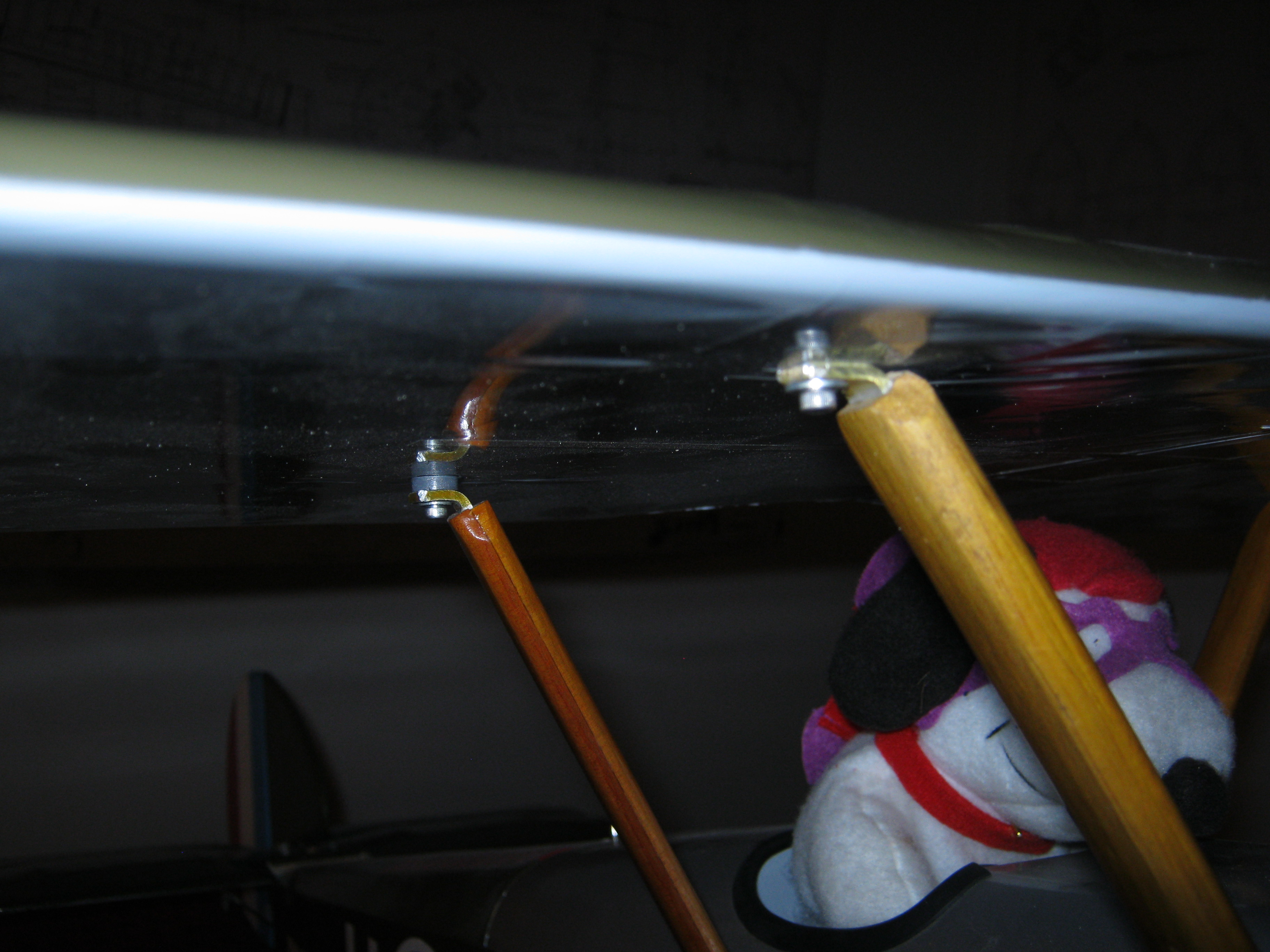

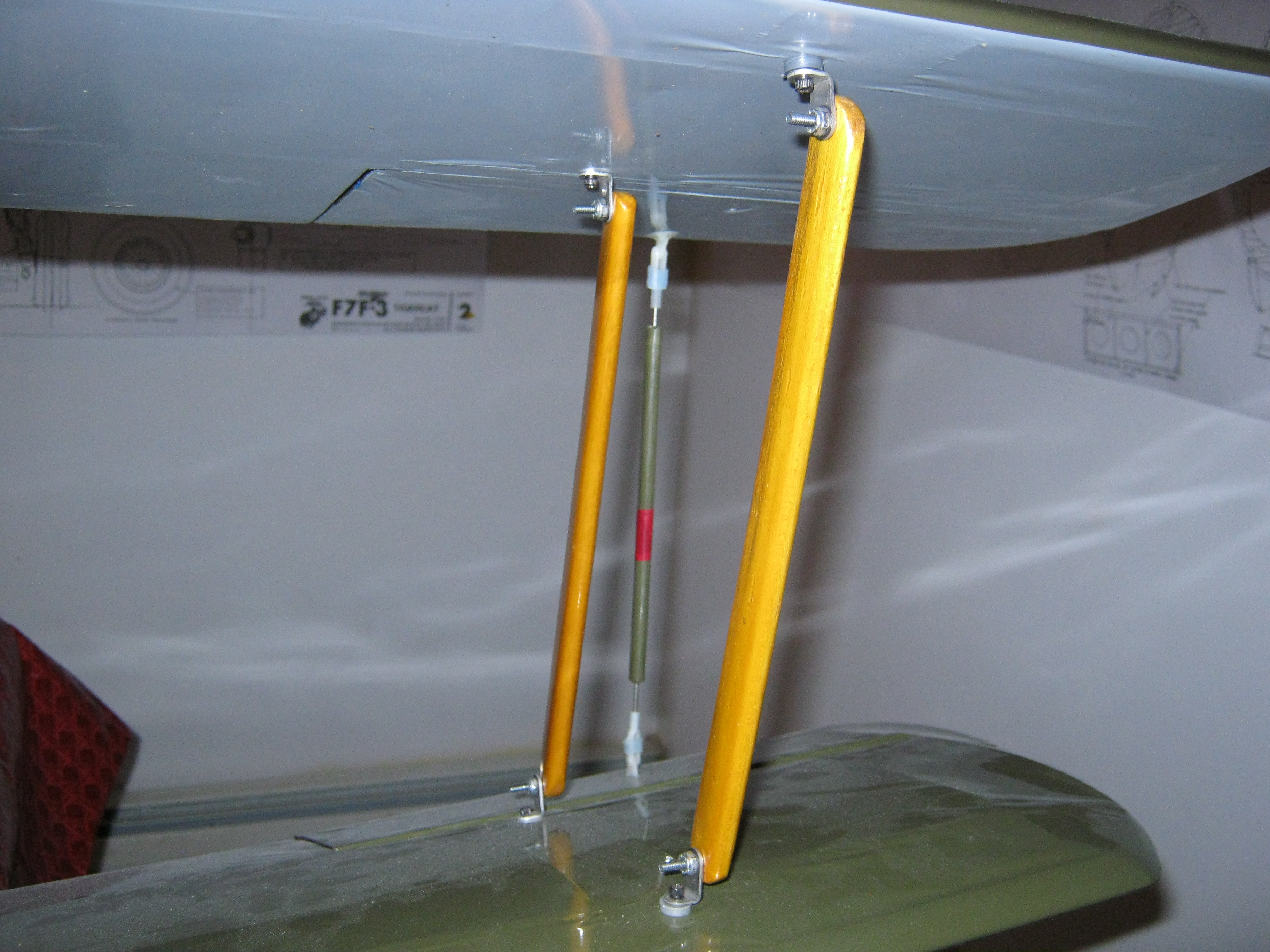

Always suspected that the wing panels on the H9 Camel were twisted, and not anywhere near equal incidence left to right. Got real bored this winter, put the Camel together, and hauled out my helicopter digital pitch gauge, which makes a great incidence measuring device. Results: right hand panels both hand more incidence than the left ones. That's why this bird has always fought right turns, and needed almost half an inch of right aileron trim to fly in a straight line.
You know those little fiberglass adapters that come with APC electric props? I used a bunch of them to shim the panels, putting them between the panel and the ends of the cabane and inter wing struts. Everything is pretty close to identical, now, with a little bit more incidence on the left panels, which is what this thing needs with all the torque from that G60 motor and the 17" prop.
The pictures show it better than I can describe it
Anyway, she'll get tested this spring. I've become so fed up with the squirrelyness of this aircraft that if this doesn't correct it, it'll be going up for sale, and I'll build a BUSA Spad XIII. I have a BUSA DR-1, and it flies 10 times better than the Camel.

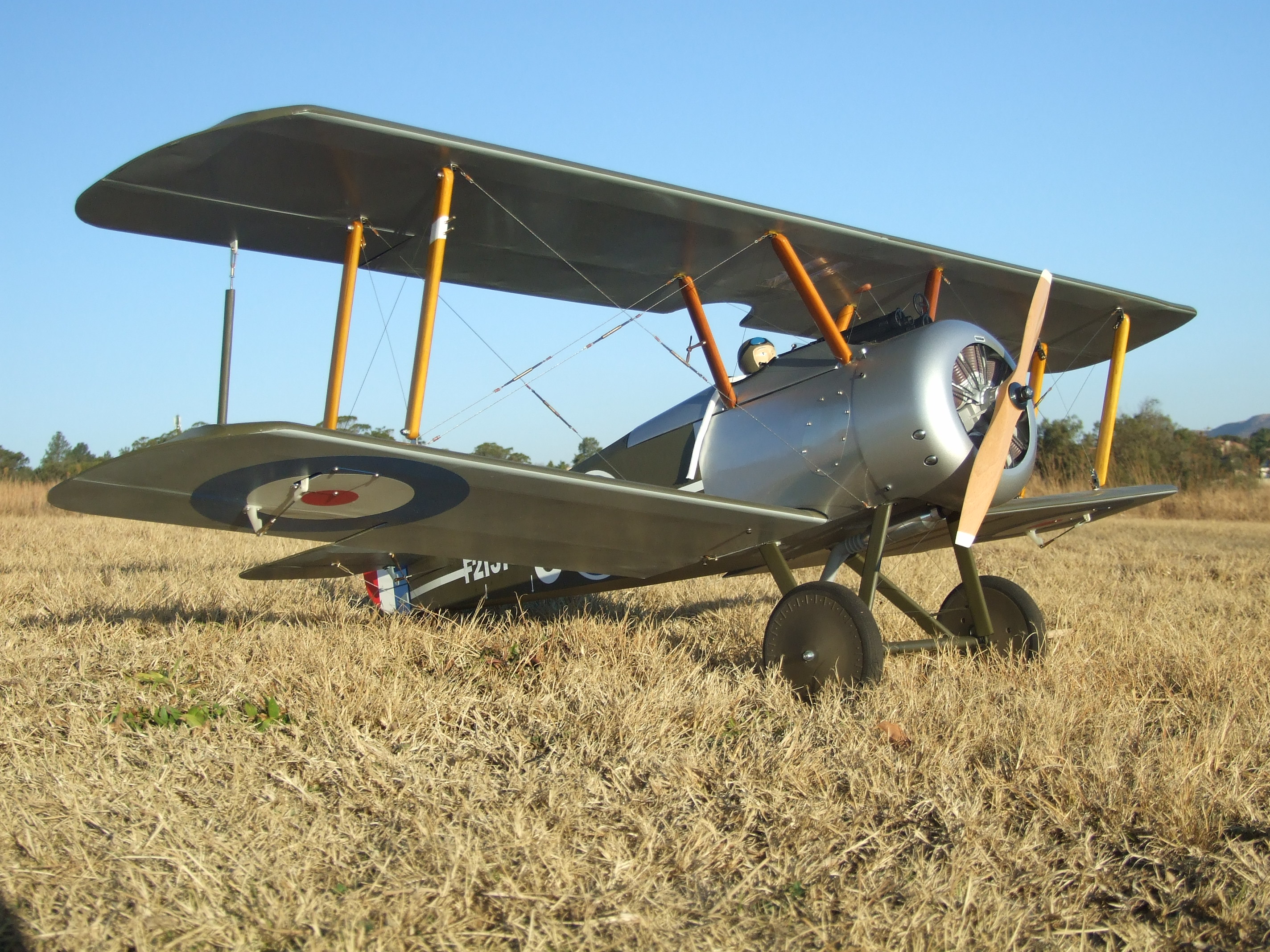

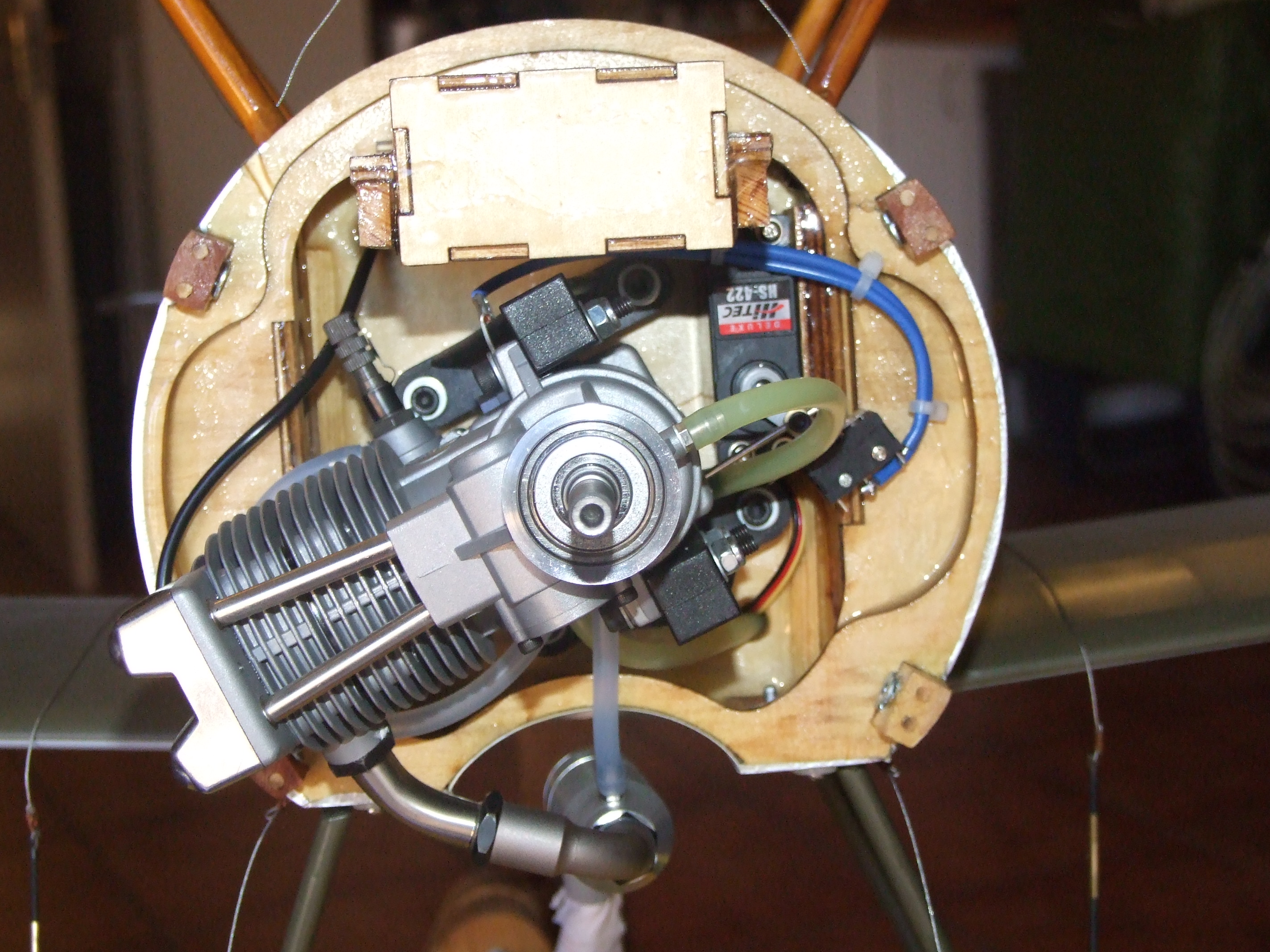

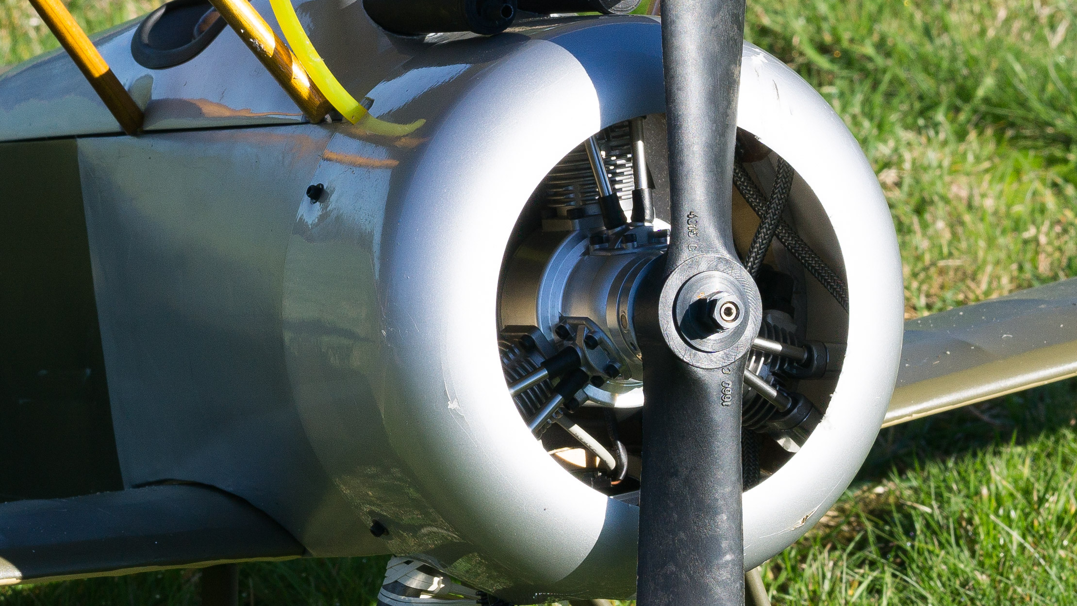

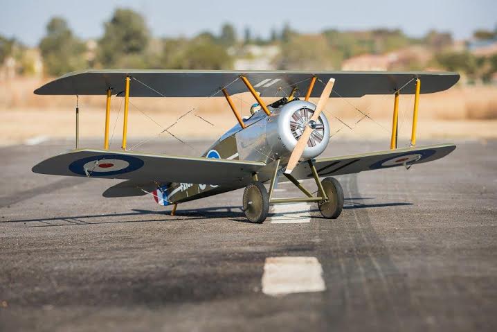

Hi Guys, I have just completed my camel build after a few years of it sitting in the box...
It has a thunder Tiger .91FS four stroke with home made on-board glow.
Sprayed the shiny covering with Tamiya PS-55 with gave it the perfect look.
replaced the machine guns with Williams bros guns.
Added extra rigging and fake fuel pressure slipstream pump.
ID:	2111092   Click image for larger version
Old 07-25-2015 | 11:52 AM
  #1362
Joined: Aug 2005
Posts: 143
From: roodepoort, SOUTH AFRICA
ID:	2111094   Click image for larger version
Old 07-25-2015 | 11:59 AM
  #1363
Joined: Aug 2005
Posts: 143
ID:	2111097   Click image for larger version

Looks great! Have you flown it yet?
Old 07-25-2015 | 12:38 PM
  #1365
Joined: Aug 2005
Posts: 143
Thank you,
Nope, I have not flown it yet.
I am pretty apprehensive about getting this bird up to be honest, It just looks like a handful.

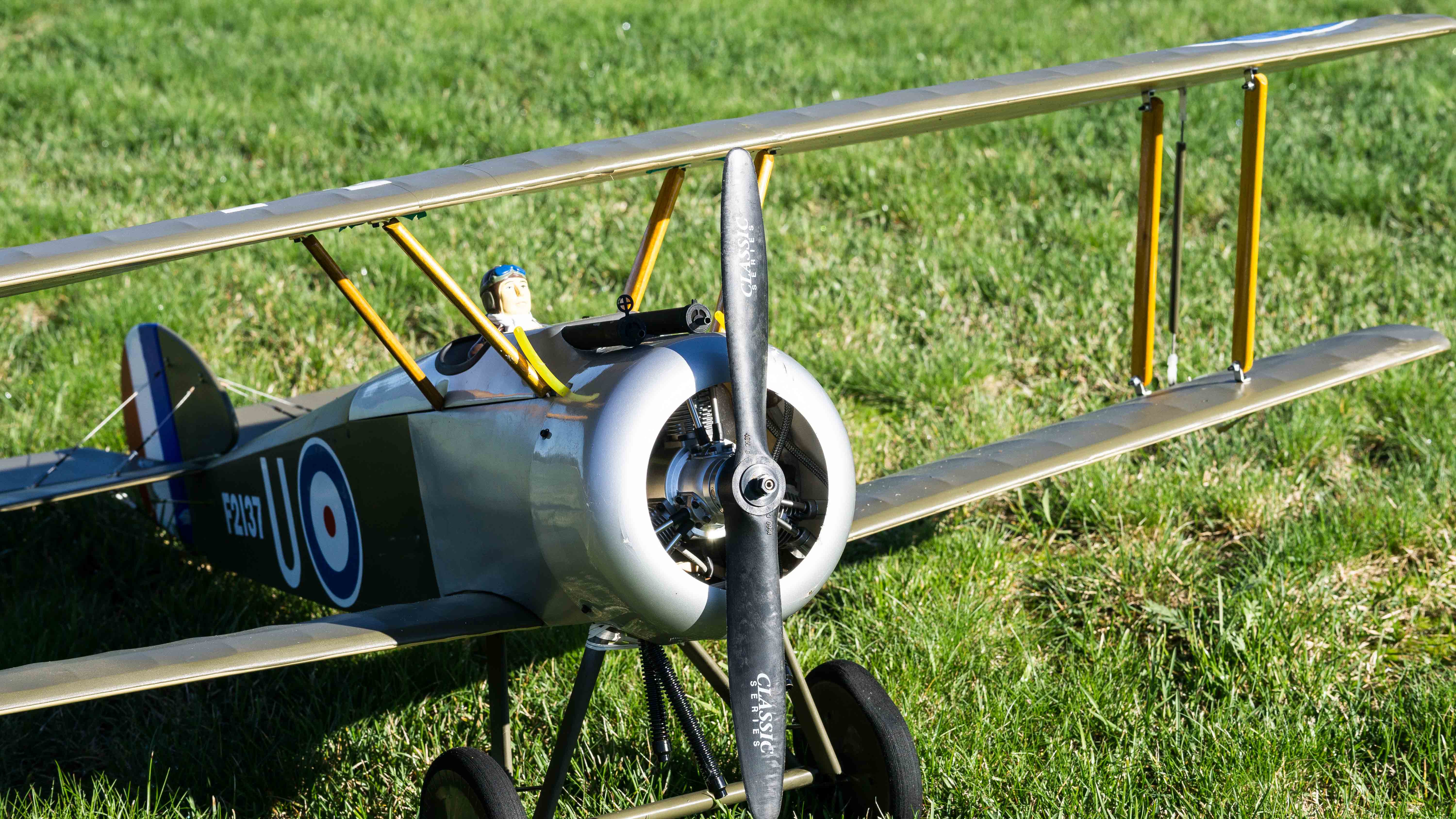

I have this plane with a saito FG19cc r3 gas. The engine is a perfect match for this plane. but I had to add 360gram (12.7oz) lead and still it is a little tail heavy. but flies great.
ID:	2122834   Click image for larger version
