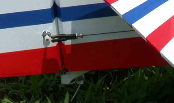

i installed the Kevlar 29 from EMS/Jomar and am worried about one thing. When the kevlar comes out of the tube at the exit, will it start to fray or get less stronger? The cord is rubbing up against the end of the tube when it comes out. If it will cause a problem, how can i fix it??
In the pic, see how the cable has to turn to be able to hook up to the rudder? thats where it is rubbing.

Supposedly that wont hurt it, but I wouldn't leave it that way. If you can get the tube out, warm the end and bend it to follow the curve, letting the cord come out straight. If you can't get it out warm it carefully and bend it in a bit. I'd go ahead and pull it, even if I had to replace the cord afterward.

so how would i go about heating the tube? When i do heat the tube, should i remover the wire?

Yes, pull the cord out for safety. I don't know how the heat would affect it. Probably no affect at all, but be safe. If you can pull the tube, warm it with your heat gun, then hold the bend until it cools. If you form a close fitting wire to the shape ypu want and stick it in the plastic before you warm it, then it will be perfect when it cools, and you wont have to use your fingers messing with the hot plastic.
If you can't, or don't want to pull the tube, still use the heat gun, (being careful of the covering) but you will have to use a wire this way. Just stick it in 1/8" or so, just enough to use it as a handle. Stick it in too far, it will absorb the heat, you wont put a bend in the tube. Keep pressure on the tube with the wire as you heat it, and stop heating when the tube lets go. If it's not bent enough when it cools, do the warming bit again and recheck.
As I said, I'd pull the tube to do it.

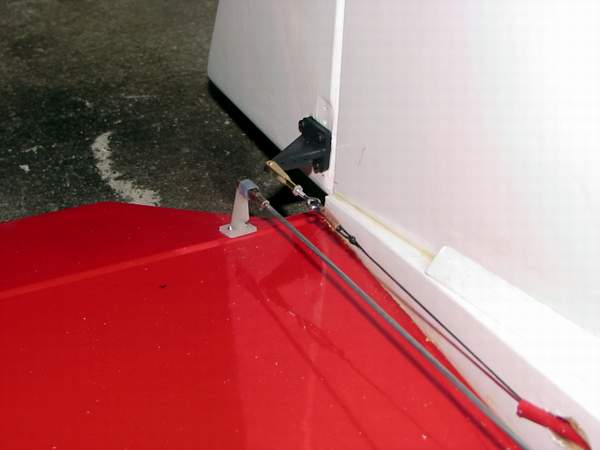

Aerospace Composite sells a nylon coated kevlar called KevCord. They also sell these 4-40 bolts with a hole in the middle. On the surface end use the bolt and simply knot the kevcord and pull tight. On the servo end use a sullivan 4-40 eyelet, but make sure it is smooth (no burs). Knot the kevcord and put a drop of CA on it. Great system.
Craig.
