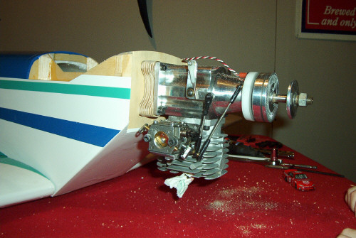

I put a Fox 2.4 on the nose of mine. I am still building though.
