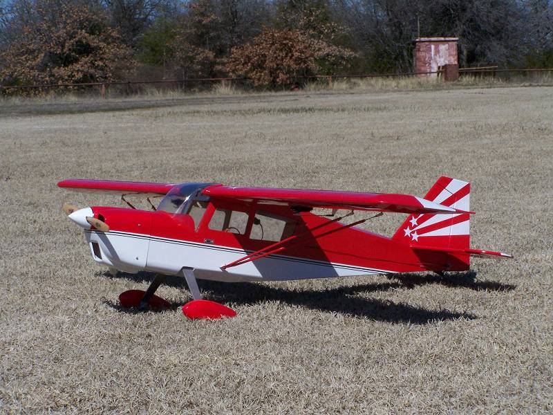

Hi, I have been flying a Phoenix Models Super Decathlon ARF this last summer. If I let it glide on its own while coming in to land, sometimes it slows down too much the ailerons suddenly become ineffective and the plane will start to drift to one side or the other with out the ailerons having any affect. Has any one else noticed this?? [X(]

On a more serious note, and having had this model before, I have witnessed the symptoms you described. The airfoil of this plane and the small chord of the ailerons does contribute to a lessening of thier effectiveness at slow speed. Being a scale-type aircraft, you have to fly it all the way to the ground. Much like a Cessna, a nose-down attitude should be maintained to keep airspeed above stalling and allow the wings sufficient airflow to maintain thier control responsiveness. Flair should begin at about 2-3' AGL with decent amount of approach on final.

Thankx for the feedback! I thought the sympton might have been due to the wrong setup on my part. All my other planes will keep sufficient speed up with out interferring with its self sustained glide path so that all I have to do is keep the plane level and lined up until its time to flair. On this plane I have to hold some down elevator to keep the nose down until I am low over the runway. I did have a 40 size Zero that had a very fast glide unless I held in lots of up elevator to slow it down. It was controllable but you had to be on top it. On the plus side, it made the plane very easy to land even in windy conditions.

I never did anything about the landing gear area. I am not sure what black stripes you are talking about, so no I didn't add any. Here is a pic of my plane at the field. You can see the servo lead wires hanging down inside the fuselage. [8D]
