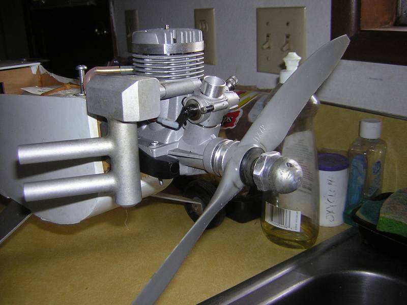

Can't get enough thrust to get our Bob Cat plane flying. We are using a 60 2 stroke engine with a 12x6 prop. Do we go up or down in size and pitch to increase thrust?

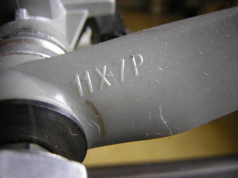

Engine is a Thunder Tiger Pro .61 Prop is APC 11-7P. Flys my 8.5 lb high wing "spy plane" well, not fast but well. I suggest you try an 11-6P or -7P. If you want speed go up in pitch, thrust go down in pitch. Cliff
