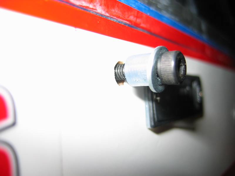

Well----I've not made any SERIOUS changes, although I am using larger dia. wheels (3")---Also 1/4" length of large fuel tubing under each canopy screw hd. (allowing it to compress & act as a lock), they can & WILL vibrate loose!---I just happen to like "Sullivan" tailwheel assy. & so thats what it has---Thats about it, all the other hardware (except wheels) seems to be good, IMHO, maybe the "Best bargain in the store" for the money----OH! & the control surfaces are VERY sensitive!!---Especially the elev.---It's HUGE for the size of the airplane!!---Now about SERIOUS changes---I am considering cutting the elev. counter/balances off & attaching them permanently to the stab & possibly shorting & doing the same to the ailerons (4" or 5")---(I'm sure you can tell, I'm NOT a 3D flier)---Hope this helps---

Thanks again. can you post a picture of the screws an fuel tubing assy on your canapy it would be a great help.
Thanks very much.
M64
Old 12-15-2006 | 07:04 PM
My Feedback: (48)
Joined: Dec 2003
Posts: 990
From: Millington, MI
Default RE: Phoenix extra 330s fire wall?
Not "Rocket Science"---But it doe's work---Tighten hatch bolt only enough to compress tubing approx. 50%---

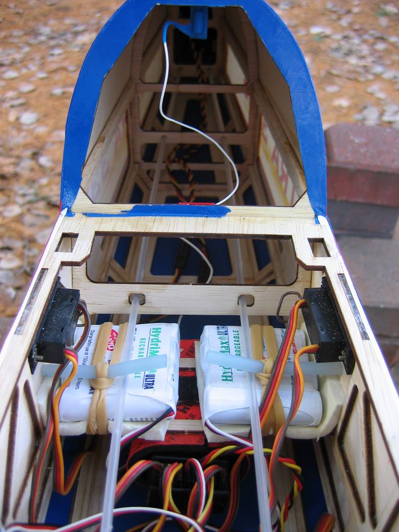

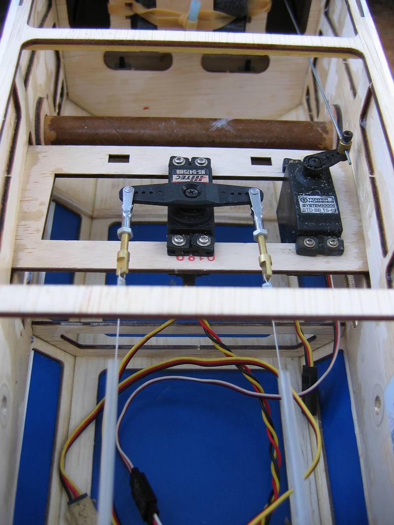

can you post some pics of your setup inside your extra.
what is your flight tome with the stock tank?
M64
Old 12-17-2006 | 02:02 PM
My Feedback: (48)
Joined: Dec 2003
Posts: 990
ORIGINAL: M64
M64
Stock tank + YS110 = 12/15 min. I guess---More than enough for me!!---

great pics. why 2 batteries?
M64
Old 12-17-2006 | 07:13 PM
My Feedback: (48)
Joined: Dec 2003
Posts: 990
ORIGINAL: M64
M64
Just do a search on "Redundant batteries"---Easier than me trying to explain---& I needed tail weight anyway, might as well make it usefull!---

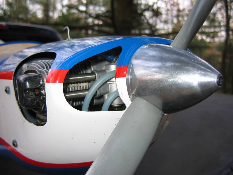

is the YS 110 a 4 stroke. can you post any pics on the engine, cowl, etc
M64
Old 12-18-2006 | 07:28 PM
My Feedback: (48)
Joined: Dec 2003
Posts: 990
ORIGINAL: M64
M64
Yes, the YS110 is a "Supercharged" four stroke---
