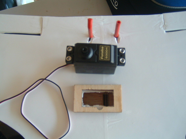

P.3 of instruction manual: shows how to apply the aileron servo on the lower wing. Included is a pic of it. Q1: The hole where the servo tray goes is not big enough. Does the servo tray go on the outside of the wing or is it flush. If it's flush, I will have to bore out more of a hole. Also using Futaba 3004. The tray is not big enough for the servo. What suggestion would you have for this problem?

wait a min though... this thig is for aileron control right?.... you sure you got that hole in there correctly? looks to me it should be virtical and not horizontal as it is in this pic
(like it should be turned 45 degrees left or right)

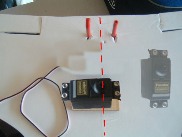

I've dinked around with your picture a bit to more clearly show what I'm going to now try to put into words.
The servo goes into the hole with the output shaft aligned with the centerline. Your picture shows it "backwards", but I'm guessing you simply took the picture to show the relative sizes, not orientation. whatever.... The centerline goes exactly between the two aileron arms. It's fairly obvious that your servo is too large for the hole. I used a Hitec 225 "mighty mini" servo in my 40S. I used it because it fit the plywood, for one reason. It's also lighter than standard servos by a half ounce, for a better reason. And is as strong as almost all standards. It's only about $20 from Tower and works with almost any brand RX.
The plywood tray goes on the outside of the wing surface. It actually places the servo output arms in better alignment to the aileron arms. It's obvious that the one that comes with the ARF doesn't match up to a standard servo. It doesn't have to stay in one piece to work perfectly. I'd saw it into two pieces and glue the two pieces where they'll match up to that big servo, if you stick with that servo. (truth is, I'd use a Hitec225 really) You'll have to open up the wing a bit to take that big servo, but the ply will provide all the strength needed when it's glued over the new hole in the wing.
The servo can go spanwise or chordwise. It won't matter which way just so long as you align the output shaft to the centerline. I've drawn the centerline with a red dashed line.
I've also turned your servo around an placed it "right" over the hole (with the output shaft on centerline). I've also cloned the servo and placed a clone over to the right, oriented chordwise just to illustrate the chordwise lineup. There is no reason to prefer either spanwise or chordwise. Either will work good.

Here is how I'd cut the plywood tray you have. And how I'd glue it down over the enlarged hole. It would now fit the servo. Matter of fact, it could be placed to fit a Quarter Scale servo if you wanted to.
It would be sufficiently strong that way.
However, since I've got maybe a ton and a half of model building wood and supplies, I'd simply make a new one-piece tray to fit the servo. But it's certainly not required to do it that way. (OK, maybe it's not a ton and a half, but it's certainly close to a ton.... and all contest grade!)

Got it on the aileron servo tray.
1. Bought a Hobbico CS 35 mini servo which was reccomended by someone. It fits perfectly in the plywood tray. I peeled back a little covering from around the rectangular servo tray hole in the wing so I can epoxy the plywood tray ON TOP OF the wing. I will then mount the servo into the plywood tray with the associated hardware/servo screws. It is aligned as per your instructions.
