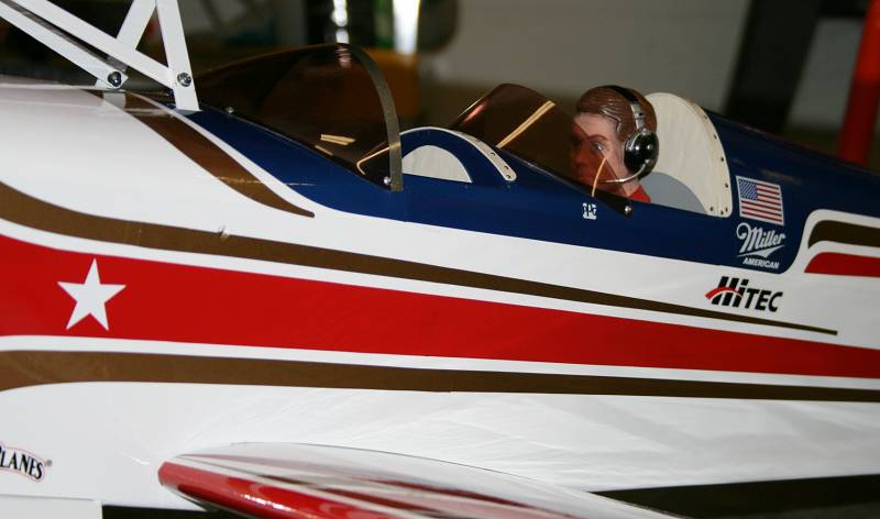

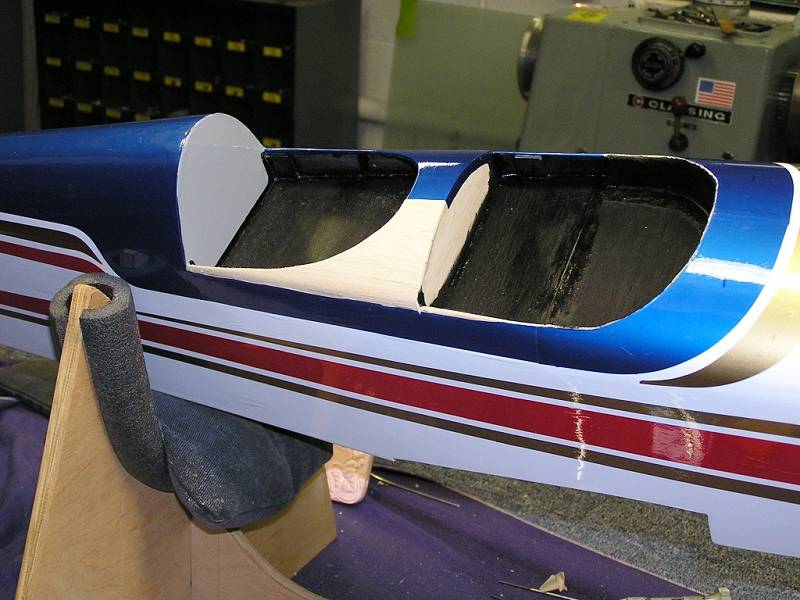

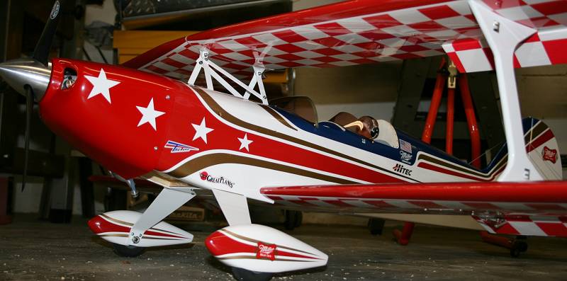

Almost done with my Skybolt, I'll name it 'Wings 'n' Beer'. Here are few pics. Have yet to install the aileron interlinks, batteries and receiver. Everything went together with no problems. The windshields were cut from the stock canopy. I added epoxy/chopped fiber to the back of the firewall joints, installed a 20 oz. fuel tank that is moved back to the servo tray, and a 6 oz. smoke tank behind the firewall. The smoke tank is mounted to a hatch cut into the bottom of the fuselage just behind the firewall. I'll get some pictures of those mods when I take it apart this week.
Power is a YS 110, 14 X 7 MA 3 blade prop, Tru-Turn spinner, Hi-Tech sevos, Great Planes pinned hinges, silver elastic thread for simulated flying wires, plastic clevises were replaced with Great Planes metal clevises. The pilot is a Great Planes item that I 'aged' with a black colored pencil and added an aluminum mic boom.

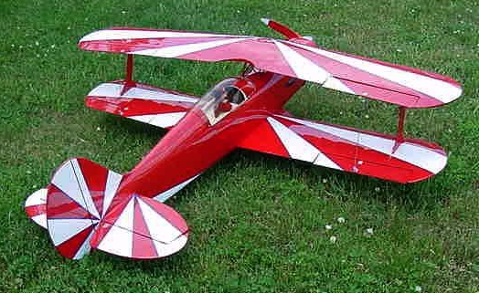

Very nice job! I've had the kit version of this model for over two years and, of all the planes I have, this is the one I always fly first when I go flying. Note that I took a slightly different approach to the pilot figure. I think these are highly underrated models. Hope you enjoy yours as much as I have mine.
Mike
