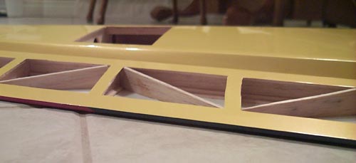

I just substituted the supplied CA hinges for flat pinned hinges and have never had a problem with my DP Extra.....and believe me, if those surfaces were ever going to come loose they would have by now.
What I did do that may be considered overkill is to remove a bit of covering from the bottoms of both the aileron and wing and glued them from inside as the hinges make it through the wood and stick out on the inside a bit. There isn't a whole lot of wood there in my opinion so I wanted to make sure they could never pull out. Better safe than sorry. Not sure about the wood in the new kits as mine is the older model. Its a really great flying plane...you'll love it.

Default A few old shots you may want to look at
I shot these not so great photos when I uncovered my wings and ailerons. In the one shot you will notice that the LE of the aileron is actually a small piece of wood that has sheeting on the top and bottom. It gives the illusion of wood that isn't there. Again...not sure what the new kits are like but mine didn't have much to hinge into.

Another...and none of the cross bracing is original. All the bays in mine were empty.
