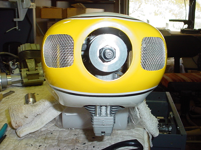

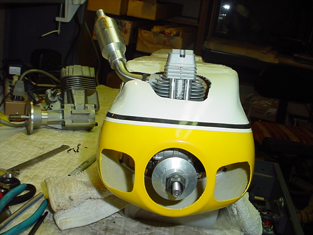

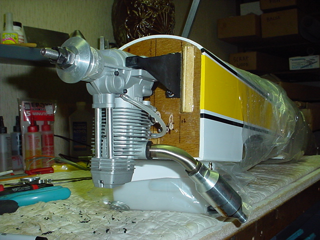

Backwing,
A 108 w/ a Pitts muffler sounds great. You won't be sorry, you'll see. The cowl on the DragonLady begs for an in-cowl muffler, don't it?
I made the mistake of putting a standard ST muffler on my last one, and was sorry I did afterward. Already have a new ST 2000 w/ a Brisson just waiting for it.
Somebody mentioned the clearance these have up front to swing the wood, and just wanted to let you know that I used to swing an 18x6-10 with no problem at all. New one will swing the same size! [sm=surprised.gif]
Gary

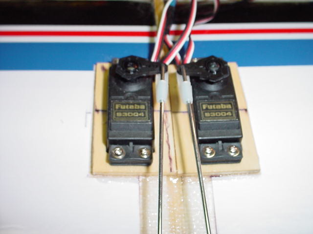

I don't mind torque rods either, especailly if they are allready in.
The Lady will spend most of her time chugging around in the 60-80
MPH range, so I don't expect any aileron flutter from soggy torque
rods. I will mount two ailerons servos like I did on this Twin Star.
You have the safety factor, and you can have a bit of fun with
flaperons, and the flap/elevator coupling as well....
I'll go with dual elevators servos as well....mounted fore or aft,
depending where the weight is needed for the balance.
Dave.

"How complicated would it be to add a second aileron servo "?
Easy enough to double up on the center mounted servos....using
the torque rods. However, if you wanted to mount dual servos in
the wings....it will take quite a bit of additional work.

....get the pumper....yes there are Major advantages. You can mount
the tank and engine anyway you like, and still have constant fuel
flow to the carb....no matter which way the plane is flying, as well.
In my case....with the carb spraybar....fully 1 3/4" below the tank
centerline....I may have to fit a Cline pump/regulator to fly inverted
without the carb leaning out. No big deal....lottsa planes require
pumps....but with your pumped OS....you can just be smiling away,
as us non-pumpers are fiddling with our planes.
Dave.
