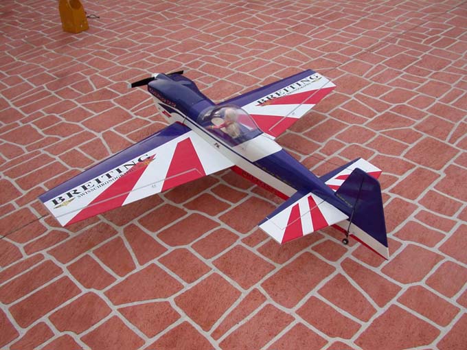

First flight today, the instructor took the plane up without any major problems. very minor trim needed and handed over to me. I came in for an approach but the plane seems too flared up slightly after the 3rd attempts the instructor took the control for a try. Just at the moment the throttle broke at ¾ throttle. So we flew around until it ran out of fuel. The instructor was still flying the plane with no engine and it glides beautifully I think he thought he could bring it in at a stand still but 3 feet off the ground tip still and came in hard. I was lucky the only damage was the landing gear was torn back. I will fix tonight.
The other thing is to add some down trust, I only put 90 grams of weight on the nose. The plane flies quite nice, looks good in the air. OH and some glue on the grub screw that holds the throttle

Nice picture.
I guess your final configuration was :
The rudder servo in the servo tray, the elevator servo still in the tail and 90 gr. extra weight in the fire wall. So your c.g. was around 140 mm. Is that right ?.
As you describe your approach, seems to me the plane is a little tail heavy.

First flight with no engine could be worst, but now you have to fix it and fly again
your plane still tail heavy and when you flare it maintain its altitude thats mean you are little high over the ground then hit it hard because stalls
When you approach for a landing you have to come a little hot once over the threshold chopped the throttle and let the model glide to the runway then flare a few inches off the ground in all this process you have to control the altitude with throttle and speed with elevator
If you are getting short of the runway add power and coordinate with the elevator the rate of sink and if you are coming to fast go around don´t force the landing because this plane is going to bounce
I suggest you check the low speed performance do some stalls at high altitude before you landing this practice help to know when to flare
I hope this helps

I don't think the plane is tail heavy, the plane glides great with no engine
I fixed plane and added a little down trust, I with test tommorow and post results..
If still flares I'll add some more wieght to the front and test agian

First flight for my Cap 232 was succesful.
Since I removed both servos from the tail I was able to balance the plane at 120 mm from leading edge with only 100 gr. extra weight, but I think I could remove this weight gradually. So total weight for the plane would be 3800 gr.
No trimming needed except up elevator.
Even the landing was very soft, the plane bounces e little when touching the ground.
