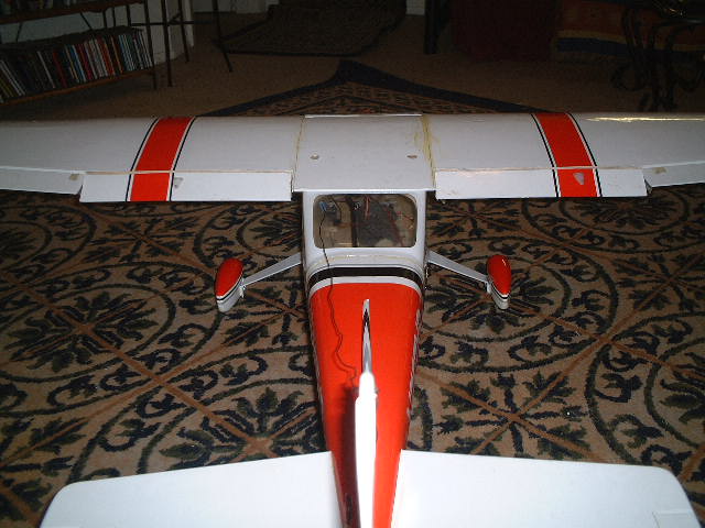

Default I added flaps to mine
I decided to add flaps to mine to make it land slower and with a higher angel of atack. I also like the flaps because they make the plane more realistic.
Old 08-11-2003 | 08:58 PM
  #86
Posts: 80
From: South Florida, city of Davie, fly at Marckham park
Default Great Planes Cessna 182
another view
