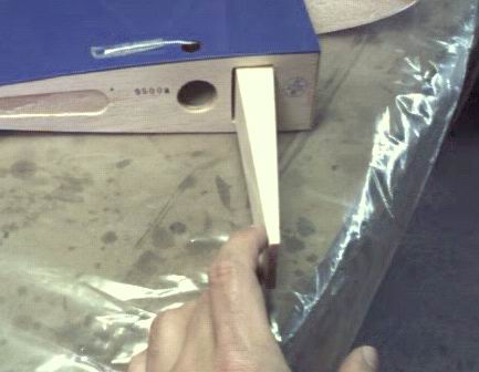

Here is the joiner problem in real life. it fits in the socket as loose as a goose. I glued 3/16" aircraft ply to the back and will sand to fit tonight. It is also too short and I'll add a peice on the end before I'm done. I'll shoot a pic if your all interested. I got this tip from somewhere on this board, I forgot who else did it....

Here is a shot of the joiner setting up, sorry it's blurry- it's a cheapo camera.

Rickp, I ended up laminating front and back of joiner with 1/64 ply. It worked fine, and wings lined up perfectly. I heard some people were just ooverfilling with epoxy to fill the gap, I didnt think that was a good idea, so I laminated. Daz...

1/64"?? I first cut out 1/32 shims and two of them were not enough. I'm sure 3/16" will be snug, but thank god for belt sanders.

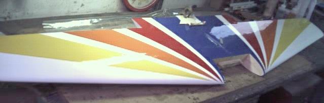

I told you I wasn't going to break any speed records assembling this thing. Limited time only lets me get in a few minuits every so often. I got the wing finally joined. Here's some Eye Candy.
Comments?

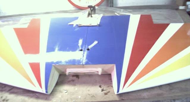

I took a tip from a buddie of mine. This time I glued the wing dowels in first, then cut two small sections and stuck them in the wing bolt holes. Then I used Rubber bands to hold the whole mess toegether nice and tight. Two small C-clamps near the rear line up the TE while it's drying. Worked great.

I removed a 5" section of covering from the center of the wing and added 4" wide medium weight fiberglass. It didn't weigh much but it certainly strengthened the joint.

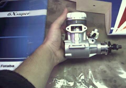

I'm trying to bust into 3D manuvers and my Cap232 (or me) is just not cutting it. I'm hoping the throttle control I'll have with the 1.6 will do that for me.
Rick
