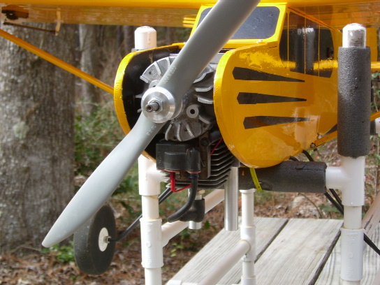

I just finished one for towing duties using a Ryobi 31cc. It has way more power than I need but will be good for pulling things. It weighs 13lbs dry and flies really nice and smooth. Just flying around at half throttle is alot of fun.

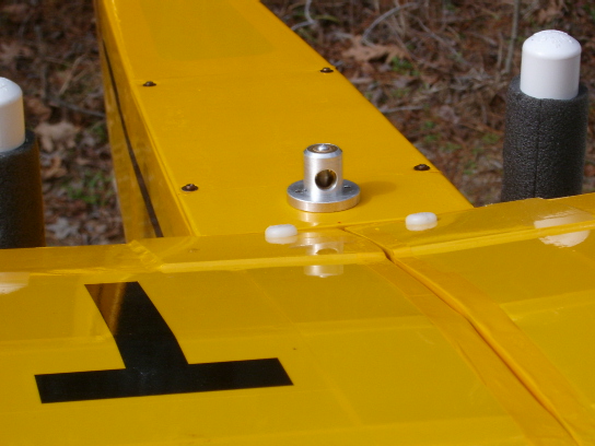

Forgot to add pictures I moved the firewall back several inches and ended up putting the radio in the fuselage area behind the wing for balance. I also used two servos for the elevator (one in each side) and a pull-pull for the rudder which I enlarged quite a bit. I need taller landing gear for the 18" prop which I have not done yet. The towhook I custom machined myself.
