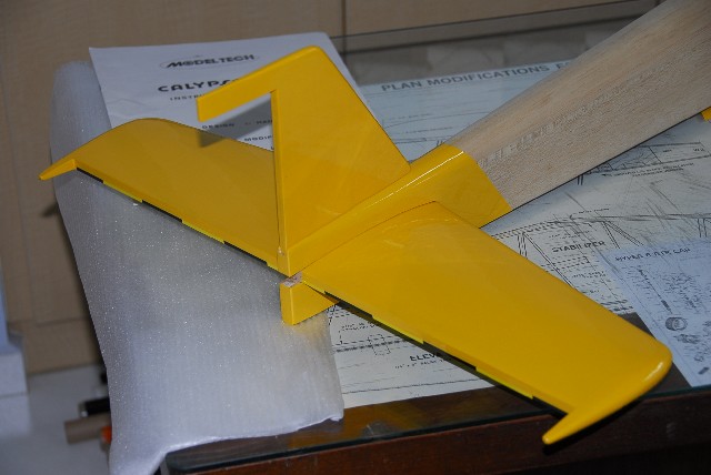

I have embarked on another build, this time an ARC. Another legend from 1970's

You can see the canopy has turned yellow from years of storage.... Putting a pilot doll woould be useless in this case. So very likely for me to paint it.

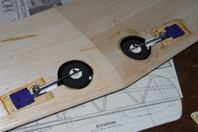

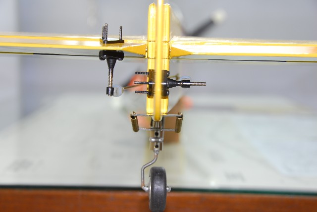

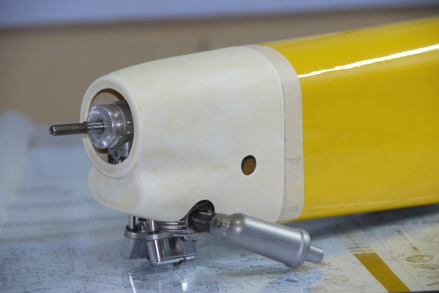

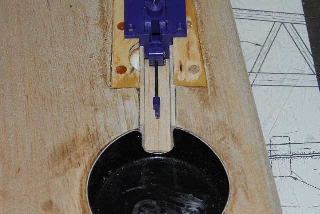

I am intending to install mechanical retracts and intall a Saito 91. I am wondering will the length of the landing gear be enough to clear the 13 or 14" prop if I use the original retract cut out?
ID:	622562   Click image for larger version
ID:	622563   Click image for larger version
ID:	622564   Click image for larger version

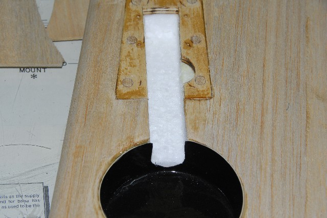

Old 02-16-2007 | 04:57 AM
mechplas's Avatar
Joined: Nov 2006
Posts: 583
From: Singapore, SINGAPORE
Default RE: Modeltech Calypso 60
ORIGINAL: FalconWings
That is sucha nice model!! I had two and absolutely loved them. I flew mine on a Saito .90 as well, plenty of juice for F3A.
Wow! nice to see some trophies also....great. how did you do the retracts?
Now I am cracking my head to see how I should mount the retracts. To cut the metal rod or shift the mounting location further away from wing joint.
Old 02-16-2007 | 10:09 AM
FalconWings's Avatar
My Feedback: (57)
Posts: 6,998
Received 15 Likes on 13 Posts
From: Fort Worth, TX
You got plenty of wood in the retracts mount, carve some out and move the retract outboard. I'll be honest, the Calypso can land at 2mph (shhh!, don't tell anyone). It floats to the point of being ridiculous, so even if you have a 1/4" prop clearance to the ground, the prop will never touch it.
During pattern competitions, I had callers that would yell "deadstick" to the judges thinking that my engine had died upon finishing a sequence. It happened more than once. The engine never quit, I just had to go to low-low idle and glide for a while for the model not to overshoot the runway.
Old 02-16-2007 | 05:08 PM
mechplas's Avatar
Joined: Nov 2006
Posts: 583
Sounds faily simple. I think I will sand the wood by a quarter and get that much extra clearance just in case. You must be a pro, I don't think I can avoid prop contact with the ground at 1/4inch prop clearance.
What servos did you use on your Calypso? Thanks!! I was thnking of standard, maybe 3 to 4kg torque servos.

The retract and aileron servos.
ID:	628532   Click image for larger version
ID:	628533   Click image for larger version
ID:	628534   Click image for larger version
ID:	628535   Click image for larger version

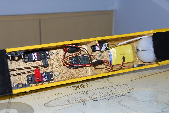

Old 02-24-2007 | 07:37 AM
mechplas's Avatar
Joined: Nov 2006
Posts: 583

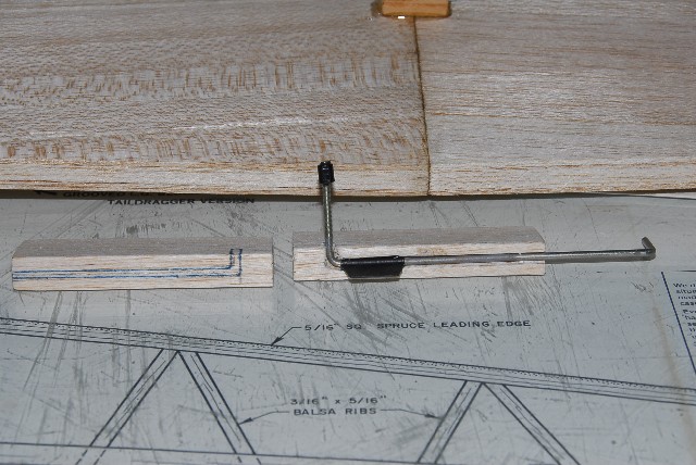

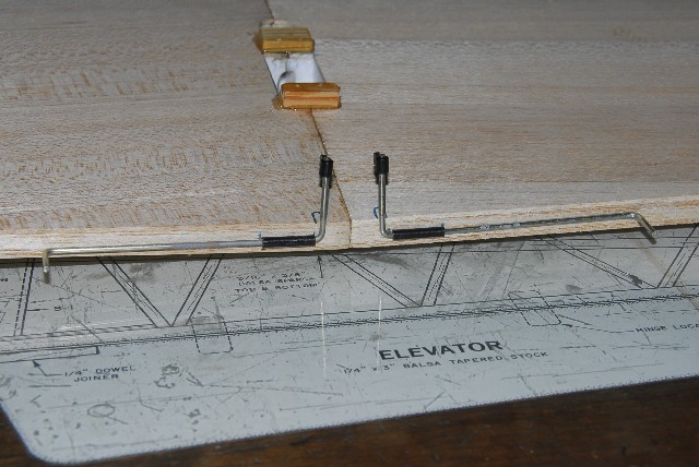

Aileron torque rods.
ID:	628543   Click image for larger version
ID:	628544   Click image for larger version
ID:	628545   Click image for larger version
ID:	628546   Click image for larger version

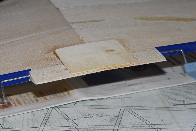

Aileron hinges.

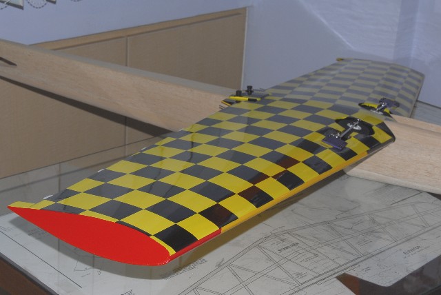

Covering of the wing. Time for a long break.
ID:	629756   Click image for larger version
ID:	629757   Click image for larger version
ID:	629758   Click image for larger version
ID:	629759   Click image for larger version
ID:	629760   Click image for larger version
ID:	629761   Click image for larger version
ID:	629762   Click image for larger version

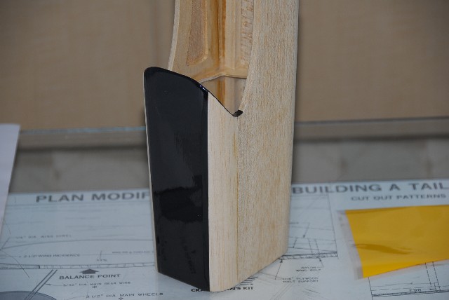

Old 03-24-2007 | 11:15 AM
mechplas's Avatar
Joined: Nov 2006
Posts: 583

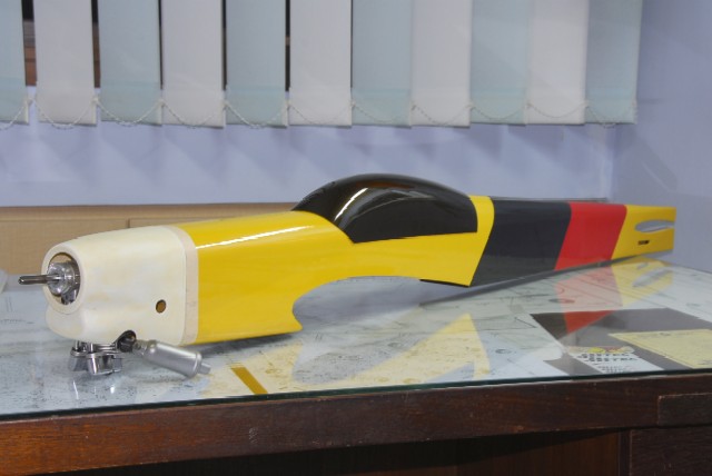

Made some progress on this plane. So far, completed part covering on the fuselage.
ID:	648730   Click image for larger version
ID:	648731   Click image for larger version
ID:	648732   Click image for larger version
ID:	648733   Click image for larger version
ID:	648734   Click image for larger version

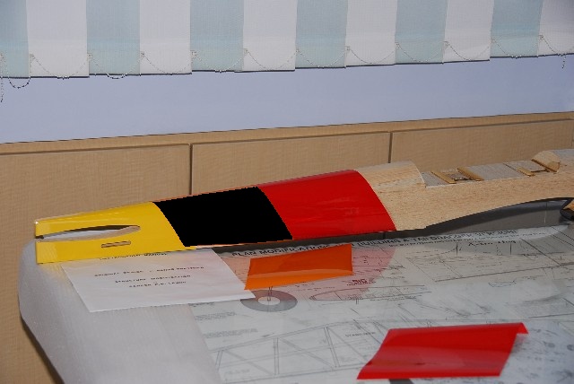

Old 03-26-2007 | 12:11 AM
mechplas's Avatar
Joined: Nov 2006
Posts: 583
Now I am wondering if I should do black or orange after the yellow.

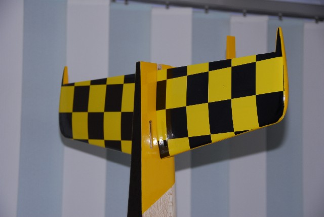

Old 04-16-2007 | 09:36 AM
mechplas's Avatar
Joined: Nov 2006
Posts: 583
Finally finished the bulkhead and fuselage covering.
ID:	665778   Click image for larger version
ID:	665779   Click image for larger version
ID:	665780   Click image for larger version
ID:	665781   Click image for larger version

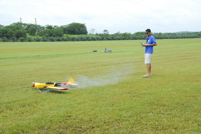

Old 04-30-2007 | 09:17 PM
mechplas's Avatar
Joined: Nov 2006
Posts: 583
Maiden successfull.

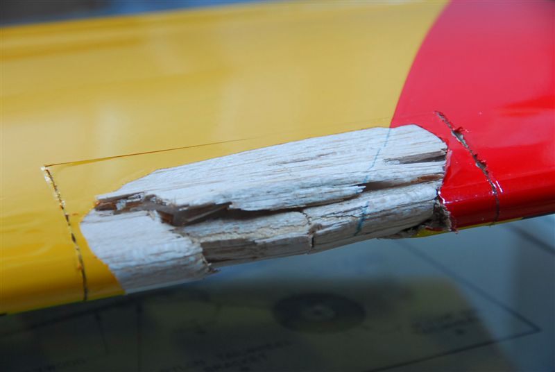

Overshot the runway. Steered straight into the shrubs and one small tree that did the stopping....snap-stop.
ID:	695124   Click image for larger version
