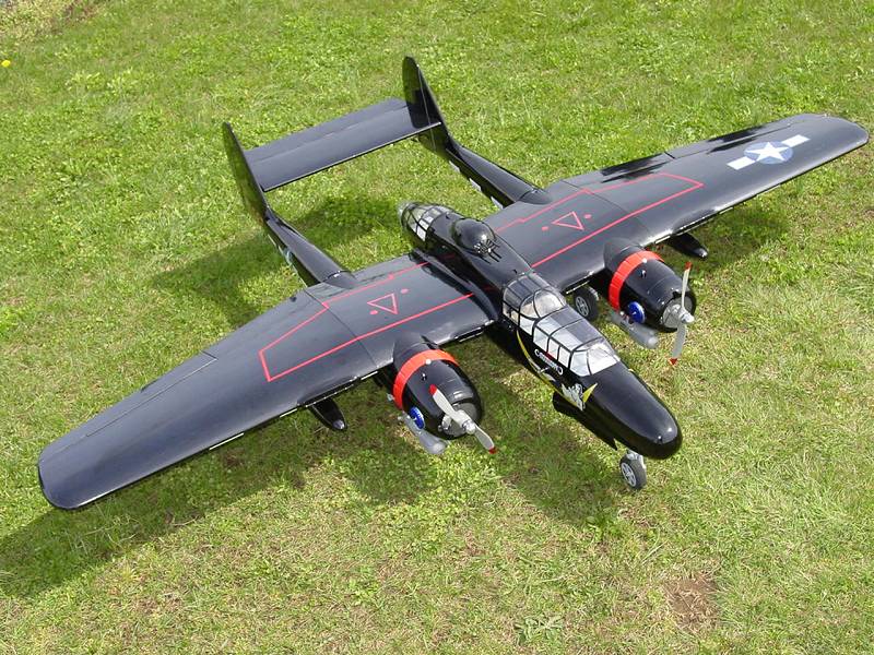

I have more than fifty flights on my P-61 in all temperatures (NJ is like that). Lately it has been hot and very sunny.
The black covering needed an intial re-shrink after the first day in the sun. Now it stays shrunk tight. The plastic booms and center pod have shown no tendency to melt in direct sunlight, even when hot to the touch.
I do cover it up with a white sheet if it is going to left out there for hours on end- just being sensible - but it handles the heat and the sun pretty well. The canopy "glass" does not distort either.
I thought that this thread might like some actual field data. Regards,

Looks good. The guy gave me a pair of 91fx's for his with pitts plus the retracts. They went in okay. Probably have it finished by the end of the summer

Wow! 91's.
I would consider 61's but the 52 2-c's in it right now haul it very well. They let me do a big loop from level flight.
One thing to consider is prop clearance. My 11 x 6's cut a lot of grass. What prop would you use on the 91 FX's?
Also the plane comes out right on the money as regards the CG with two MAGNUM 52 two cycles. My battery pack is in the rear of the center pod. The only engine upgrade that I would consider would be two 61's.
This plane does fast passes, either way up with authority and climbs out at each end with ease.
Just realised something--Sorry to insert this much P-61 data in DH88 thread.
