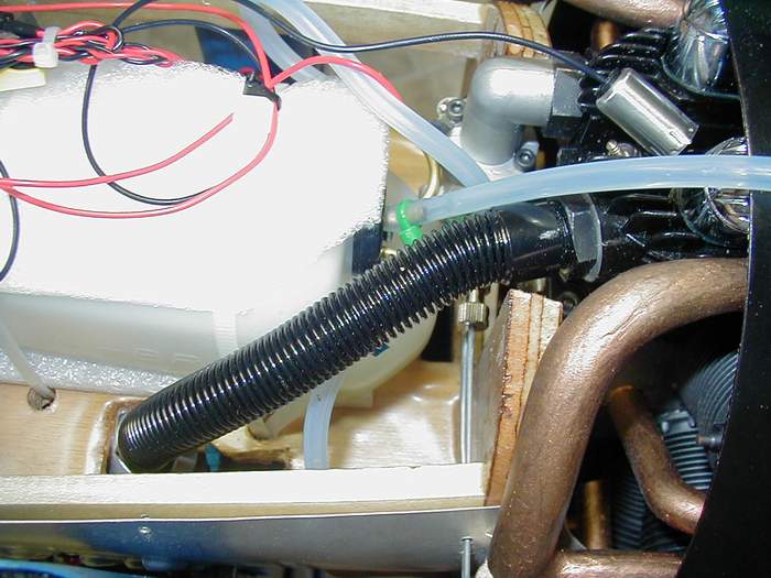

Default install
one more

Sounds like you are having fun with the Willow. I got tired of waiting for the replacement tail wheel bracket and I put my Saito 150 in a DPM Ultimate Bipe. I won't do anything with the Willow until this winter when, hopefully, I'll get a Saito 120 for Christmas.
Would you take a picture of how you have the exhaust exit the bottom of the plane?

Default 3Seabees Willow
I could take a picture, but I don't think you could tell anything from it. With the flex extension, pictured above, the end of the muffler ends up right at the pre-cut louvers on the bottom of plane. Just enlarge one a little and viola its done.
