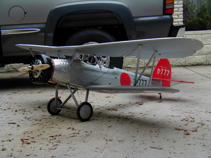

Here is mine assembled
Old 04-08-2003 | 01:15 PM
My Feedback: (17)
Posts: 61
From: Rootstown, OH
Default 3Seabees Willow
It looks really good! Is it ready to fly? My flying wires were not marked. I know where they go, but I don't know how the wing angles should be set.
My Wilow is a land version, but I had it painted with the float plane colors.
Old 04-09-2003 | 12:06 PM
ilike2fly's Avatar
My Feedback: (23)
Joined: Dec 2002
Posts: 184
From: Mobile, AL
I just got it so it hasn't been flown. It is WAY tail heavy and I am trying to find out if you are supposed to add a pound of weight in the nose. No luck so far. As to the flying wires mine are a b**** to install and you can't get them tight, I really don't see how they can be safely used. I am going to rig regular wires with turnbuckles to tighten. They won't look as scale, but neither does a pile of sticks, if you try to fly with the supplied ones. When you rig the wires tighten them for support....don't change any of the incidence in the wings. Also how did you hook up your aileron control wires?

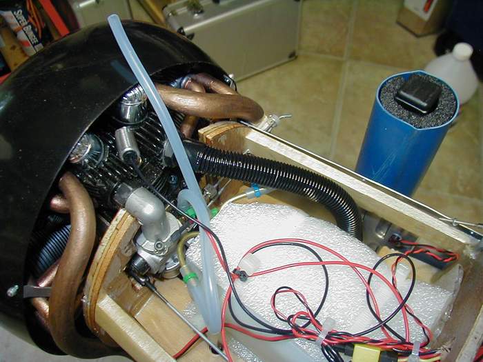

No, the engine is not hard to install. I was able to route the muffler inside so nothing protrudes.

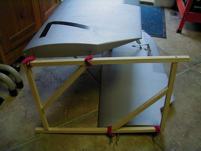

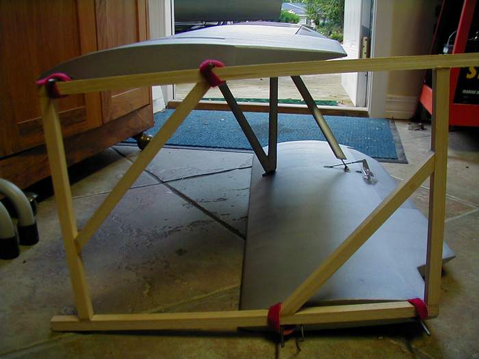

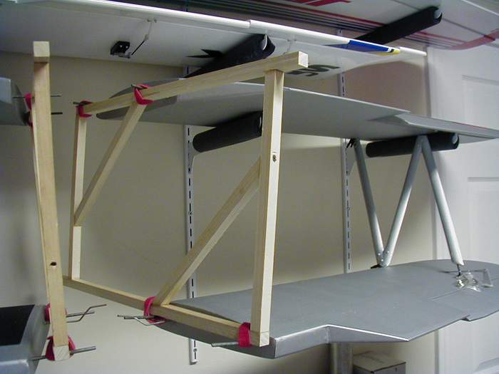

How's your Willow coming? I had to fabricate new flying wires so I could tension them. I also built a jig to hold the wings together for assembly/disassembly. This means now I can have the wings on in under 5 min!!
Old 04-18-2003 | 04:37 PM
My Feedback: (17)
Posts: 61
From: Rootstown, OH
Default Willow
Still waiting for the tail wheel bracket. Can you send me the picture of the jig that you made to get the model to the field?

Old 04-22-2003 | 11:22 AM
ilike2fly's Avatar
My Feedback: (23)
Joined: Dec 2002
Posts: 184
From: Mobile, AL
Default willow
here are pics of wing jig.
ilike2fly's Avatar
My Feedback: (23)
Joined: Dec 2002
Posts: 184
From: Mobile, AL
Default willow
Another
Old 04-22-2003 | 11:23 AM
ilike2fly's Avatar
My Feedback: (23)
Joined: Dec 2002
Posts: 184
From: Mobile, AL
Default willow
one more
Old 04-22-2003 | 11:24 AM
ilike2fly's Avatar
My Feedback: (23)
Joined: Dec 2002
Posts: 184
From: Mobile, AL
Default engine install
This is installation on Saito 150
