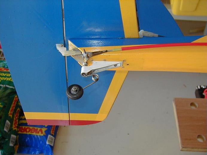

Default Steerable tail wheel
Here's what I did. I also have 1 oz of lead back there.
With a FX 46 on 15% CP and 12 1/4 x 3 3/4 prop it will go vertical at less that half throttle.
It a fun plane.
Bill

Default Magic 3D Balance Issues
Thanks, I'm looking forward to flying this bird. Now if you guys can fix the weather.
What servo is it attached too? The Rudder servo?

Default Steerable tail wheel.
Yes, it's hooked up to the rudder servo, outside hole.
