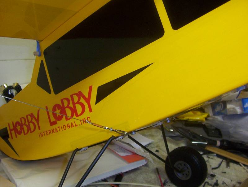

I have this one about ready to go, I still need to mount the tank and the Spektrum receivers, there is a Saito 1.00 on the nose. The flying wires are the result of the strut hardware not being included, I got struts but no hardware.
