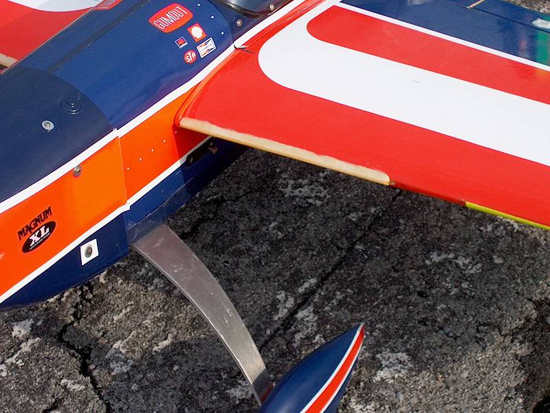

Here is a photo of some that really worked. This is a 15 year old ARF Extra. It was a tip stalling fool. It was so bad my buddy didn't like flying it. Another guy at the field suggested stall strips. These are 1/4 tri stock, faired in with microballoons & Epoxy. He later painted over them and most people didn't even notice they were there. They turned the plane into a nice landing plane that Bob flew for several more years.
Don't let any of the guys who haven't tried them tell you they don't work.

How many % of each wing is covered with the stall strip? Also is the loriginal eading edge is 1/4 as well?

The F4U Corsair had only one small stall strip on the right wing. I would guess six inches long. On a 57 " plane I would think a stall strip made of trangle stock could be about an inch or two long placed about a quarter of the length of the wing out from the root would be a good place to start. If the plane always stalls to one side, put the stall strip on the high wing( thats the one that stalls last). This will then cause that wing to stall sooner and will compensate for engine torque.
