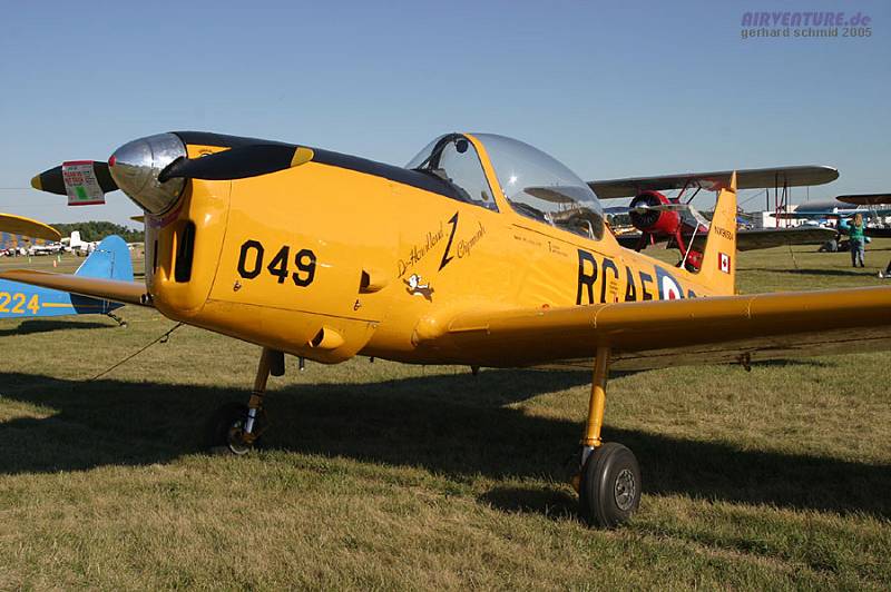

Just because you've been around a long time and have never heard of a stall strip, doesn't mean it doesn't exist
Check out photos of the Military Chipmunks and you will see a small triangle strip on the leading edge of the wing near the fuselage... "Stall Strip" Not just a lot of propwash.... which too really exsists.......

Ok guys thanks for all the advice. I can tell you that I learned a lot in the last 2 days about tip stall, characteristic of tapered wing, stall strip, and land with rudder.
From what I been hearing stall strip is not a good idea, so you guys convinced me not to use it since is not going to make the plane land any better. .
However what I don’t understand is then what is the benefit of stall strip if is not going to improve the stall characteristic of the plane??
I have read it that it is used in a real plane and here is a picture of the military chipmunk with stall strip.
Borna

In a model this small,full size functions may not necessarily scale down to your benefit.
Fly it and maybe add the strip later,then you will know for sure if its to your advantage.

Full scale aerodynamics do not translate to models. That little stall strip in the photo might help make the stall start at the root of the full scale, but it wouldn't do a thing for a model.
Think about it. A tip stall is caused when the tip stalls before the root. The purpose of a stall strip is to make the root stall sooner, so that it stalls before the tip does. That means the stall starts sooner (at a faster airspeed) with the strips than with out them.

A wing with a sharp leading edge will stall sooner than a wong with a rounded leading edge. The stall strip is not bullet proff but it works by stalling the inboard part of the wing first. Tis caused the nose to drop and airspeed come up and you keep flying. Even if one wing still stalls a little sooner than the other, the ailerons are still working so you can keep the plane level.
Washout in the wing tip will do the same thing.
On full size planes they often stalled one wing first, so they all a stall strip to the other wing to make both wings stall at the same time. In the old days this was done by cut and try.
