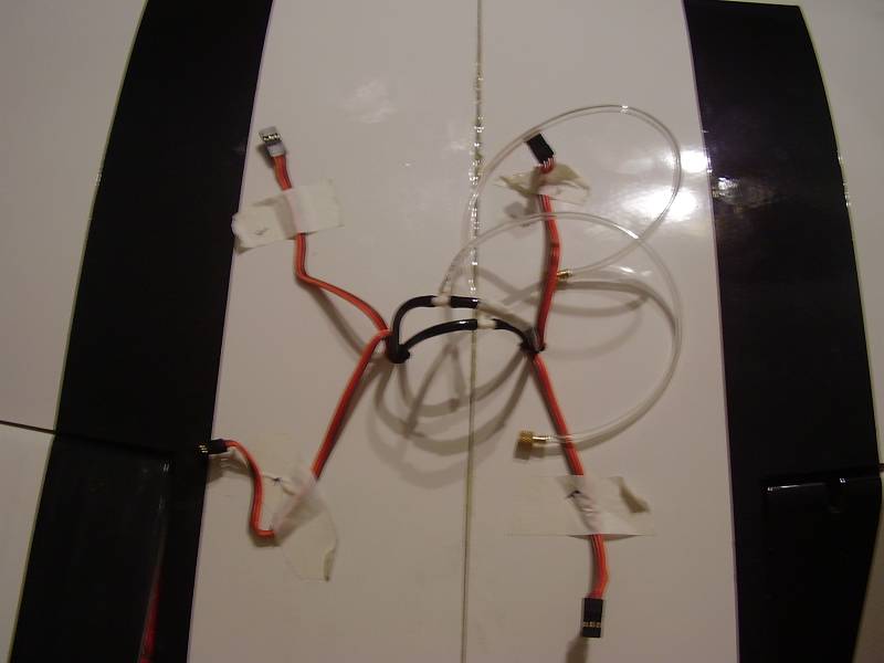

OK sorry here we go. Here You can also see the airlines I had to use because I did not have enough of the original ones that came with it. I made some very small holes in the wings to pull them thru along with the servo leads. This must be done before joining the wing halves together. You can also see the tubes used to hold the Elevator stabs onto the fuse. Very rigid. Very nice. Make sure you run some 60 grit sand paper over them before glueing in so that they dont come off.

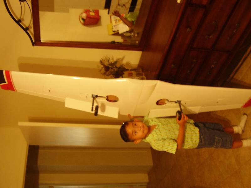

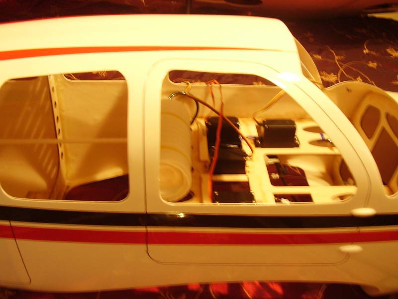

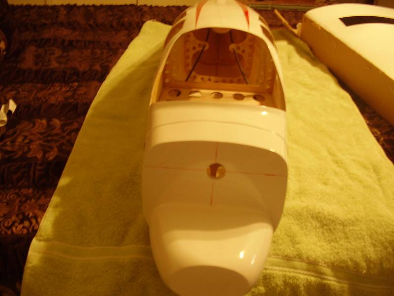

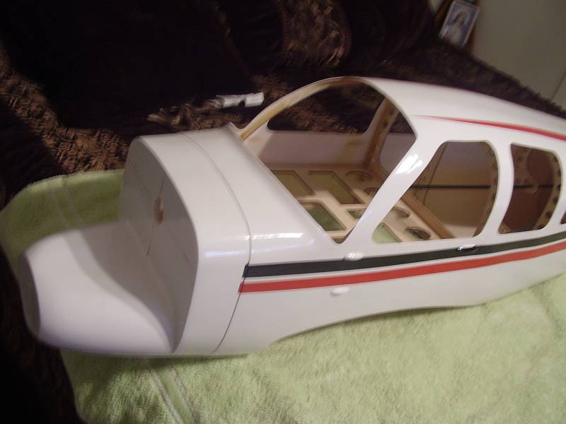

The space allowed for engine placement is very small. About 7 inches width by 4.25 high at the point where the engine should be. You lose about 2 inches when the cowl goes over the nose of the plane. So its a narrow space. Over the 7 inches and the engine heads will stick out the sides of the cowl. Im setting my engine back close to the firewall thus I will need to make a special adapter for the shaft to bring it past the nose as I did with my 182 when I used similar engine. I dont forsee any problems.

I think a 50cc twin will be way too much for this size plane, thats including weight and power.......

It may be better to put the engine farther forward, or at least try some preliminary balancing before mounting. You most likely will need to add a substantial amount of nose weight. That was my experiance anyway.

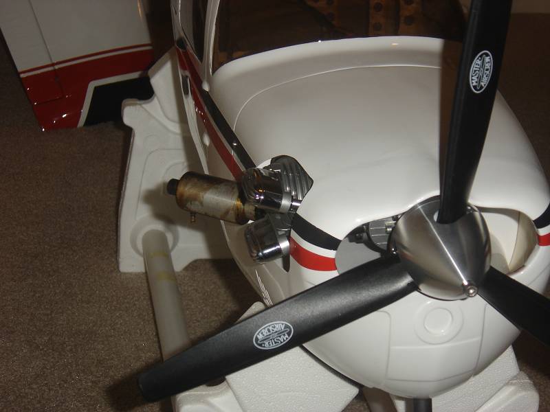

I installed the RCV 120 as recommended by the owner of KMP but that engine wouldn't get the plane going fast enough for it to lift off the 900 foot grass runway at our field.
A friend had a used Moki 1.8 that I bought and put on it, it flies great now and certainly does not seem overpowered.

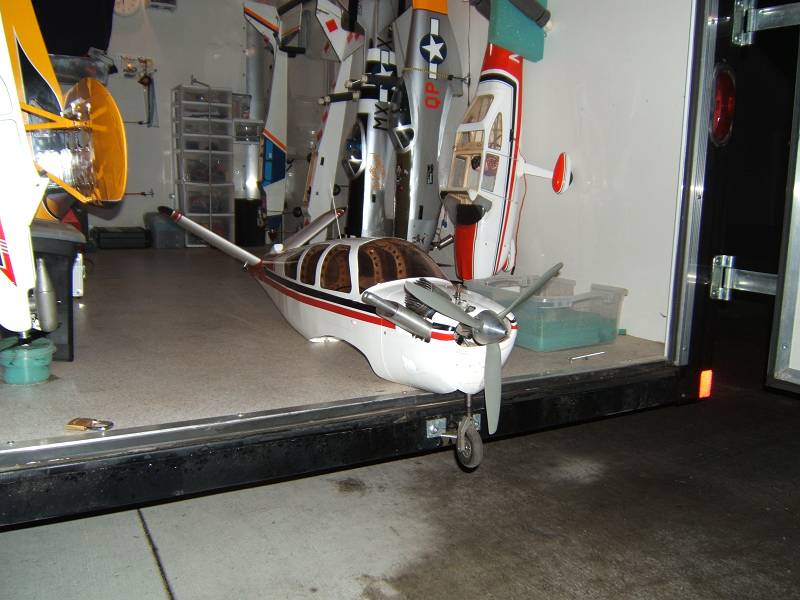

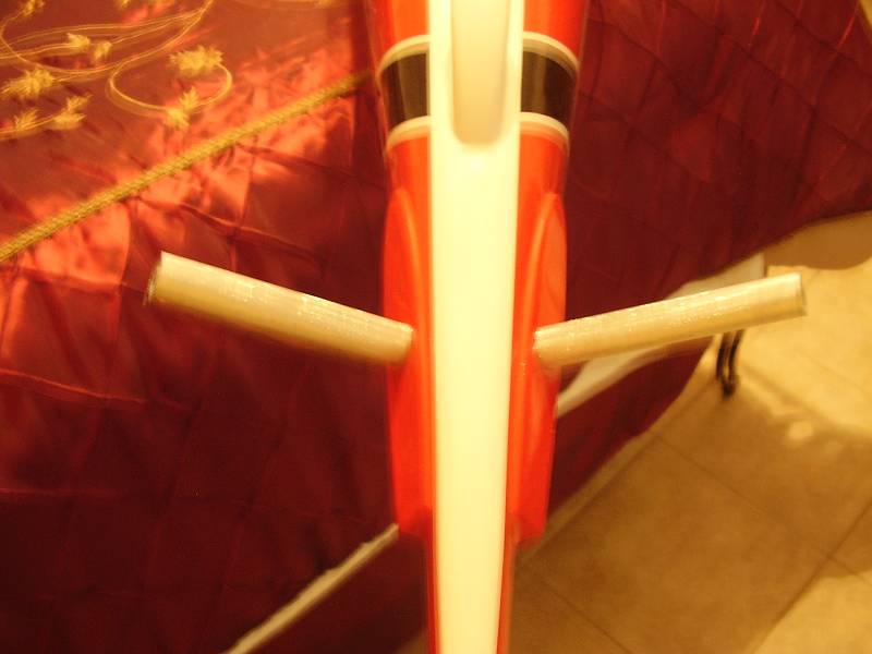

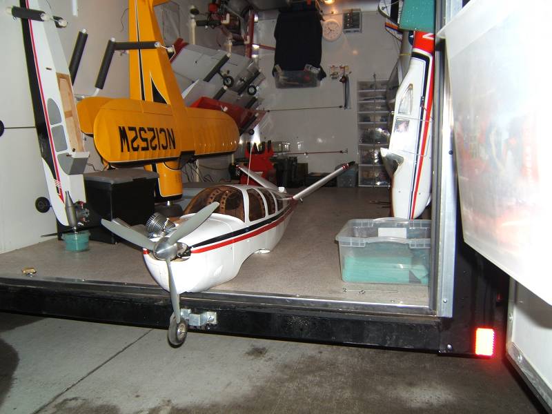

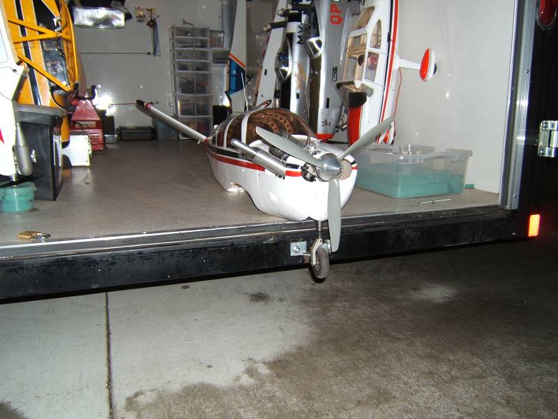

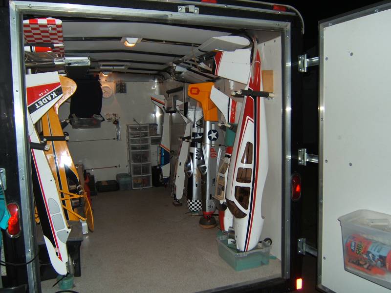

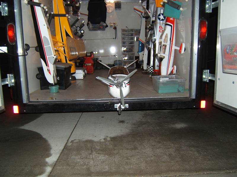

Here's some quick pics of the fuse and some of my other planes.

Hehehehe, That Moki and muffler sticking out like that really look funny, bet it takes off in less than 200 feet now!!!! Just finished programming my AR7000. Still need to install engine. Will install the Elevator stabs today. For an ARF this is taking me a long time I know.

The Moki wouldn't go horizontal, seemed to look like a tractor pulling rig vertical so I lined it up with the v-tail. It still takes quite a bit of runway to lift off though. I moved the motor a little farther forward tonight and put the receiver battery in the engine compartment and was able to trim some lead and get the plane to balance at around 19 pounds.

kingtight, I have a 26 gasser that fits nicely...only problems is the exhaust. There is not enough room underneath the engine for the muffler due to the nose retract cavity being under the cowl as well. It would have been nice if KMP would have gotten together with an engine manufacture to have the right engine/plane combination like the guys at Experimental Aircraft did with Bisson on the pusher configuration for the Velocity plane. Bisson made the awesome mufflers at the angle required for the engines installed like the webra 120. Excellent team work. As of yet I have NO clue as to anyone having an all incowl engine on this plane or has anyone posted any videos of it flying. Bummer really.....
