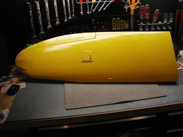

Finish installing the hinges on both wings and started the aileron servos. I’m using two JR 517 servos. The servos covers are plastic. Used five minute epoxy and the screws mentioned in the instructions to hold the servo blocks to the plastic. I did notice I will to use long servo arms. The picture below shows one cover completed and the other ready to go.

The wing is made of foam and covered with 1/16 balsa. So moving the landing blocks would be difficult. To make them stronger, I'm going to soak them with foam safe CA. Also, I found out the covering is a low-temp. The pictures attached are of the aileron covers with their servos attached and the other two is the right wing with the hole drilled in the top for the servo wire and the servo mounted in the wing. One concern I have is the aileron cover is screwed into the 1/16 balsa sheet. I think I will fill the hole with foam CA for a little extra bit.

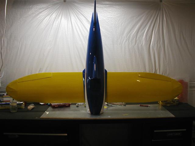

Time for another update, I have been able to glue the wings together. But, when it came to mounting the wing to the fuse the picture directions were less then desirable. First, there is no hole in fuse for the leading edge dowel. Second, they don't give any measurements for the dowel. Third, I was missing my dowel in the kit. It was time to fall back on my 20+ years of modeling building experience. Starting with a 1/16 drill bit I begin drilling a hole in the middle of the wing to mount a 5/16 dowel. Once I got the whole drilled in the wing I cut a length of 5/16 dowel to glue in the center. I made my dowel 2 inches in length and marked it so 3/4 would protrude out. I then cut a smaller piece of dowel and pushed into the hole so only about 1/16 was visible. Next I placed the wing on the fuse and centered it. By leaving a little bit of the dowel exposed I was able to determine where to drill the 5/16 hole in the fuse. After the front dowel process was completed it was time for the hold down bolts. Again I had to use my experience, CMP installed "plywood" plates on the inside of the fuse to support t-nuts. After determining the center of the plates I drilled holes from the bottom of the wing through to the fuse and into the plates. But, instead of using t-nuts, I tapped the holes for 1/4 X 20 bolts.
The pictures attached show the wing mounted to the fuse. Next adventure will be the installation of the stab. Let me know if you have any questions

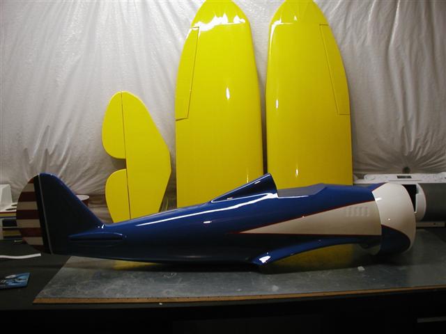

Hi folks,
Sorry it’s been awhile but I finally have a bunch pictures to show. The first two pictures are the elevators when mounted to the stab. This first picture shows the elevators extend past the stab about 1/4. I had to "peel" the covering on the tips and sand them down to size. Once done, I re-ironed the covering. The stab is centered on the fuse; CMP just made the elevators too long. Also, I made an elevator joiner wire so I wouldn't have to use a "Y" connection. I painted the engine and did the initial cutouts for cooling. I did found the silver paint peeled. I might have to repaint the sliver. Also, CMP provided a wooded cowl ring. I'm painting it white before mounting it into the cowl. Otherwise, the wood would not be protected from fuel. The other pictures are the pushrods. The pushrods seemed to be made of carbon fiber tubing. But, I'm going to use Dave Brown pushrods instead. I've started to break-in the 91CD. So, until next time, take care and keep the questions and comments coming.
Dave

Dave, My kit looks great. The elevators fit on mine. I'm going to make a set of landing gear. The ones in the kit look weak. A plane this size needs 3/16 gear. I'm also going to move it forward and larger wheels. The yellow covering is kind of transparent. I might have to recover it anyway when I fix the landing gear. Does anyone know where I can find 3-views of the p-26? I'd like to make it look a little more scale.
