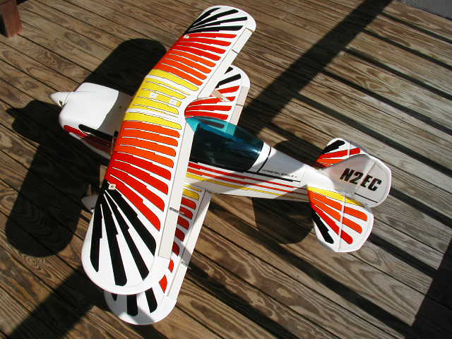

Anybody has any idea what ARF Christen Eagle this one is ? At least I think it is an ARF.
I bought this one here on RCU, but the seller doesn't know exactly what ARF/Kit version this one is. I would like to get a manual for it before the bird gets here so I know what throws it needs on elevator, ailerons, and rudder as well as CG is. If anybody knows this bird and the info needed, please help out.
Oh yeah, it is supposed to have a 50" wingspan.

Looks like the older EZ arf. My dad had one many years ago and it looks identical to the one in your pic, so Im guessing thats what it is. Hope this helps some!

Pretty sure that's the old E Z arf, my buddy has one hanging in his shop.

It looks like the old EZ ARF. If not the EZ then there was a company called Lion Models that made copies of the EZ ARF planes. I had several myself. They were almost identical to the EZ ones but significantly cheaper in price. Indy R/C used to sell them. I haven't seen Lion ARF's around for over 10 years now.
If you can get the manual from an EZ Eagle then you'll be OK as far as control throws go. As a ball park figure I'd go with Max throw on the rudder, about 3/8" up/down on the ailerons and 1" to 1 1/14" up/down on the elevator. Set your dual rates to about 75% of these values just in case it's too twitchy. The CG should be about at the mid point of the top wong's center chord. This will give you a nose heavy condition to start with then you can move it back from there.
Just make sure you build up enough speed on take off. These little, short coupled bipes don't like to be horsed off the ground. You're asking for a snap roll for sure. Go easy on the elevator until you get the feel for it.

I believe this is an Indy-RC as their's came with a tinted canopy and the EZ that was distributed by Global from Fountain Valley,Ca.
did not have a tinted canopy.......My $.02 worth

This is the Lion model for sure. EZ made a small .15 to .25 size,
a .40 size WS around 42 inches and a large 1/3 scale arf. Not to
worry you, but I have heard alot of horror stories about the Lion
kit. Make sure you start with a nose heavy condition when finding
the CG as stated above.

This is my old airplane. Yes...it is a Lion (INDY) ARF. It is the same size as the PILOT/OK model Eagle. I don't know if the throws would be the same or not. The C.G. should be marked on the side of the fuse with a C.G. decal.

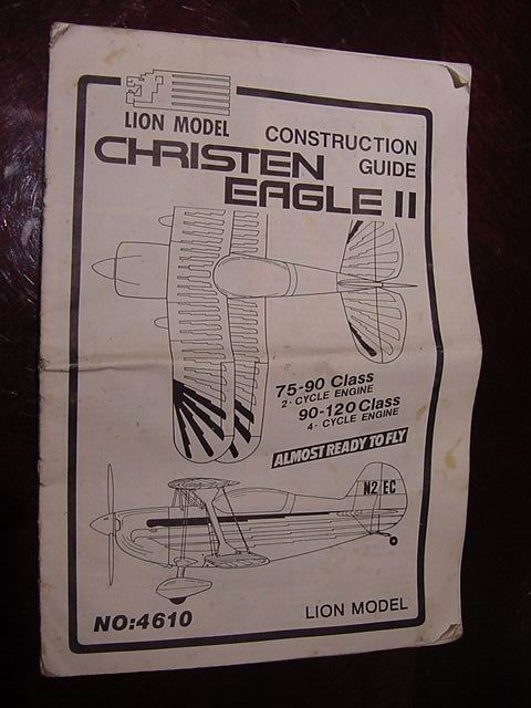

Hi Texas 3D,
I did not catch your thread earlier.
I am 100% sure that it is the Lion Model Christen Eagle (made in Taiwan) and sold by Indy in U.S. If it has huge hardwood engine mounting beams and a very thick (read "heavy") plastic cowl then that's the one.
I built the last one out of the factory in Taiwan 5 years ago but sold it due to entering military service. I never got to fly it.
I still have the manual for it. I missed it so much I kept it thinking
I could get another one. Here's directly from the manual -
Engine - 0 degree thrust

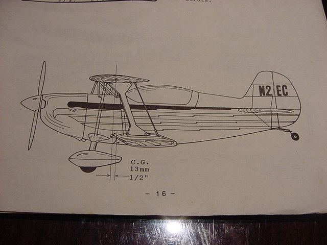

C.G. - "The model balances 13mm (1/2") from leading edge of lower wing less fuel". The picure shows

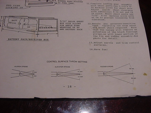

Control surface settings -
Ailerons - 5mm each way
Elevator - 14mm each way
Rudder - 35mm each way
On the last page there's a note of caution "The elevator must not more more than 5~6mm each way, as more than this will cause stalls and snap rolls." I don't know why the difference. Maybe put 6mm as low rate and 14mm as high rate?
I had a 91-4C on mine. As I remember, it was a beautiful, but heavy plane! And I actually know the guy from Lion who "designed" this plane off the smaller EZ model. He also mentioned to me about wing-loading issues, especially on a fat and short-coupled bip-plane!
Good luck with flying - please let us know how it flys!
Matt

The C.G. from the manual... Looks like 1/2" AHEAD of lower wing.

Here are the recommended throws. But the last page suggest in print to keep elevator throw at 5~6mm.

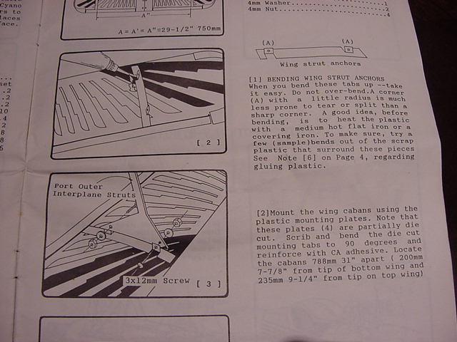

I can probably take high quality photos of the manual and email to you . Since you are past the assembly stage, you'll probably need just the last pages on trimming and setting up the plane.
There are many warning notes about stalling/slower acceleration/keep airspeed up etc. due to higher wing-loading and larger frontal area. I would take that advice!
Another word of caution - I remember the interplane struts on the sides are attached to plastic support strips on the wings. The plastic support strips glue to the surface of the foam covering material using CA, and the plastic is cut/bent upwards to make attachment points for the structs. This method/material is not reliable at all. I used tape to reinforce the plastic support strip (taped it around the entire wing) for better attachment. You might want to check that area.
Email me if you need the manual!
