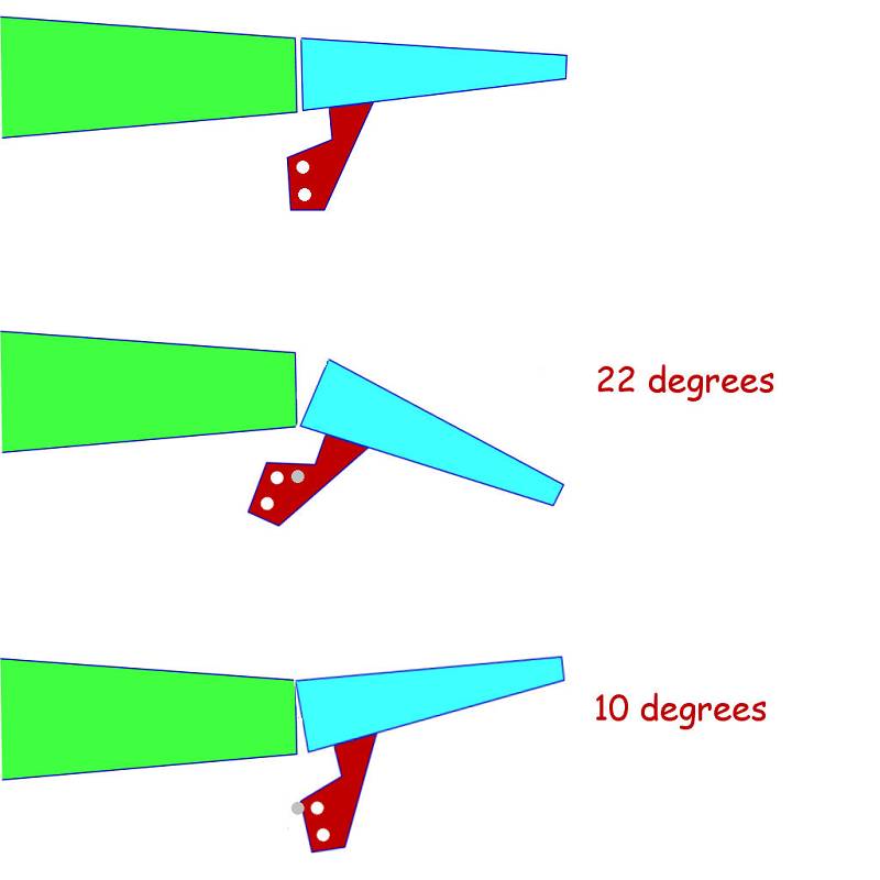

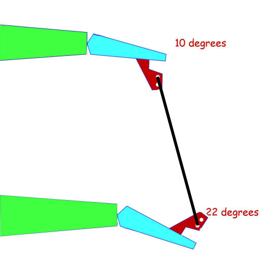

It's an amazing little thing.
There was a long thread about it's aileron rigging. It's worth your doing a search on these forums for it.
The rigging provided in the ARF winds up deflecting the ailerons at different rates, so they don't move equally. There is an easy fix. It's all in the earlier thread.

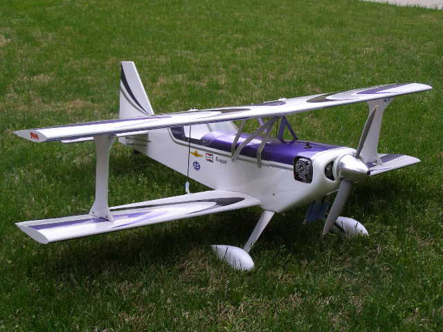

I had one for a while. It's a pretty nice plane for the such a low price. With a .46-AX it was plenty fast. The only real weak spot I found on mine was the wing bolt plate. It would come loose even with only slight contact between the wingtip and the ground. Of course the best way to avoid that is to not put the wing on the runway in the first place. As with all of the lower cost ARF's, look it over good and beef it up where necessary.

Basically all you need to do is look at DaRock's pictures above.
I've done the above on one 40S, and left the default setup on, on another.
There really wasn't a lot of difference in the handling of the plane. I'd imagine that it would be much more effective on a larger plane...
I did as per DaRock's suggestion on my 1.20 sized Ultimate.
The Hitec Mini is sufficient to drive all four aileron's w/o problems. This plane doesn't need a huge amount of control surface movement.
"Binding" is the big bugaboo. You MUST make sure that your ailerons move easily to their extremes with very little force.
Make sure that you leave sufficient gap in the hinges to permit this. You don't want too much, and you don't want too little.
The width of one of the control rods should suffice.
