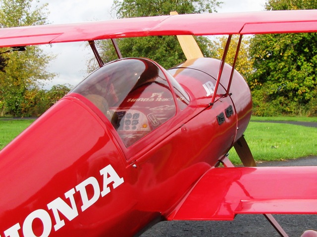

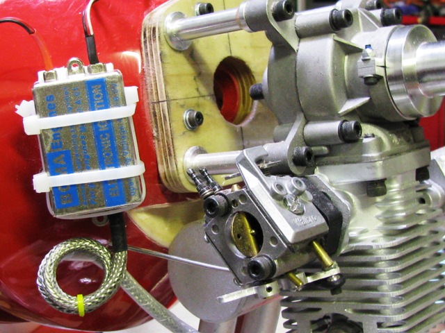

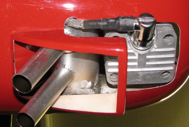

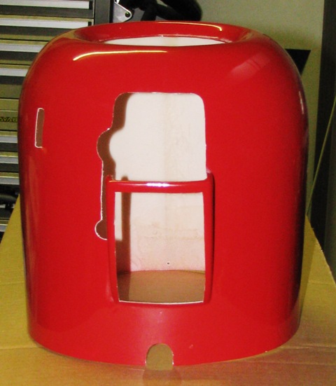

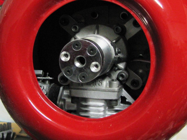

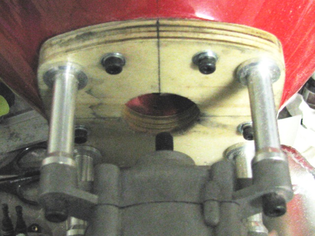

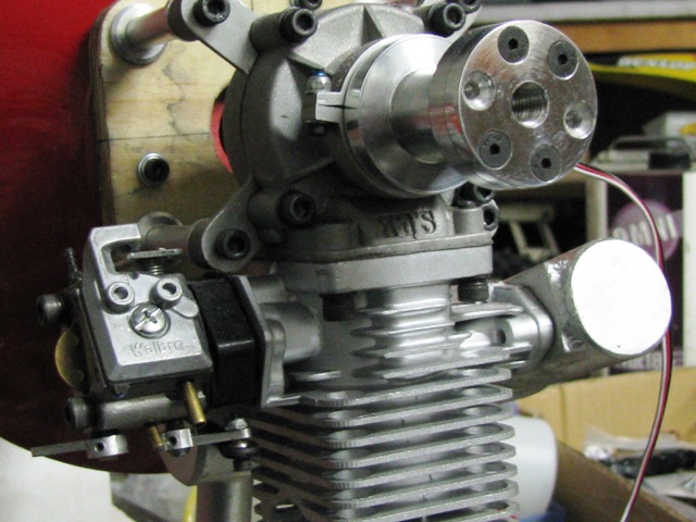

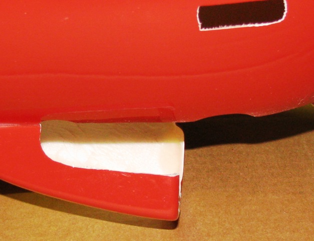

Here's some pics of the engine install. I had to notch the bottom front of the fuse for the pitts muff to clear. Also had to remove quite a bit off the side of the exhaust and re tig on some new alum, so it would clear the cowl. I switched the stock Zuma carb with the walbro 433.
The engine is mounted on the standoffs to the new firewall. The engine bolts/washers are counter sunk into the back of the new FW. That assembly is then mounted to the existing where the bolt connections/blind nuts have more bite. the new FW has been glassed and epoxied
On the Walbro carb, I had to trim the length of the choke shaft and installed a new arm. It just sticks barely sticks out the side of the cowl through a slot and works like an on-off switch. Forward/choke on Rear/choke off.

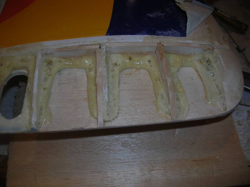

Nice Job There Prop.
I'm impressed that you were able to mig the muffler. With that huge monster cowl I can't believe you didn't have the clearance.
Engine looks good too. Can't wait to hear how it performs. I worked on my Pitts tonight. Rebuilt the bottom and top wing tips. Letting them Gorilla glue up right now. I'll do the cabanes tomorrow.
I need to glass the engine mount area as that suffered damage too. I bought some 15m epoxy and some glass. I plan to thin out the epoxy with denatured alcohol. Is this the correct method that you use for glassing ?

Dan, When I epoxy/glass I normally like to use Z-poxy finishing resin or marine/automotive grade poly resin (it's cheap and spreads nice). Today I just spread some 15 min on the fire wall squeegeed thin layed on the glass cloth/ spread on some more and another layer of glass and then a thin top coat. I have never thinned the 5-15-or30 before if I want it thin I use the other mentioned. I have heard this works though just never tried it. Let me know how it sets up. I do warm it up with a heat gun prior to sqeezing out of the tubes. It helps it flow better.

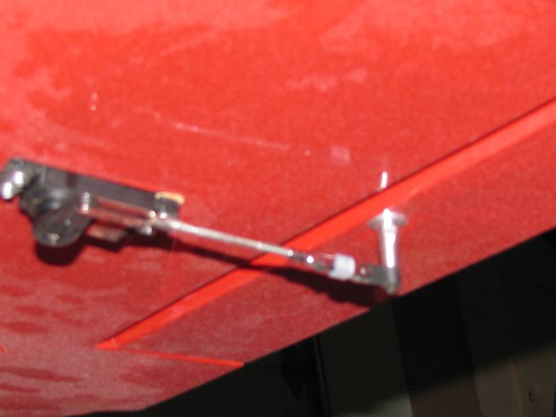

Can you post a pic of your servo connections on your ailerons ? I want to see what kind of horn/throw you are setting up.

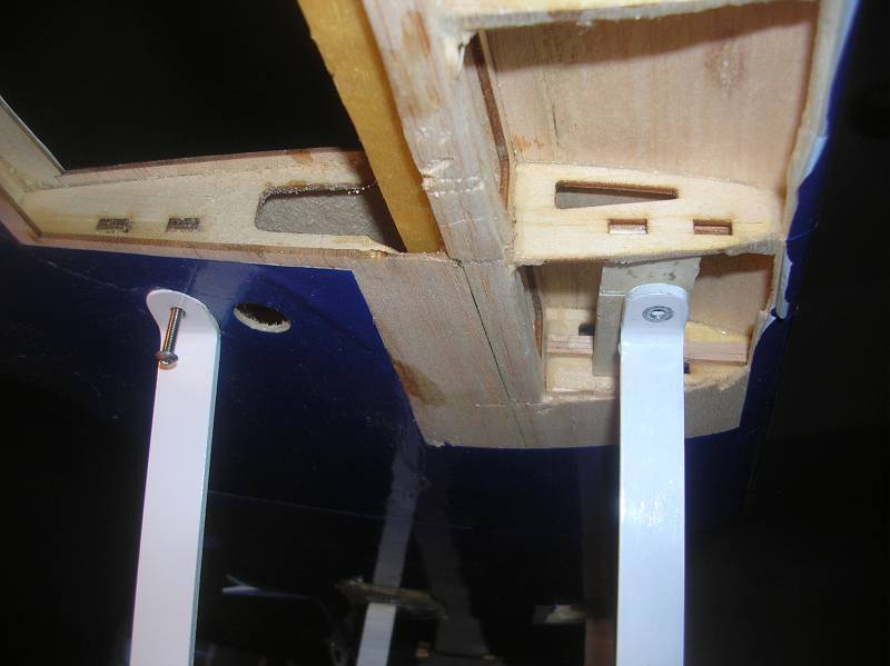

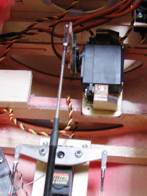

Here's a few pics of the fuse layout. I have the elevator servo arm traveling on a vertical plane to help eliminate or prevent any lateral movement in the elevator pushrod which would cause un-equal elev travel. It works good.

I like your engine installation. I have few questions:

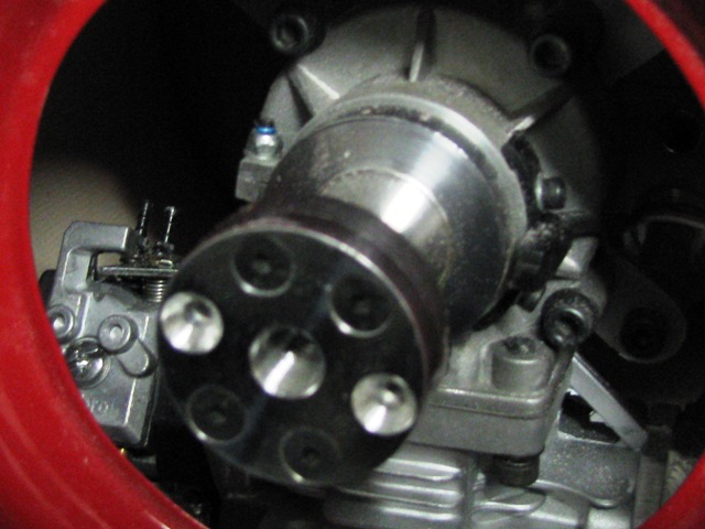

1. My engine timing is not installed on the engine. It is there with the engine but not installed. what is the exact location of installation?

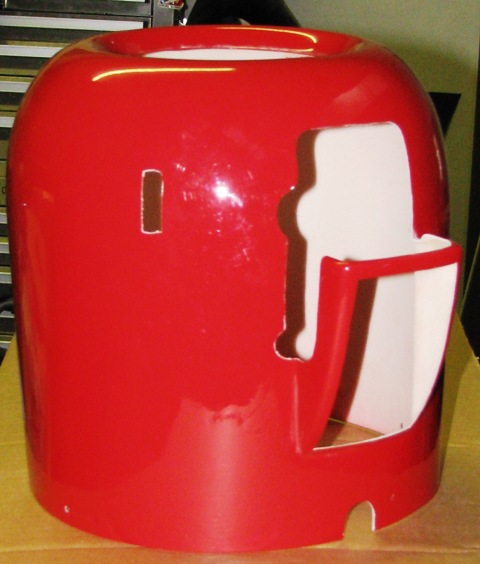

2. What prop size did you use?
3. How much cowl did you cut to fit the engine? Can you please post complete front view of cowl and underside of cowl and engine.

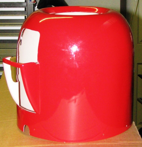

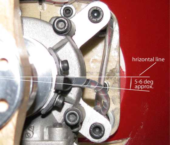

I have used one of your picture to explain what I want. Please check the pictrure, measure your installation and let me know.
thanks

Asif, I will get you the timing sensor location. As for the cowl, My engine is extended out an additional 1/2" from the original firwall than yours. On yours, if you leave it as is you would need less clearance at the front of the cowl. The pictures will give you an idea of what to do. It took about 20 on/off installs and trims to get it right. With your exhaust this may be much easier. I have mine set up so I do not have to disconect the plug cap for cowl removal. Also mine came with some cool little throttle/choke arms that worked out really nice.
On the timing sensor It is hard for me to give exact demensions but it appears to be as follows:
1. Install the sensor ring onto the crank output housing at a horizontal possition.
2. Rotate counter clockwise (viewed from the front) approx 5-6 deg.
3. adjust the plastic sensor mount to center between the 2 mounting screws.
4. Mine did not come with any instructions so I have no technical data.

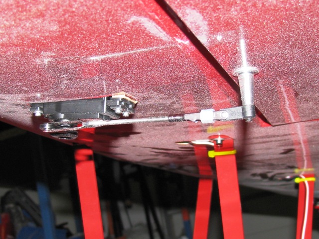

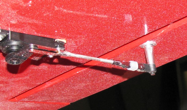

Dan, I used the du-bro self align control horns for the ailerons. they are set at about 1-1/8" above the surface to the pivot hole I also shorten the length of the horn arm and drill new holes so the mount is closer to the hinge line on this smaller model.
Here's some pics:
BTW I dont plan on flying the TF Prop in the pics. It's all I had and would not recommend it. However, it did hold up during some engine run in yesturday. It is a Power point 20x8

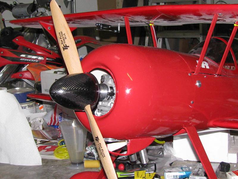

I love the Carbon Fiber Spinner. What brand/size is it? It looks awesome on the pitts.

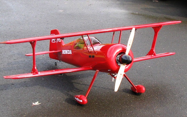

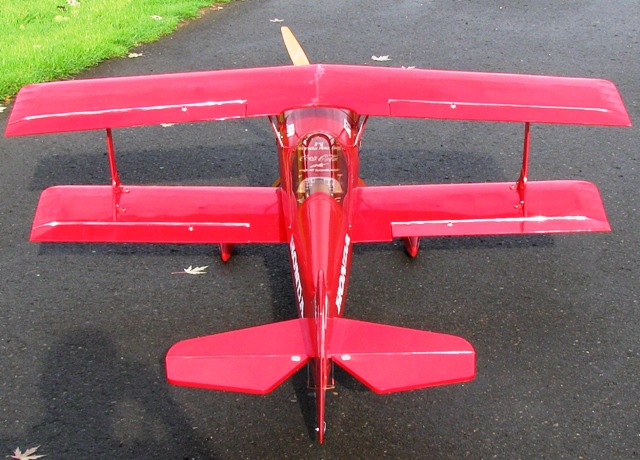

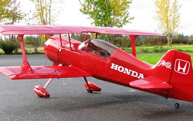

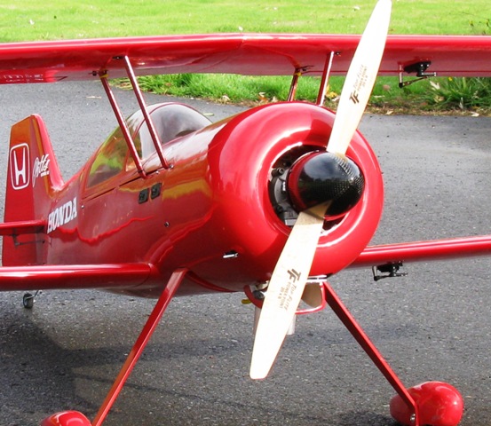

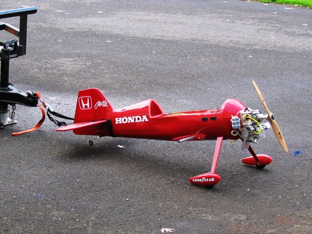

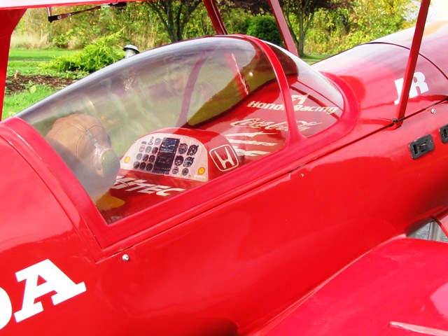

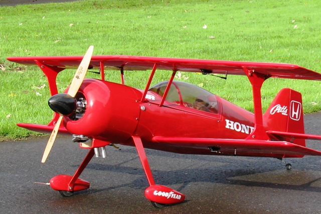

Well The Pitts is ready to fly... It comes in at a whopping 16.5 lbs. Not quite What I estimated but I guess thats what it's gonna be. I was hopeing to be at 15.5 max. Did some more engine break-in this morning and it started right up and ran just fine. The RPM's max's out at 6400+- with the prop thats on it. I assume there is a bit more to gain if I lean out the top end a little and go with a 18x10 but I think it will perform best with a 20x8. My idle is right around 15-1600. I'd like to see it a bit lower as well but for now it will work. On grass it's fine but on asphalt I like the plane to not roll at idle.
With this engine, it is almost impossible to tune with the cowl on. I will have to fab some pretty long extensions for the adj. screws to be accessable. The carb is mounted on a 45 deg lean towards the back on the right side as installed. The extensions will have to extend up and back towards the top rear of the cowl approx 5-6 in. to be accessable. I will probably make this mod prior to maiden at the field.
Nothing worse than not being able to readily tune the engine as needed.
Few Pics:

I think that came out awesome. The black Carbon G Spinner really sets it off. I can't believe it comes in at about 16 lbs.

Did you make those pull/pull and rudder extensions for the servos or buy?
From the pics , it looks like you can take off from your driveway.

Dan, I fabbed the servo arm for the pull-pull out of a piece of alum. It is mounted to a trimmed large plastic servo wheel. The control horn at the rudder is made from phenolic material I had left over from my comp arf yak. I could take off from my drive way and or the side of my house. I fly allot of my planes right here but the landings can be tricky.

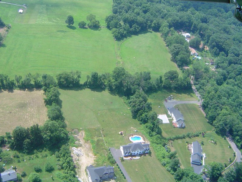

Flying out your back yard is pretty cool. Here's a pic of one of the flying fields I fly at. It's about a mile awale from my house.. so it's not to bad a drive. The other field I fly at is about 35 mins away.. A hassle but a bigger field.

Oh ya.. Ther'es a pic of my mew pt-19 I picked up last week. Saito FA-100 black night in it. It looks like a nice relaxing flyer.. 80+ " wingspan.
I also bought a H9 Edge 25% yesterday to replace my Wild Hare. It's all complete w/ servos. All I need to do is pop in the zdz40. I'll save the Wild Hare as my winter project repair.
later,
Dan

Ya.. some gorrilla glue never hurts in the cracks. Send some pics of the new planes.

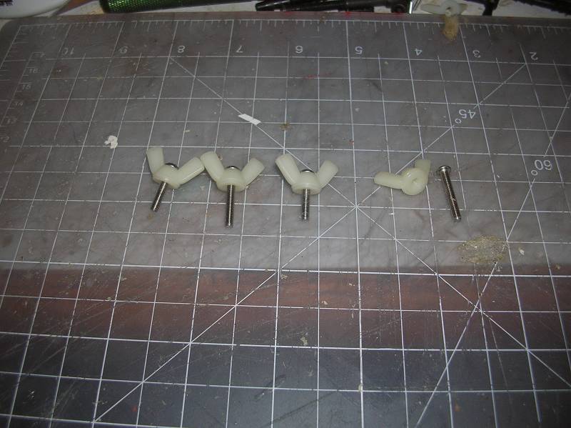

Here is a neat idea for those tiny wing screws that you need to put together at the field.
Some more progress on the Pitts

Cool wing screws. Where did you get the Nylon wing nuts?
