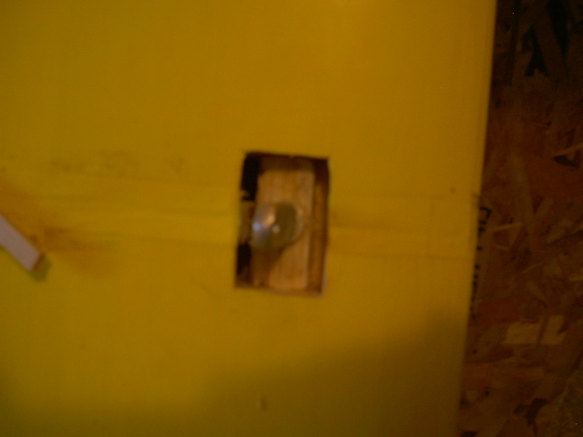

Was recently given this plane, it has been sort of put together but obviously by someone with little experience, the manual is very sketchy in the area of the top wing mounting to the Fuse, the picture shows (poorly) that there has been a piece of balsa put under the aluminium joiner , is that correct?. i have no info on this in the manual, it would seem that it lifts the top wing high so the cabane struts are pulling the wing tips down, gut feeling is it shouldn't be there but i don't know so am asking.

I just looked through the manual of my Sundancer, and I cannot remember my wing looking like that. Almost looks like the wood was stripped out by over tightening the screw. Looks like that is how the guy tried to fix it. On my Sundancer the wing was solid in that area, with a hole drilled where you were to screw in that bolt. Yours looks like the sheeting has been cut away. According to the manual, the top wing incedence should be 0 degrees, and my wing tips are not pulled down at the tips. Hope this helps.

perpetual: I just sold my Sundancer and I gave the manual away with it, but I don't think the balsa should be there. You can probably call Sig and ask.

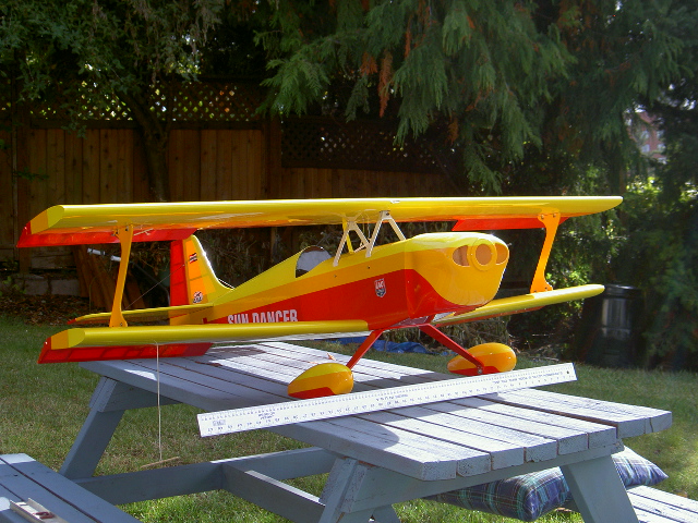

My apologies guys, i forgot there are more than one Sun Dancer
Yes Jim it is a 72" Sun Dancer, I think the person who put it together did it more to sit it on a shelf than fly,
the top wing was bent down slightly at each tip, but thankfully not epoxied well, so i was able to reglue it and straighten it,
the bottom wing i think is fairly well put together, but will check the incidence on it when i get my meter. and see if it will open up at the centre and allow the intro of more epoxy. the manual i have (courtesy SIG) gives no indication of the correct amount of dihedral on the lower wing, it is a push fit with dihedral braces. so should be fairly idiot proof.

ORIGINAL: rcluver
. it was a free gift and the person who started putting it together was a bit sloppy, never mind we will sort it and i am sure it will become a favourite flyer. PR

Thanks for the rundown, SIG have been really great with help. they emailed me a copy of the Manual, gave me a breakdown of all the parts i was missing with prices. absolutely fantastic customer service.
Mind you I have owned and built six of their planes, so maybe they owe me,
I have now ground those pieces of balsa out and the wing sits almost flat on the struts will do some final tweaking when i get my incidence meter, and i am going to see if i can add some epoxy to the wing joint on the lower wing and snug it together a bit tighter, it looks as if the right tip is about a 1/4 low.
