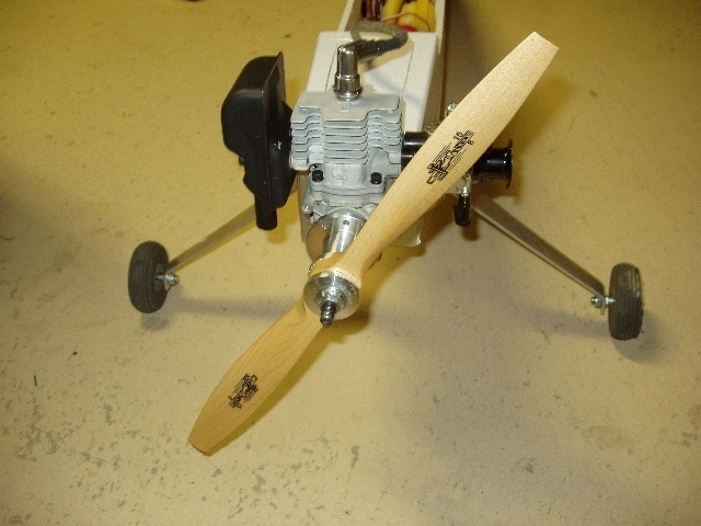

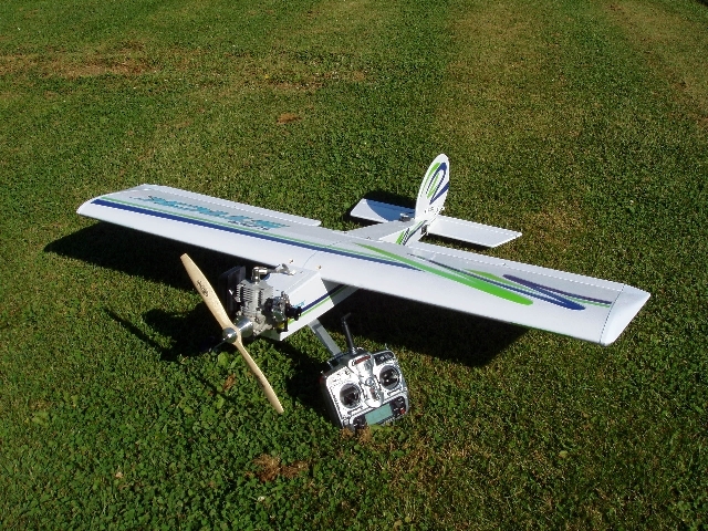

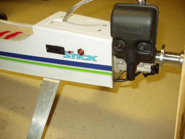

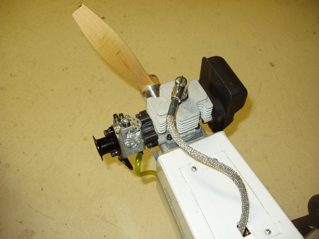

Just wanted to post pictures of my Dad’s H 9 Super Stick 60, the older style ARF. The Stick has the new Zenoah G20 ei gas motor. The only changes to the airframe were to add triangle stock to the rudder and stabilizer. The landing gear was made by Crashis Clay’s Custom Landing Gear from ABELLRC.com. Total weight is 8 lbs and has enough power to hover. My dad has been flying models since he was a kid and will be turning 83 years old this month and flies 4 times a week. He wanted an everyday gas plane that would handle wind and easy to setup. We came up with this combination and it has proved to be a great setup.
The G20 ei ran great out of the box and we have about 20 flights. The engine starts very easy. The ignition battery is a 1700 NiCAD and we have had no problem getting 4 flights in on a charge. The Radio is the Spektrum 2.4 GHZ and has not given us any problems. We are using the Opto-Remote Gas Engine Kill from 42-Percent-Productsto to isolate the ignition from the receiver.
