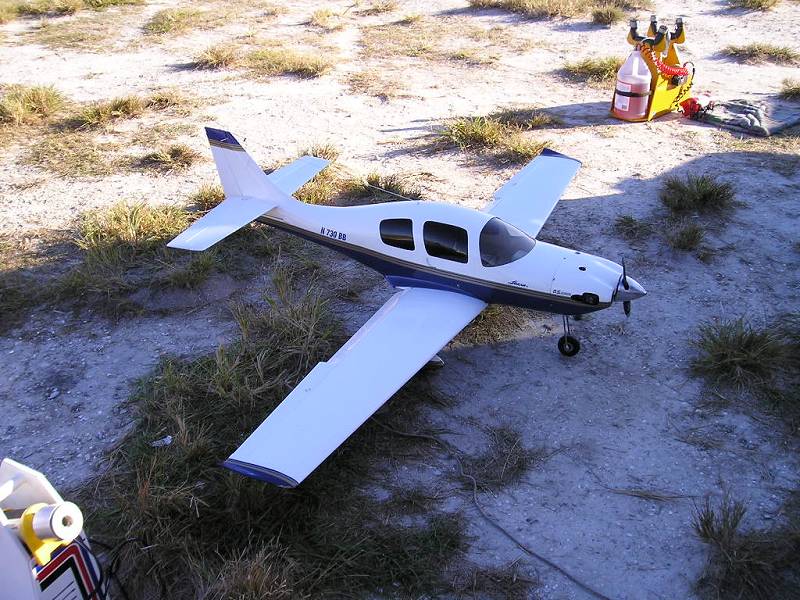

no you are correctly assembling these. the wood joiner and butt gluing is not enough. i have a saito 80 and fly at half power. its not e powered cause this engine start the first time all the time

Why can't I see the wing joiner spar in any off the pictures a good glue joint is 20 times stronger then the wood itself yet it appears to have pulled out not broken off
that could explain the failure
maybe I can't see enough in the pictures do you have one of the side looking into the wing

Rube, you could be very right. I received this model built, was sold very cheap
by the owner of the LHS that I worked for, ($100.00 for plane, flight electronics, and brand new
.61 FX w/ in-cowl muffler).
When I received it, the wing had already cleanly broke the bond
between the wing halves.If you stressed the two halves over your knee,
you could see the seam separating ever so slightly. This is when I decided to
glass the center section immediately before I ever fly it.
The wing was also joined with a polyurethane adhesive instead of epoxy. Either
it did not seem like a good glue or it wasn't applied right. Not to mention,
it had a not-so-clear incident history, but did have scuffs on the tips
from a grass field!
Anyway after seeing this guy throw his all over the place yesterday, I am
ever so compelled to just buy another one and of course, assemble it
myself. He has an OS FS.91 in this one and it flew relatively
tight loops and patterns quite well. It also had a locally built "fults" type
nosewheel which improved his ground tracking immensely.
I miss it dearly![&o][

Having examined the inside of my Lancair wing thanks to a fence leaping up at it, I can assure you the spar material is "marginal" for this span/weight (25 years flying thermal sailplanes if you want to know...). I repaired it and still fly it regularly - love it - but certainly keep the G's to scale levels.
A metal plate mounted to bridge the 2 main UC mounts is a good idea though - stops landing forces trying to pry the wing join apart. Glassing the centre won't stop the spars snapping, just define the likely snap point!
- i.e. right where the glass stops.

Glassing a 1-piece wing's centre join reinforces just that - the centre join. It adds NOTHING to the unglassed wing beyond the bandage, so if the wing is inherently weak - as is possibly the case here - then it will still break outboard of the bandage/joiner.
If you are joining 2 structurally sound wing panels, then a bandage certainly adds strength to that join, as Deadbeat points out. Most of the failures reported on the Lancairs have been where the wing brace ends, therefore the basic structure is failing where it has no joiner to help take the loads.
I'm not discouraging glassed bandages on centre sections, just don't want people to expect this makes the WHOLE wing somehow stronger! Sure, there's all the other issues like poor gluing to add in, but at the end of the day don't think a glass bandage will ELIMINATE this wing's shortcomings - only a stronger spar construction will do that.
Cam

The wing broke outside the joiner, at the side of the fuselage. The joiner is still there but it is hidden behind the rib. The failure was the bottom main spar cap failing in tension at the end on the joiner.
I'd say camdyson is right. The spars are undersized.
Jim

No, like jrf said but just outside of the stbd. wing seat. The wing suffered trauma
during a near runway tip-stall during a fairly windy day. Should have went around.
she got picked up by a sudden gust, tried to maintain control and bring it down then...WHACK!
She tip stalled suddenly and when that wing hit it was obviously worse than it looked.
I felt I certainly got my 100.00$ worth. This plane taught me a lot about differences in flight characteristics
of scale and non-scale aircraft and I still have a recently crashed, but perfectly operational .61FX.
(that cowl saved the motor for sure) Not to mention all the Hitec gear on her (all but two servos survived)
